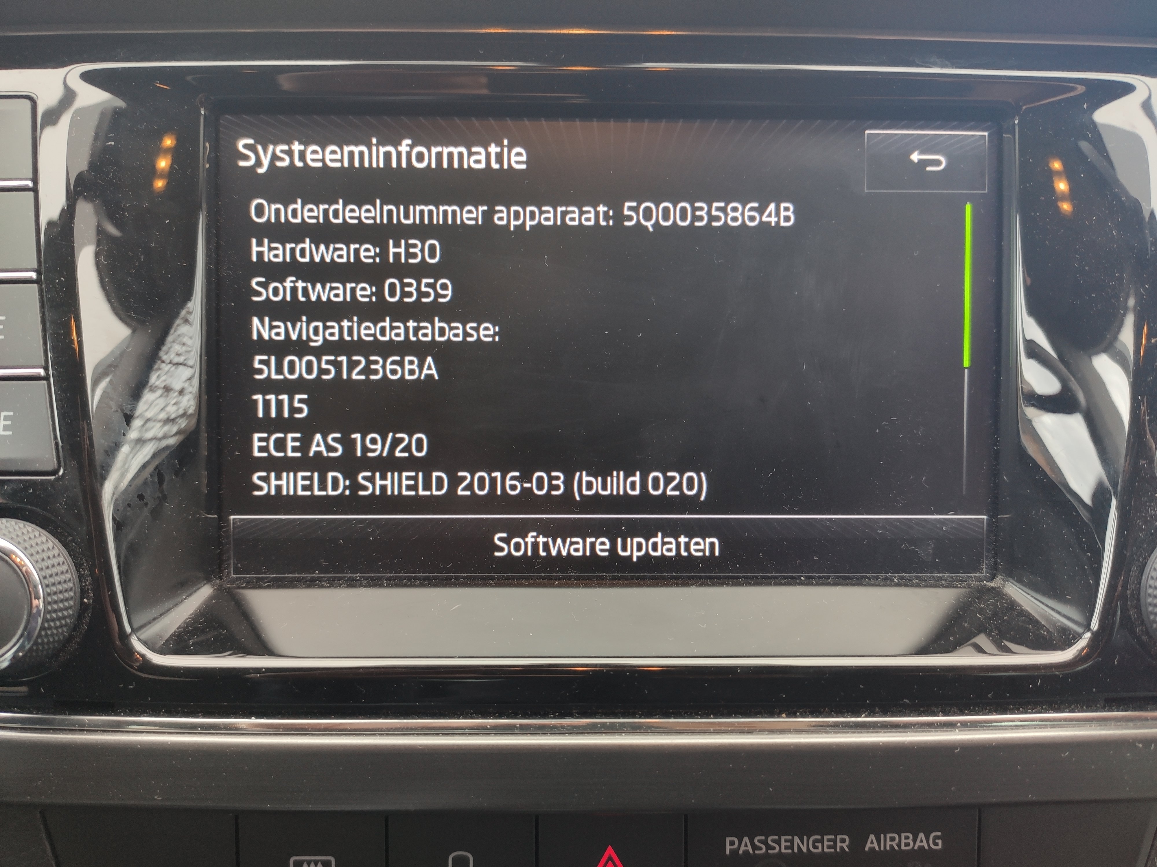

Just now, Spitfire60 said:

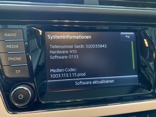

Oups,
REFERENCE :5Q0035819B
H30
0363
Medias code: 3141.0.0.1

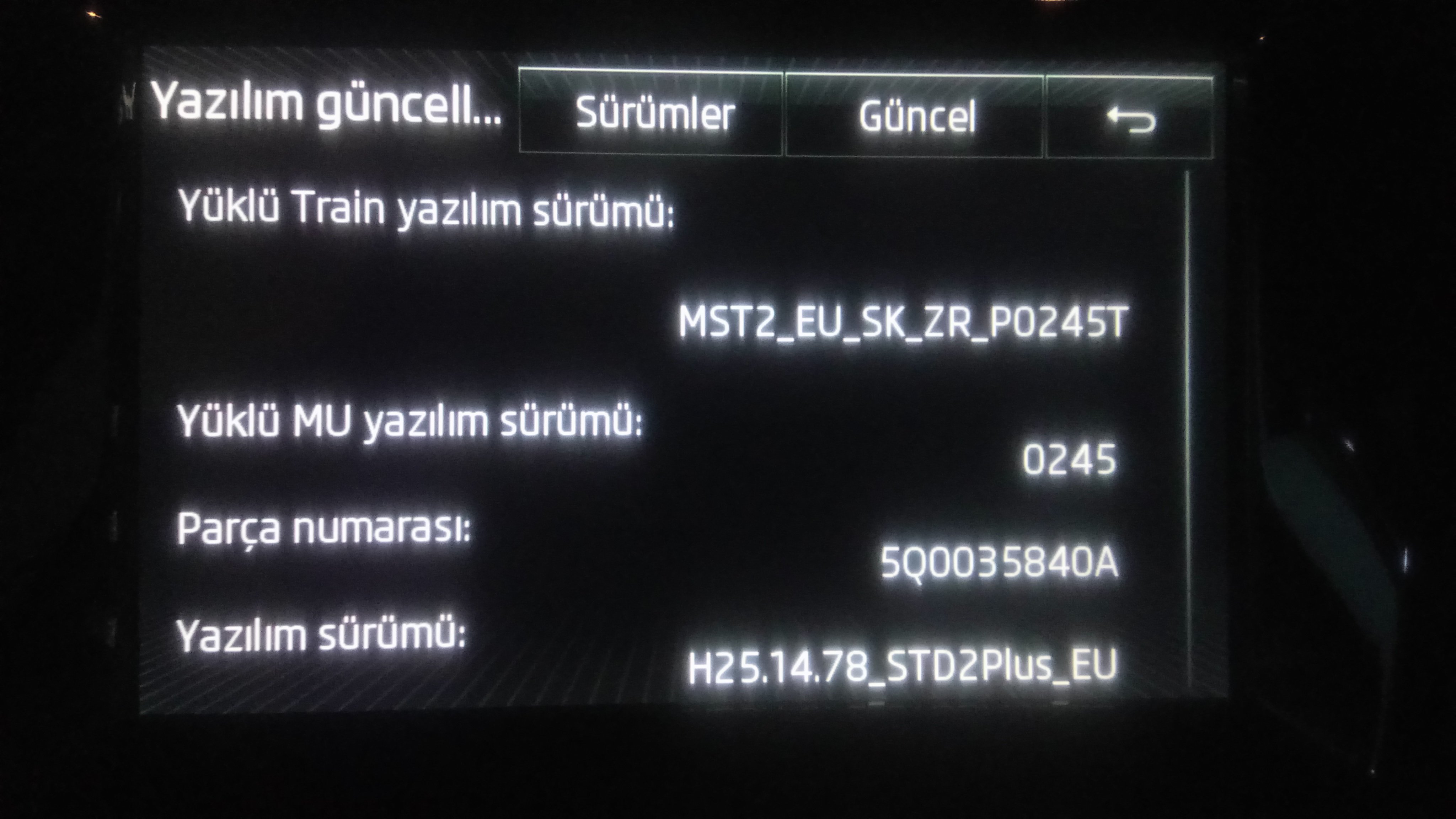

Please help me, i need firmware upgrade and i can't find any firmware file 🙏

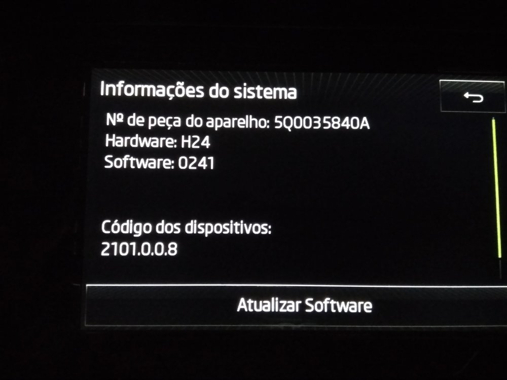

Hi guys.
Could you please send me an update for my unit?!
5Q0035840A
H24
0245
Thank you very much!
Cheers, stay safe!
@Panditoto @wouters @Joao_Pereira @BlackRam @DaDoDaDo check your PM
@chelon generic is OK but you must do it from teh Service Menu (long press MENU button). Firmware updates are NOT available via Skoda Update Portal.
@Spitfire60 unfortunately SmartLink cannot be activated for this version - you need to have it replaced. Pls PM me for details.

Ha ha ok I do have the fw dl on flash card but it wouldn't run, I'll try the long press. Skoda? Neither the dealers nor head office have a clue re this stuff as far as I can see. Why doesn't it appear on the portal?
As I wrote on February 27th:
1. Do you really need an update? Keep in mind there is ALWAYS a risk of bricking the unit (especially MIB1).
2. Format SD card or USB pendrive under FAT32.
3. Unzip software file to SD card or USB pendrive you prepared, Make sure it is unzipped to root folder - all the folders and metainfo file must be placed directly in the root.
4. Start update via service menu (long press MENU button).
