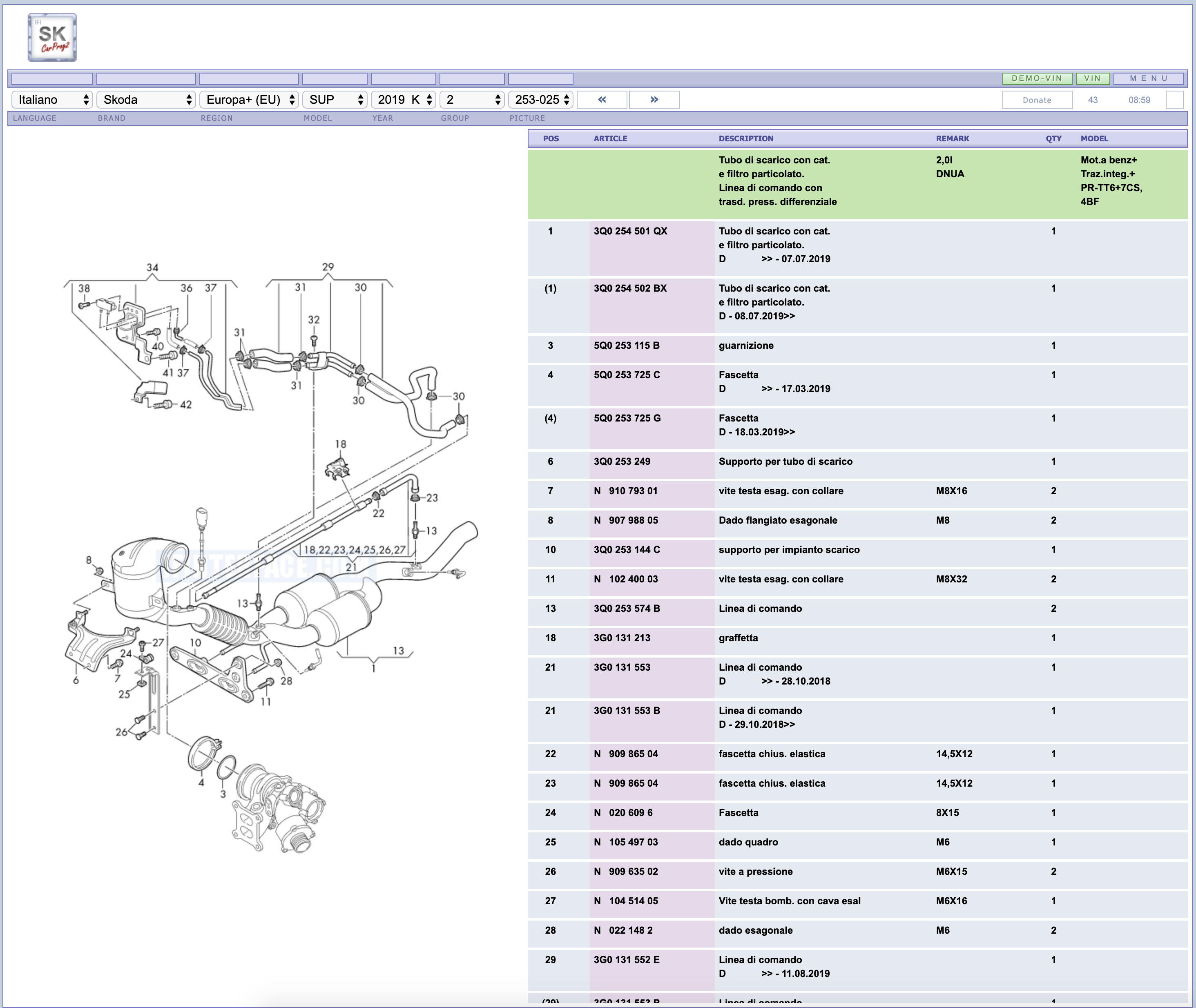

Thanks to @Bap33, i realized that Superb, S3 and Golf R with OPF have all the same downpipe (part n. 3Q0254501QX).
So, now i know that Milltek's SSXVW513 DP fits (or should fit) our car. And now i can start creating my wish list for stage II or maybe stage III...😃🙌
@noskodavan maybe this ETKA finder helps for your researches too
Well that confirms it I guess. I mean there was anyway no reason for the Superb's downpipe to be any different to its cousin models but now we know for sure.
