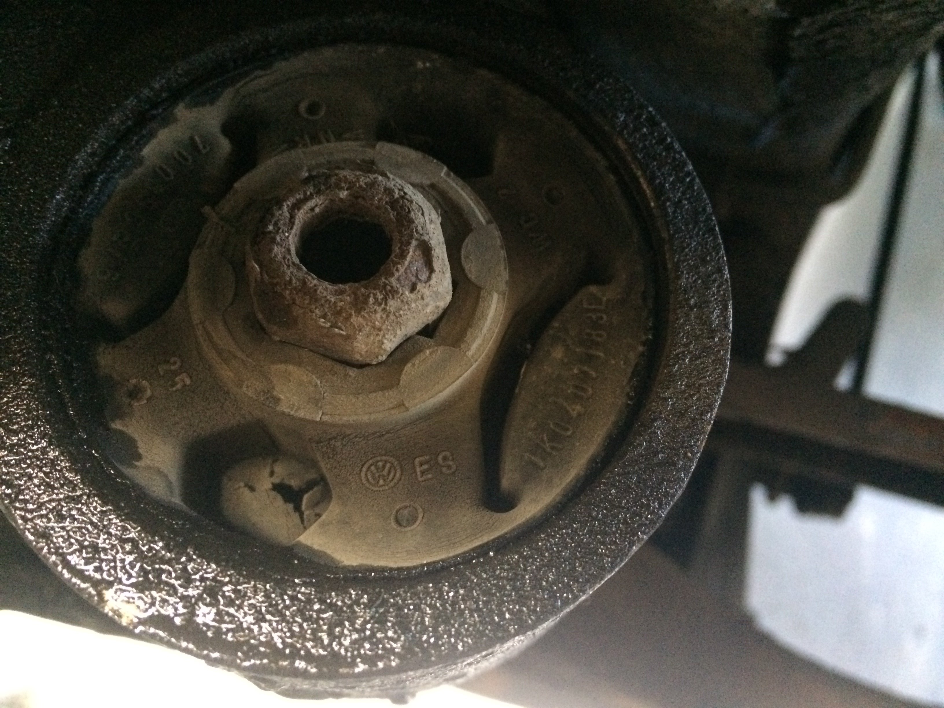

Clunk = front wishbone rear subframe console bush? Have a look at the tube like bit of metal, looks like a bolt, but it isn't, that goes through the console bush. If it is off centre in the bush then it is likely the console bush has gone and clunking.
If your wheels are straight you need to get your head behind front wheel and look at it from behind.
Compare both sides of car.
Should look like this....
Not very scientific, but when I changed from voided / have air spaces ones to solid ones the side that looked off centre was on its way out. There was a lot of elasticity and little rigidity in the bush.
If you have not replaced in last 30 to 50k miles it could be the culprit, particularly if you drive a heavy Vrs 1.9 tdi engine.

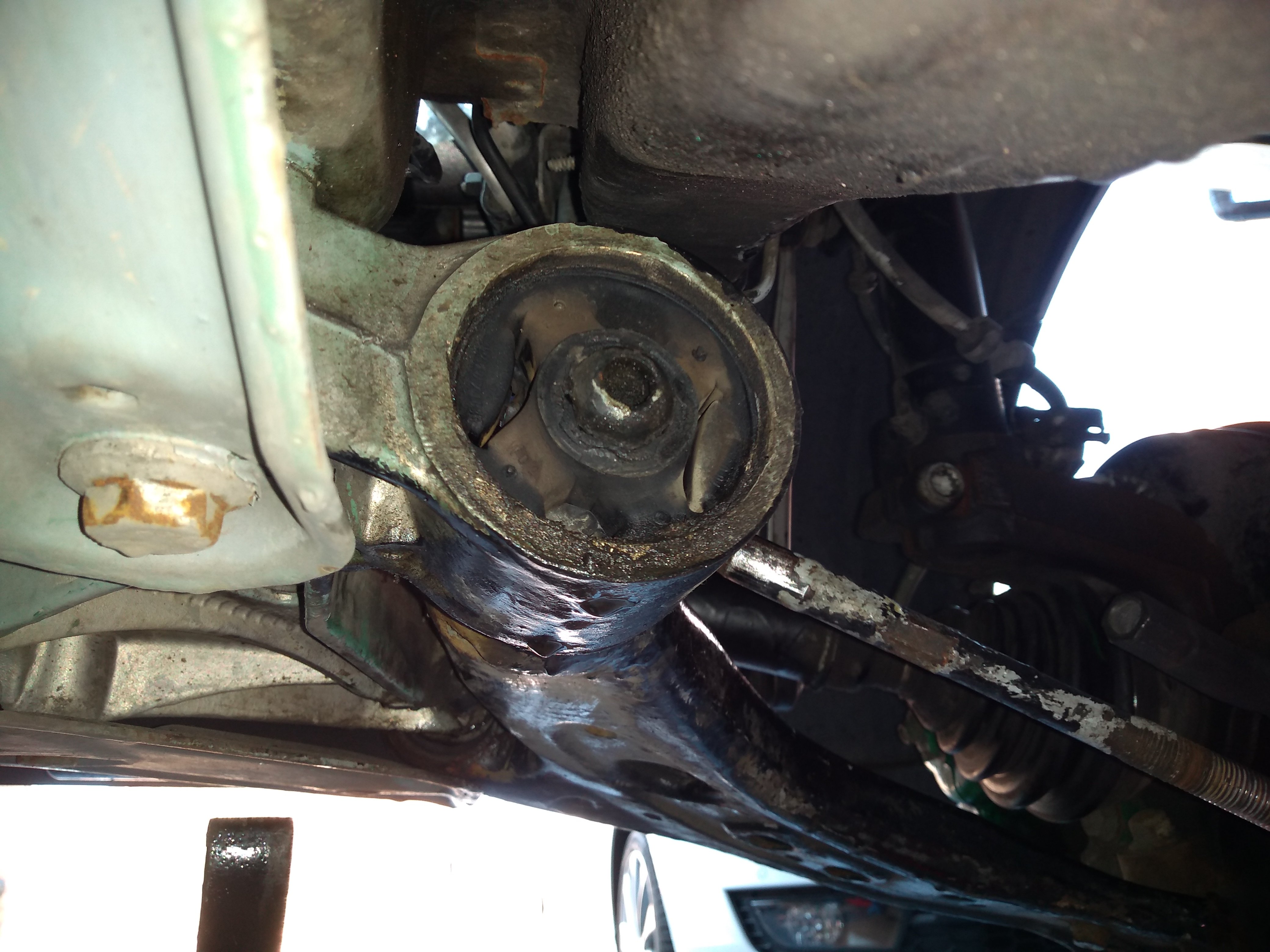

Not a very good photograph, but does this look suspect
No, it looks ok.
1 hour ago, sepulchrave said:
No, it looks ok.
Thanks and bugger... still have a random rattling noise that I have no idea where it’s coming from.
