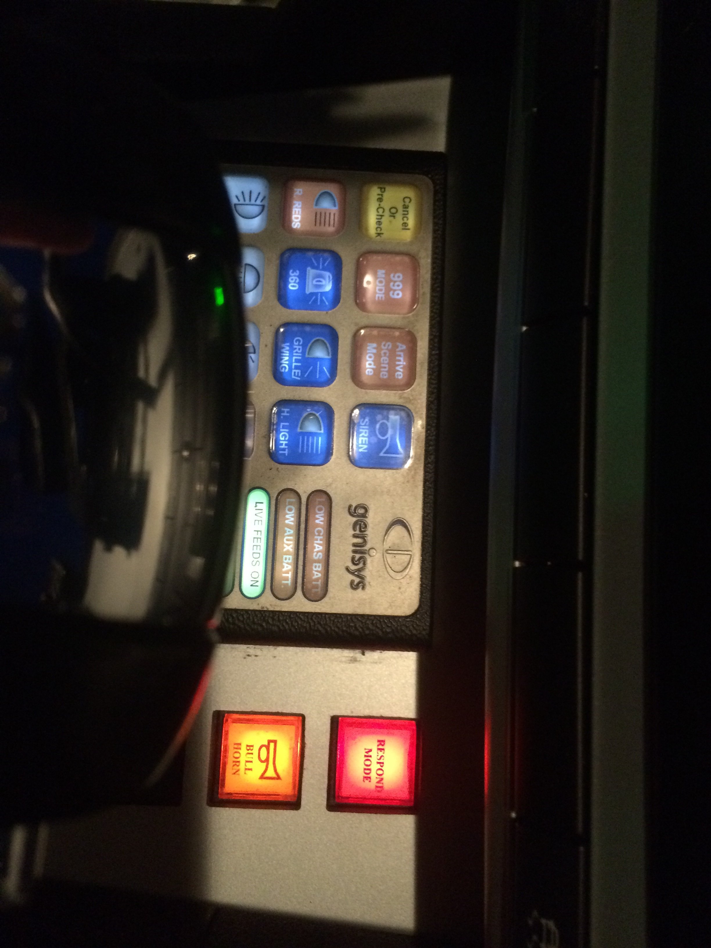

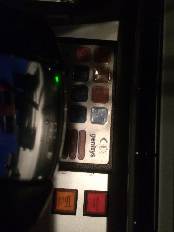

If it has been converted to an ambulance there is a chance it has "run lock" so the engine can remain running while the car is locked and the key removed ?
Thanks for your reply the dashboard is on constantly with car locked and a picture showing driver door opening and closing thought that must be the issue I will ask. About checking with an ammeter no idea how to use one  the car does still have run lock on arrive scene mode
hi Nige the car does have run lock system
It was converted by Ludo mcgurk and still has auxiliary batteries in the boot and a socket on back window to connect to the mains haven’t tried the Ammetre test will try tomorrow would the run lock cause excessive draw from battery wither everything switched off including auxiliary battery

The "run lock" will effectively power the whole cars systems so even with the dual batteries it will seriously deplete them overnight

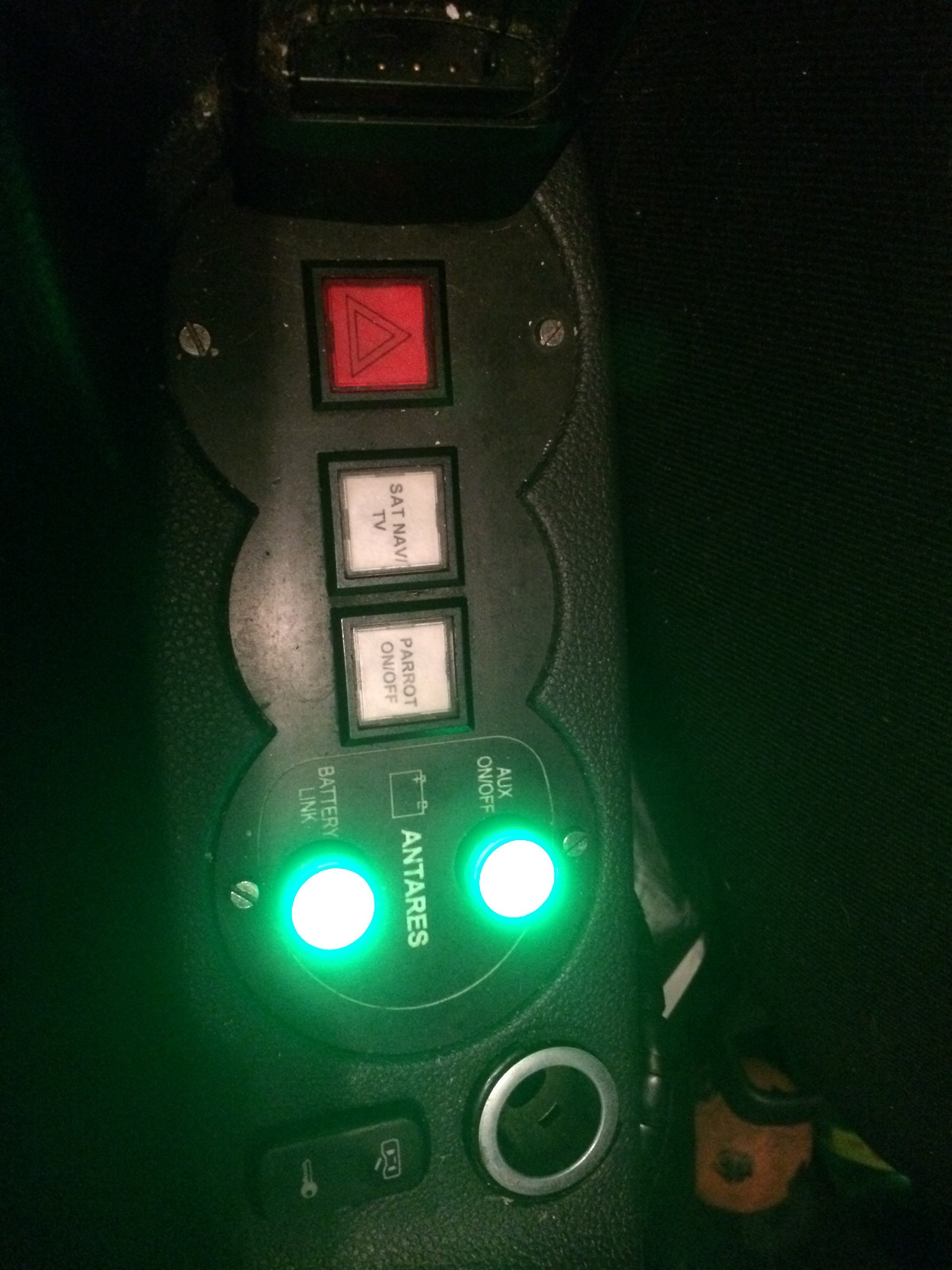

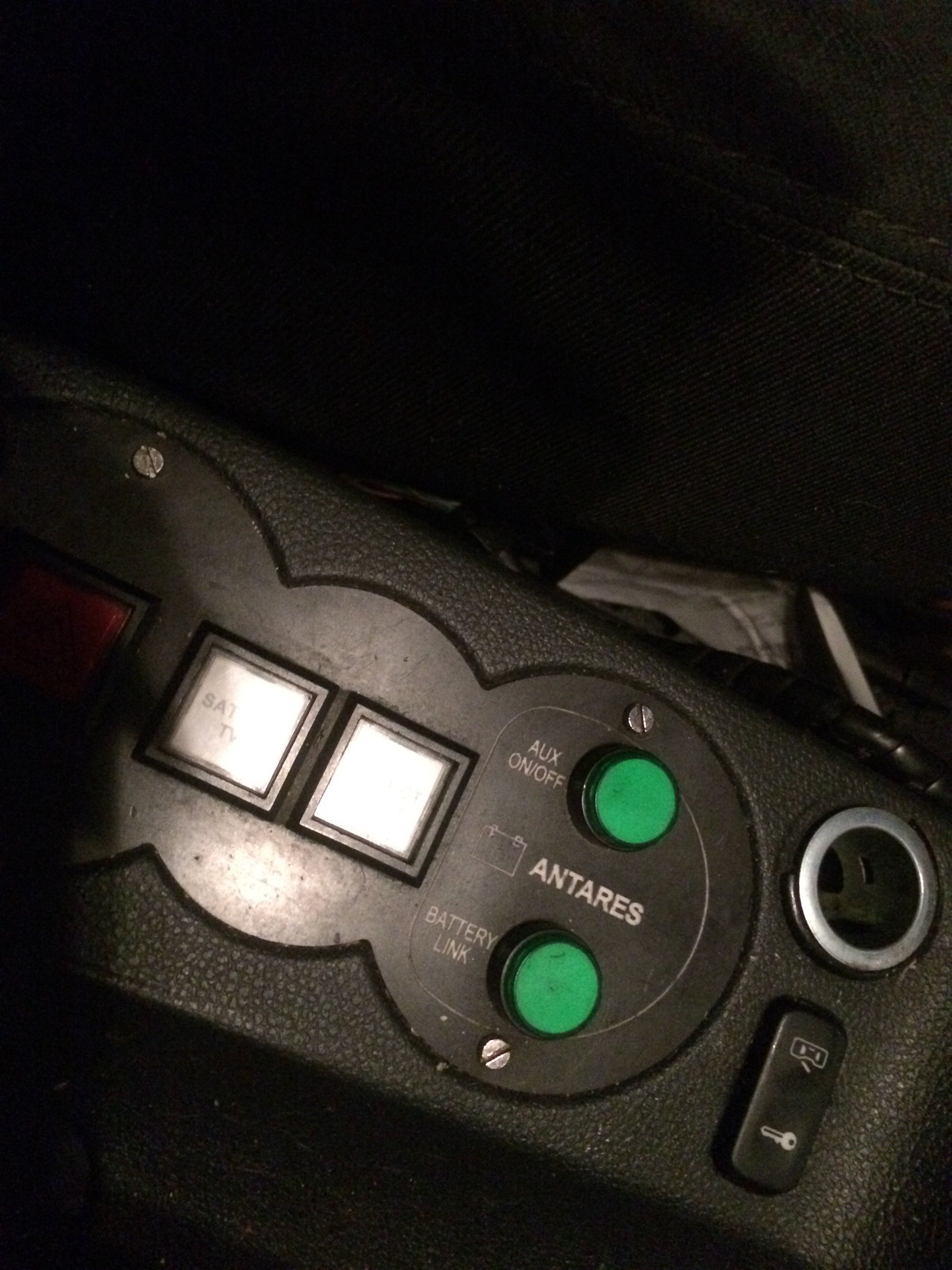

The control panel for the run lock is not illuminated only looks like it only work  with auxiliary battery’s which I turn off after switching off engine I do this so in the morning when chassis battery is flat have to access car with key no lights come on dash I’ll turn on the auxiliary batteries on an it will start off that if not been left for more than 1 day any more than that it needs to be jumped would adding a battery isolator switch solve my problem
Picture with auxiliary batteries off engine running
Pics with battery on
