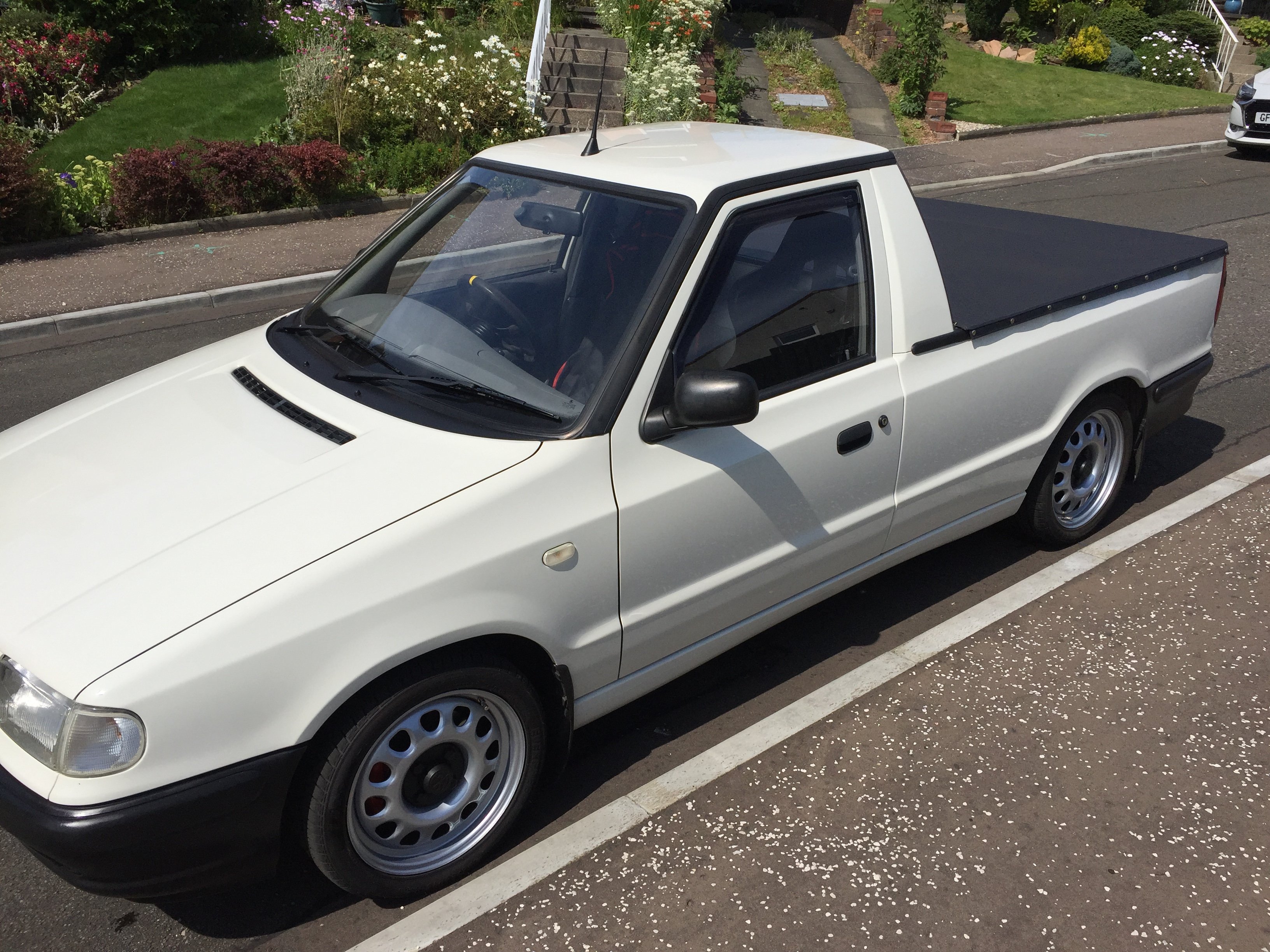

Not long got my 2000 Felicia pickup it has already had the front brakes converted to ford mondeo and they work well
but I was given rear brake callipers along with discs and pins to fit to the rear was told they were from a vr6 not sure exactly what
i have not tried to fit them yet don’t think it will be that much of a problem Barr the cables just don’t think the original ones will fit and not sure what to go for is this a common conversion that someone can point me in the right direction before I give it a go 😊👍 p.s I know it don’t really
