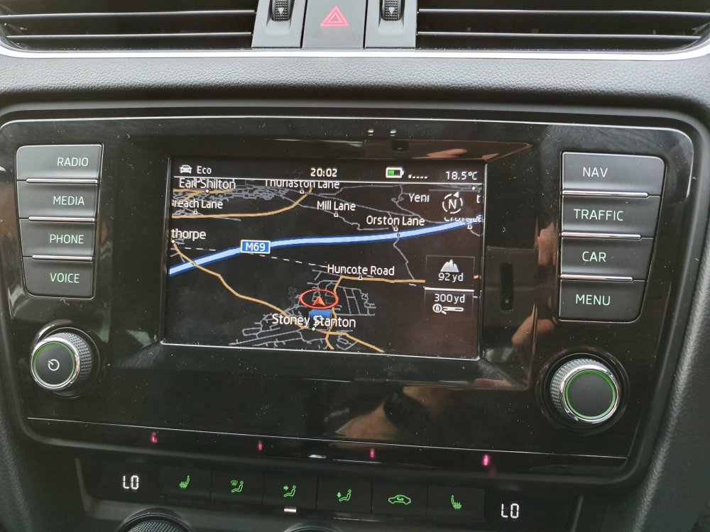

New to Octavia ownership,  but finally picked up a 2014 model Elegance with low mileage and a really high spec,  but would like a bigger screen, more up to date sat nav and maybe Android Auto.
Any advice or pointers on where to start or what's available would be great,

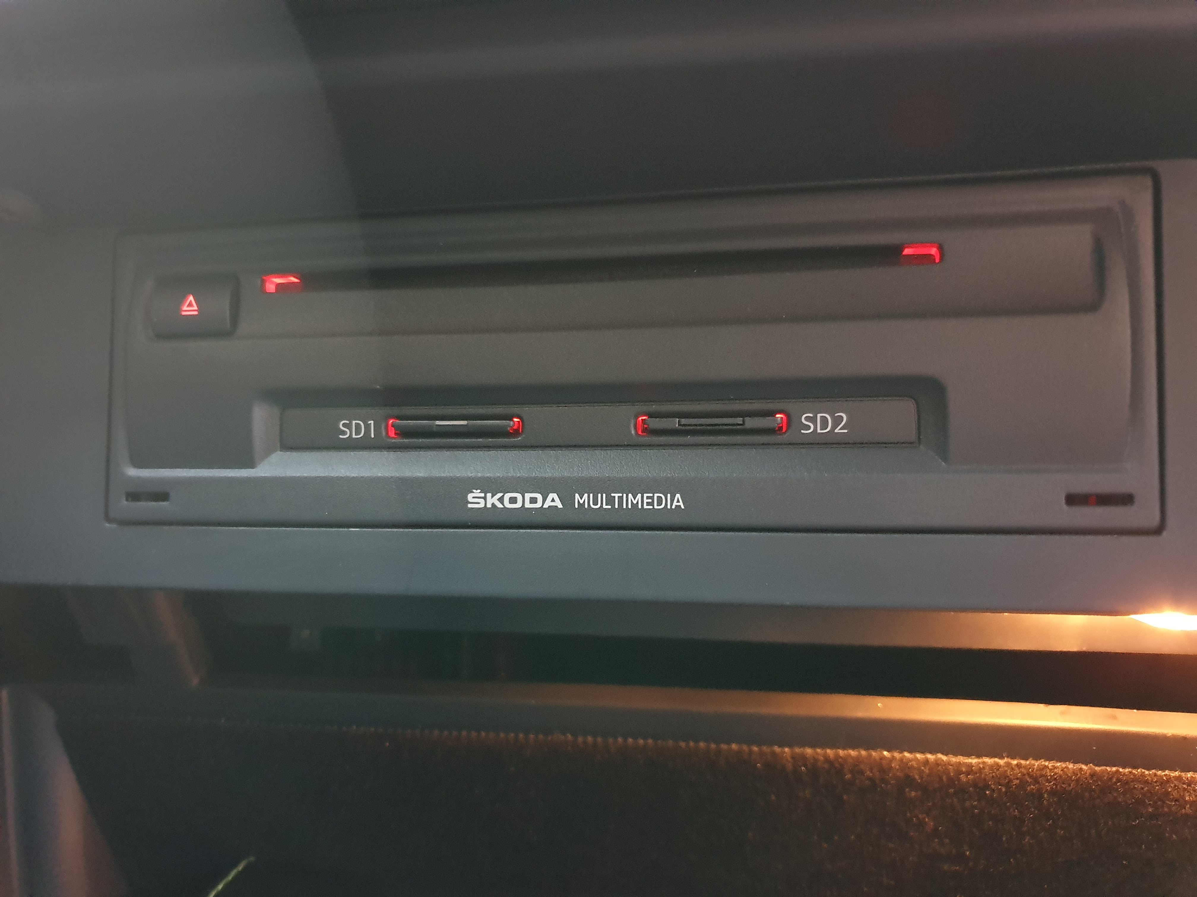

You have the same Infotainment system as me (I have a 2015 Elegance) which is a MIB1 Amundsen.
Sadly the larger OEM screens are not compatible with the MIB1 Amundsen due to them having a different resolution (you get two half size images).
Android Auto requires different hardware, not just a firmware upgrade.
So the only way to get a bigger screen and Android Auto is to completely update/replace the screen and the glovebox unit - SashaGrace is the person to get in touch with, look for her threads on here for details of part numbers and process (dealer to remove CP, expert to re-enable features).

Fitting a double din is nearly impossible, the radio is in the glovebox as is the wiring and there are no face plates or adaptors I'm aware of to aid the fitting. Also the radio is built into the can system of the car and controls so many more features than a normal standalone radio. If you want to do this, you need to do it right.
