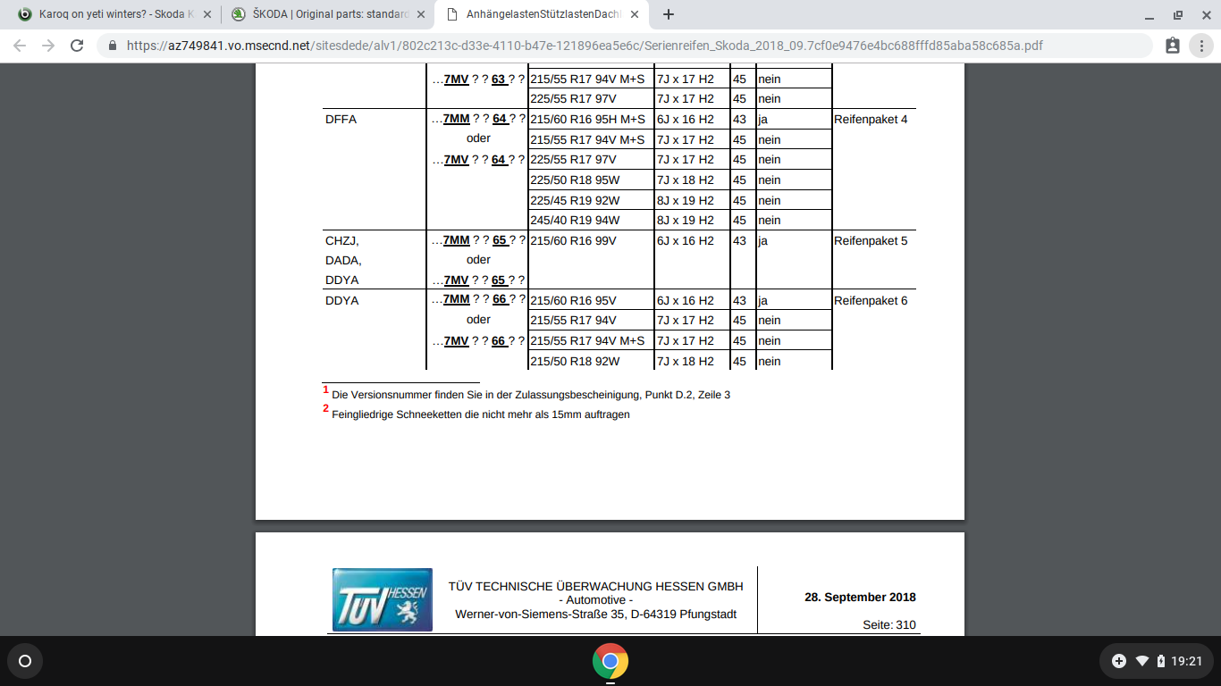

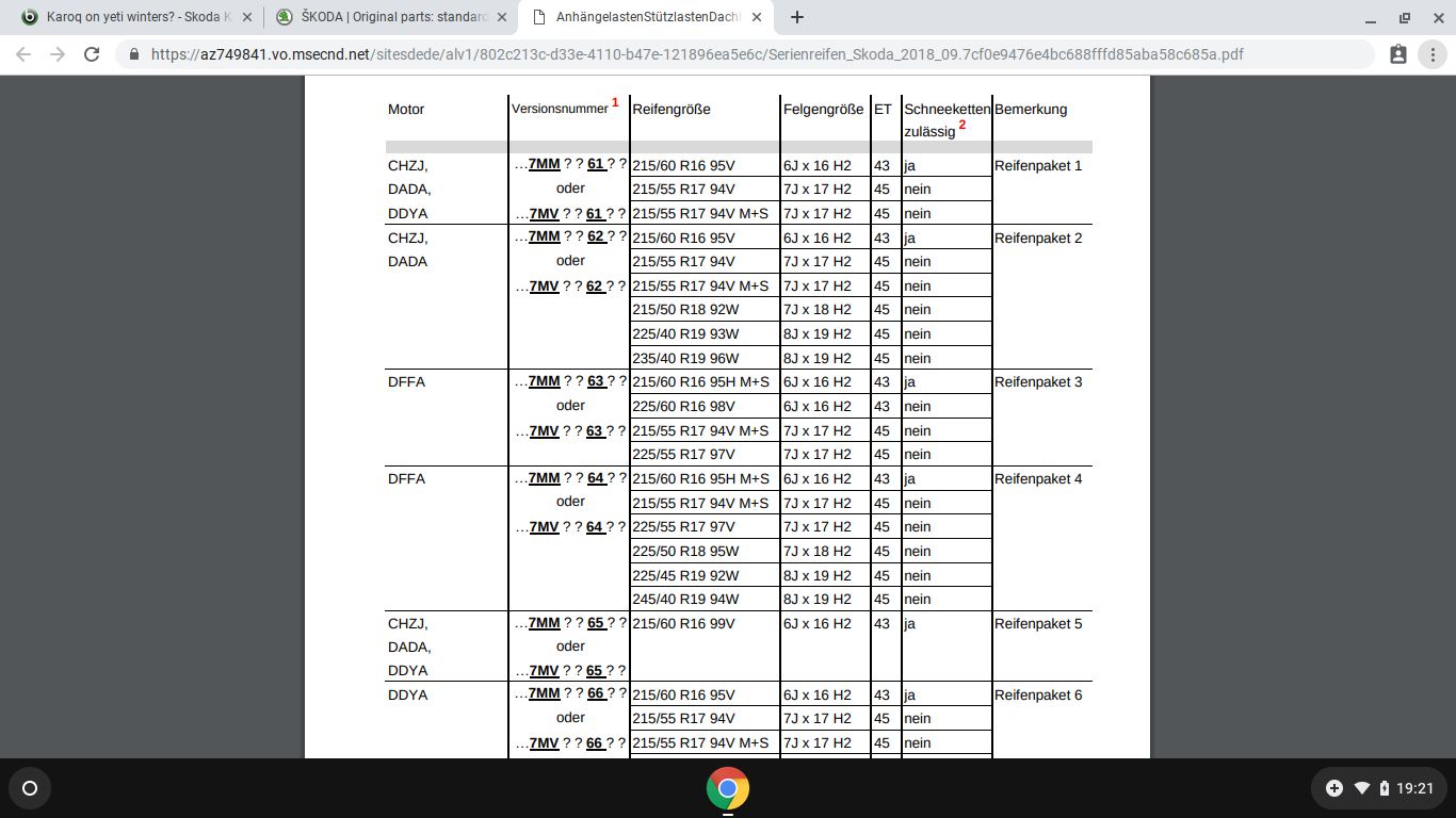

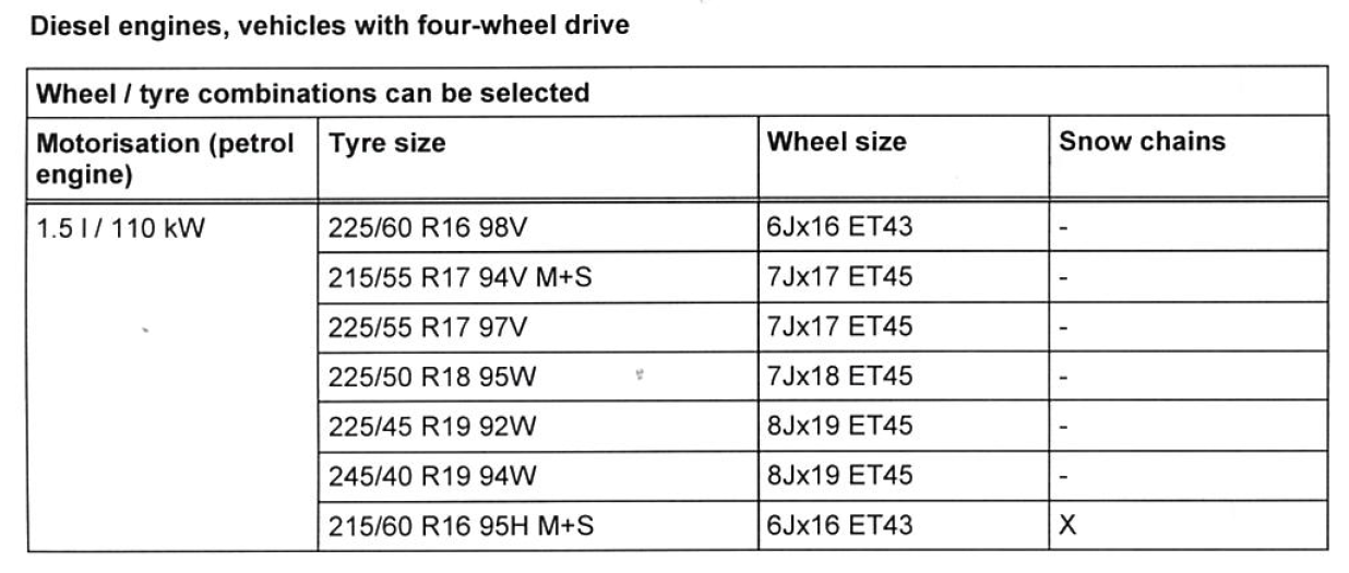

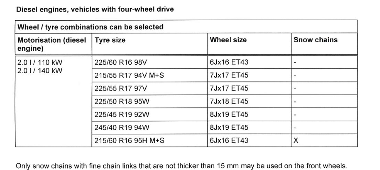

But looking at this below - which dealer supplied - looks like 16" should fit.
Mine was 205 55 R16 -  off Yeti - which was too small a profile to the list below.. and quite a bit smaller when next to each other - So would have needed new Tyres... but could have reused rims.

image.thumb.png.f037078e368ea037111fc6f4db8f9735.pngimage.thumb.png.a28c593b7624a0cb58e3ec83a8cd90f5.png
