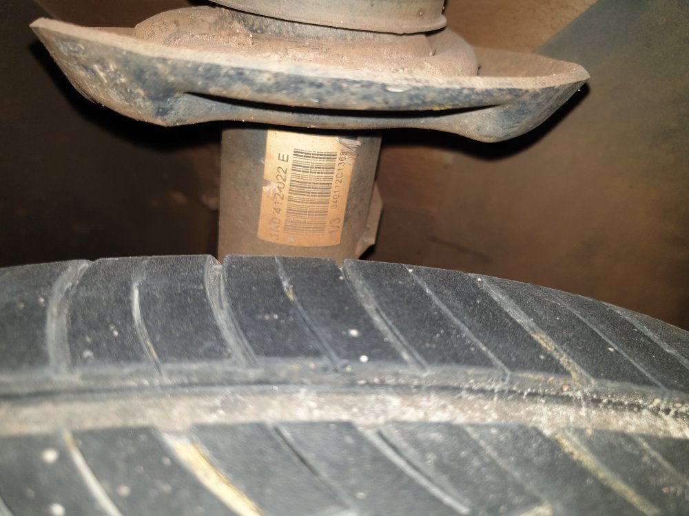

I've got a 2014 2.0 TD 4x4 black Edition yeti with a front shock that's got a slight oil leak, so I've decided to change them both to be on the safe side I've measured the top of the Shock with a calipers at 55mm. However I've emailed a few sellers on eBay and on-line auto retailers with the measurements and the OEM number (1K0 412 022 E) but each one says they can't match the OEM number to what they have. when I've used the OEM number to search all I get is a list of used shocks. Can anyone help me find a replacement?

Can you not just go to a Local Motor factor, give them that number but also your reg number and see what they see,
or do you know someone to get them from https://tps.trade
Or even a VAG/Skoda dealer?
^^^ Always the Simply Clever thing to do, then you know what the cost is if getting genuine parts from them.
Not always more expensive than buying from elsewhere by mail order.
Thanks I'll give it a try, so used to using the online options

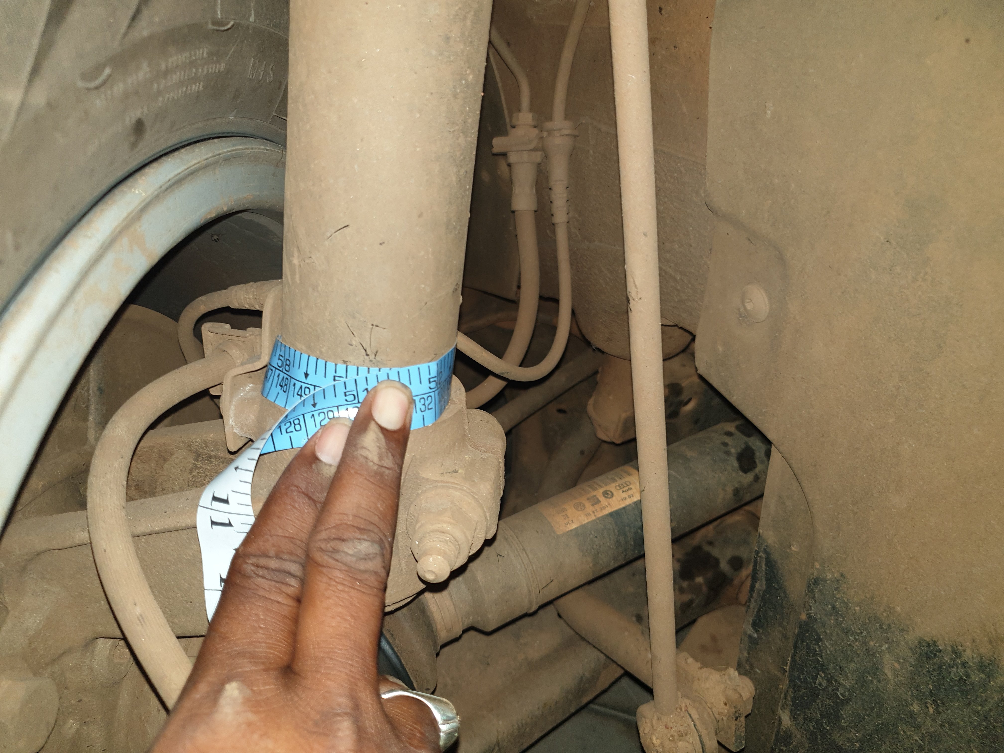

I have the same part number on my strut. the strut 55 or 50mm is universal and timeless confusion across all VW owners at various forums. But you should be measuring the bottom of the strut which sits in to the knuckle housing than at the top. If you do measure, please drop me a msg. i am looking to replace as well.
7 minutes ago, langers2k said:
@mechophile - I'm pretty sure you should be measuring the diameter not the circumference of the strut.
That being said:
- a 50mm strut will have a ~157mm circumference
- a 55mm strut will have a ~172mm circumference
You can even make a cardboard template or two as described here: https://www.darksidedevelopments.co.uk/products/st-suspension-st-x-lowering-coilover-kit-for-mk5-mk6-platform-vehicles.html
@langers2k - the above measurement is taken by turning the wheel to the extreme right and get into the wheel well with one hand to hold the tape. I bet you cant measure diameter with one hand :) . i did take circumference and did the C=pi x d. Yet, i am not confident i got the size right. the circumference indeed measure about 170mm like you have said. it turns out to be 54.xx mm. i am replacing pads in a couple of days and planning to get the strut assembly out and measure. Also, i learnt there are other ways of finding the strut size. by measuring the brake discs.
280 mm discs will have 50mm and 288 mm and 312 mm have 55mm. another way to find apparently from the vw forum info is, the code on the brake calipers. FS111 or ATE. However, there is nothing on my brake calipers when i checked without getting the wheel off.
