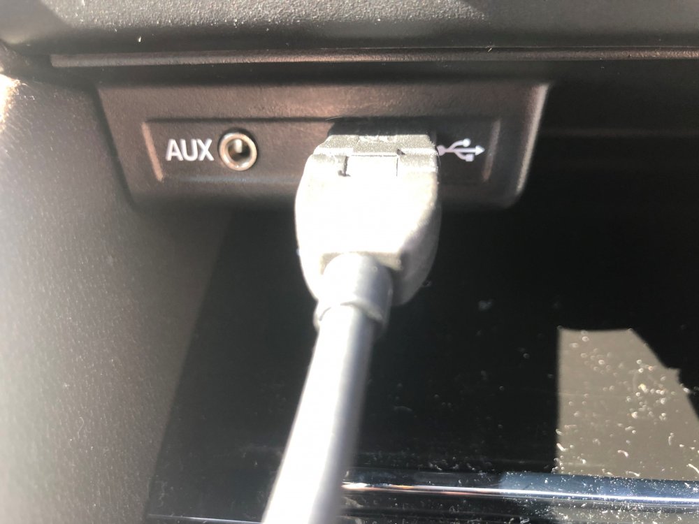

I have a 66 plate Octavia estate and my usb slot has recently had a lot of movement cutting off apple play and nav when I'm connected to my phone. Have phoned skoda but they can't find the part apparently.
When it's plugged in it shakes from side to side very easily. Anyone ever fitted a new one? I'm not sure how to take it off.

If it’s out of warranty then either get taking the lower bit of dash/tray area apart or book in with an independent as their hourly rate should be less or try a radio/audio car place they can often sort out USB ports etc

I was looking to see how easy it was to take out mate, not sure if anyone here has ever replaced them. I can't imagine it would be too complicated.

As for replacing the part. Try 5Q0035726E for starters. Might not be 100% right but should point you in the right direction. You'll need some vag audio tools to remove the screen which will give you access to remove the aircon control cluster then to the usb module. Shouldn't cost much more than £50 for the whole job.

Universal stereo removal keys from Ebay- generally about £2 - £4 to remove the screen, then some plastic trim removal tools (similar price as stereo removal keys from Ebay). The replacement USB is about £32 from the dealer iirc.
