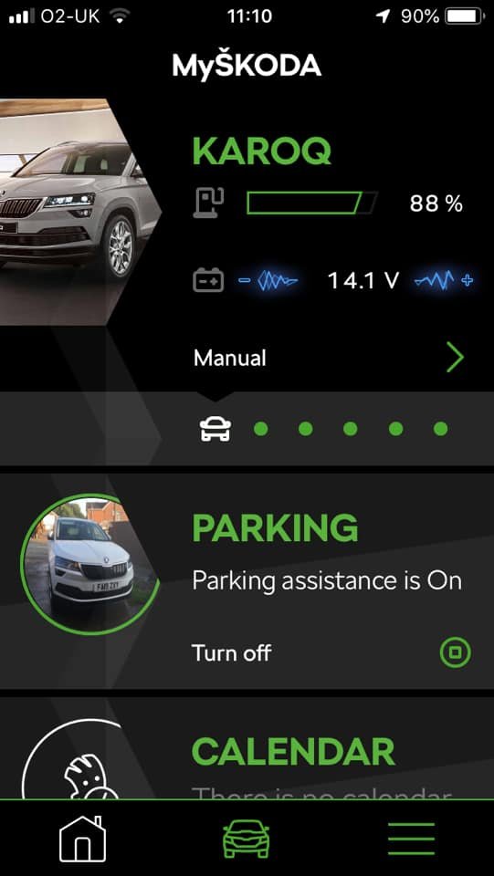

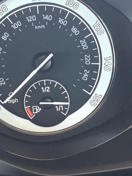

Had my Karoq a couple of weeks now, and love it, but am puzzled by something that I'm beginning to think is a potential problem.
I can only fill my fuel tank to 88% full (according to MySkoda app) and the fuel gauge in the car shows it being 7/8ths full.  That's with moving the pump nozzle around and trying a few different fuel stations..
Has anyone else encountered this??
Thanks

Very probably; like pretty much every other Skoda in the history of "accurate fuel gauges" the pressure cut-off leaves an expansion space at the top of the tank.
My brand new Octavia was similar. Had to have a whole new fuel system put in because the sensor was foobared.

I fill the tank of my Karoq 1.6TDI SE till the filling station pump stops - tank full.  Gauge always on the max.  In fact it takes approx 40 - 50 miles for the needle to start dropping from the max.

Might be different on your Karoq but my experience of many Skodas is that the tank is nowhere near full when the pump senses back pressure and cuts off, if you are patient, and you need to be very patient you can get another 7 litres in.
Same deal when the guage reads empty and the MFD shows zero miles there is a 7 litre reserve capacity beyond that.
