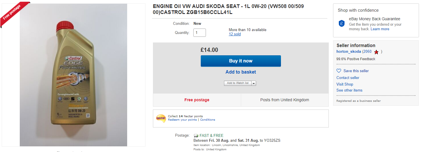

Here is Castrol VW508.00 (0W-20), interestingly from Horton's Skoda themselves, being sold on eBay for not daft money...

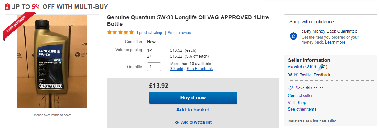

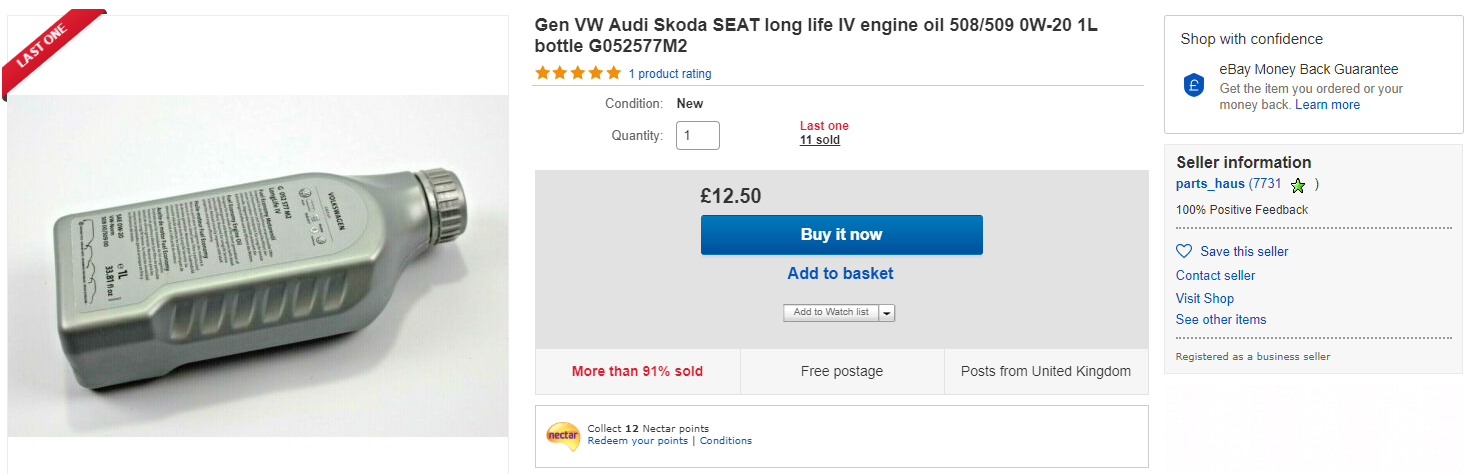

Or genuine VAG equivalent, which is likely to be the exact same Castrol oil (or Fuch's as per their own-branded Quantum oil) in a different bottle...

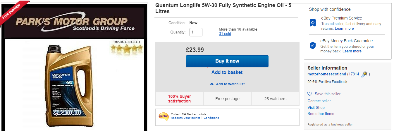

Or just swap out the whole lot and put this in instead, again from a Skoda main dealer based in Scotland...
