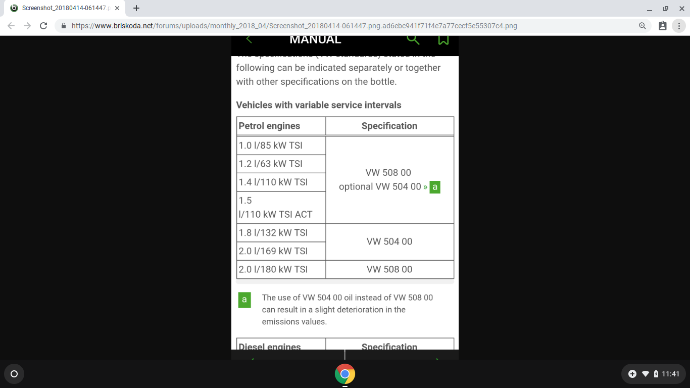

What is ridiculous is Dealership Service or Parts desk staff not know what oil is what, selling customers asking for a litre the wrong spec as Skoda recommend regarding VW508/509
then saying even that is hard to get as members have posted in other sections.
Sending a customer to the Audi Dealership to get the correct oil really is taking the pith.
Maybe the workshops are using the correct oils now, maybe not, as it is the Service Prices might be going up if they do,
but then for years some have said VW504 / 507 was 'Special Oil'.
The footnote here is rather important, if really the emissions change because the Oil VW Group went for to get through the WLTP Certification.
I would rather use a bit more fuel, and have good engine protection with a TSI. That seems to be 5w 30 FS III now,  in the past i always went with VW502 spec and stuff Long Oil crap.

It's not just us or the dealers that are confused. The current owners manual doesn't state what oil to use it refers you to a "specialist".
