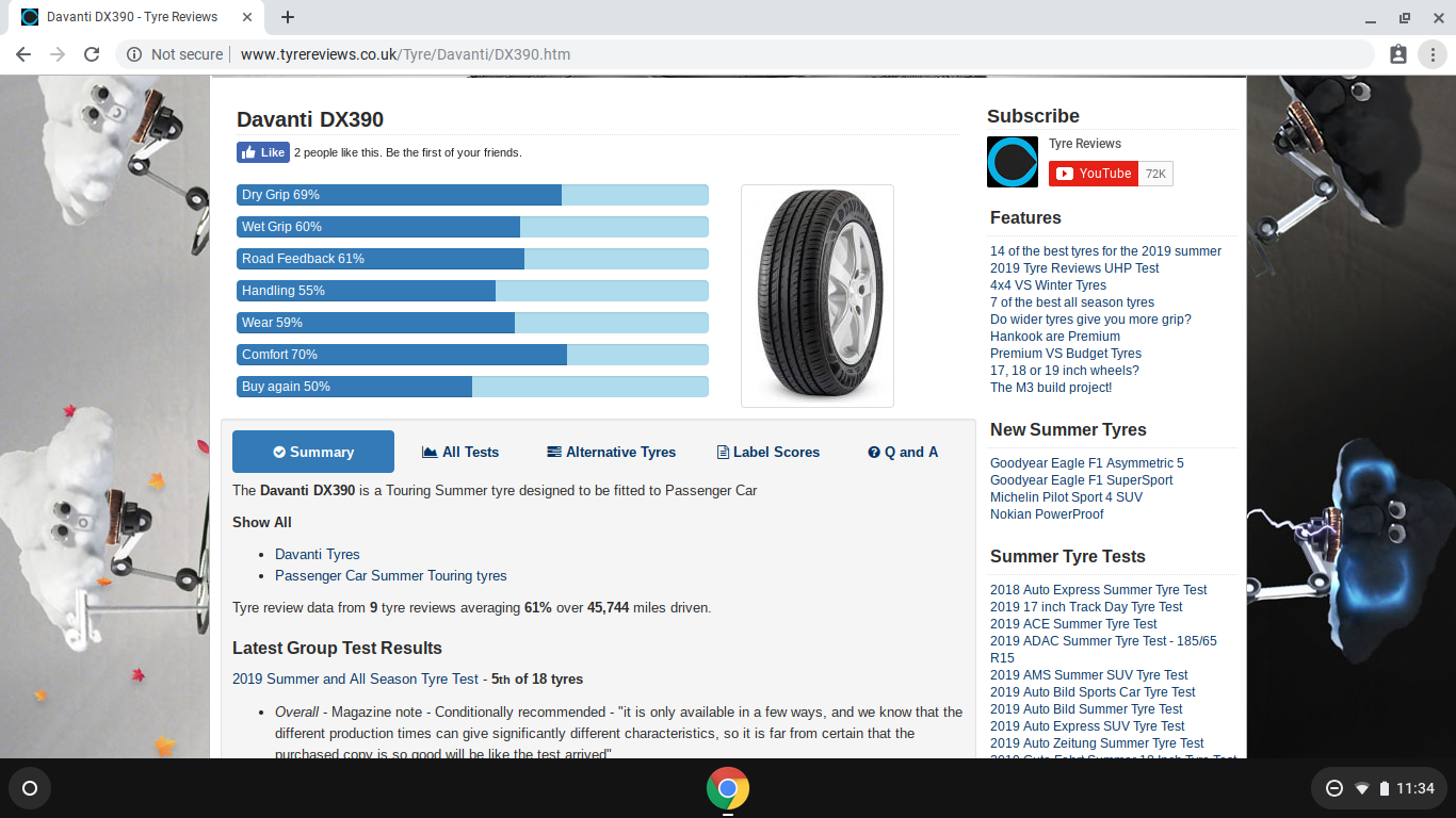

You can take or leave Tyre Reviews, maybe with a pinch of salt, but this on the Davanti DX 390 is pretty bad.   Not really much like even an All Season / Summer tyre.

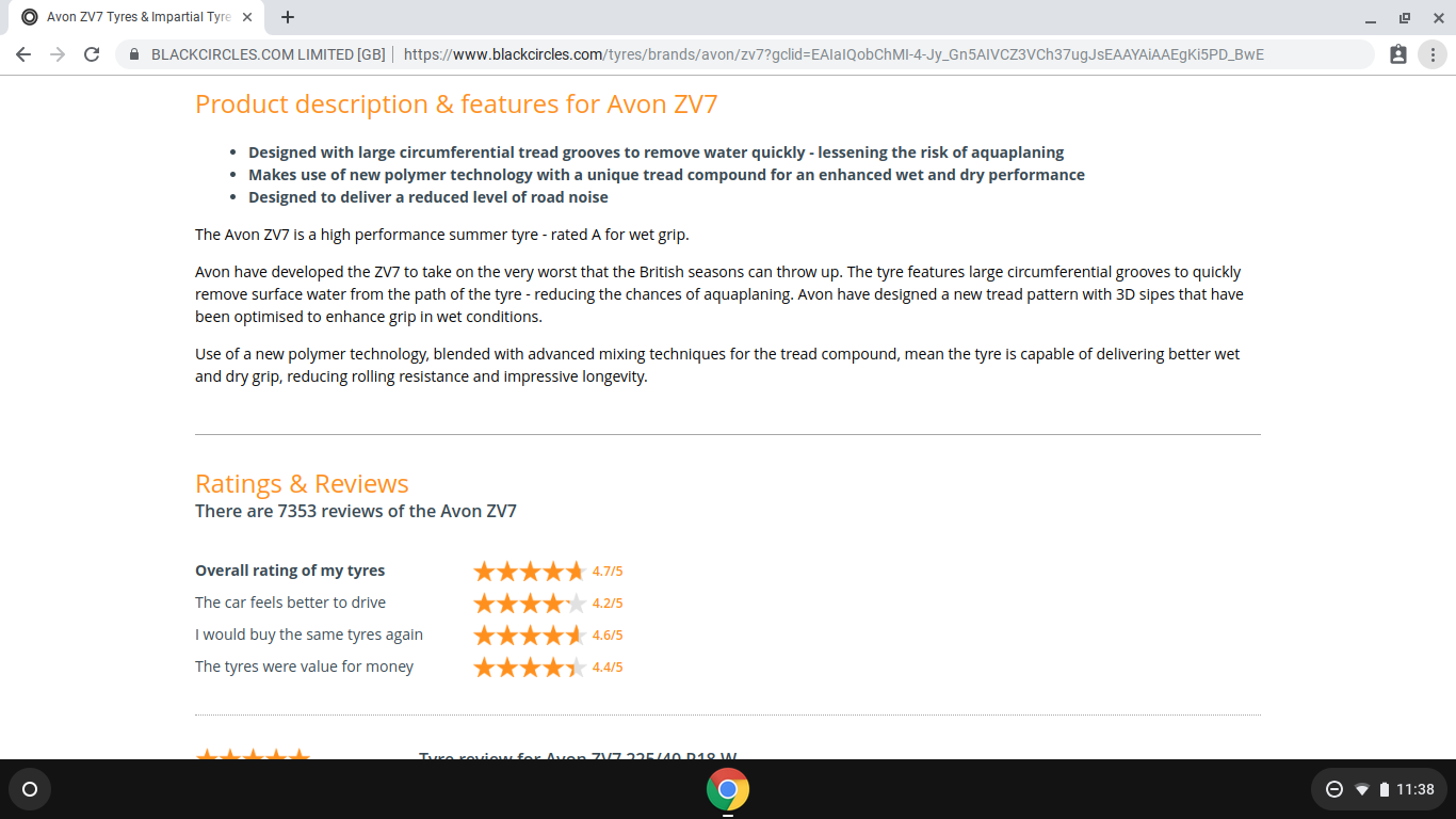

I used Avon winter tyres this past winter, and the ZV7 are certainly worth considering.
