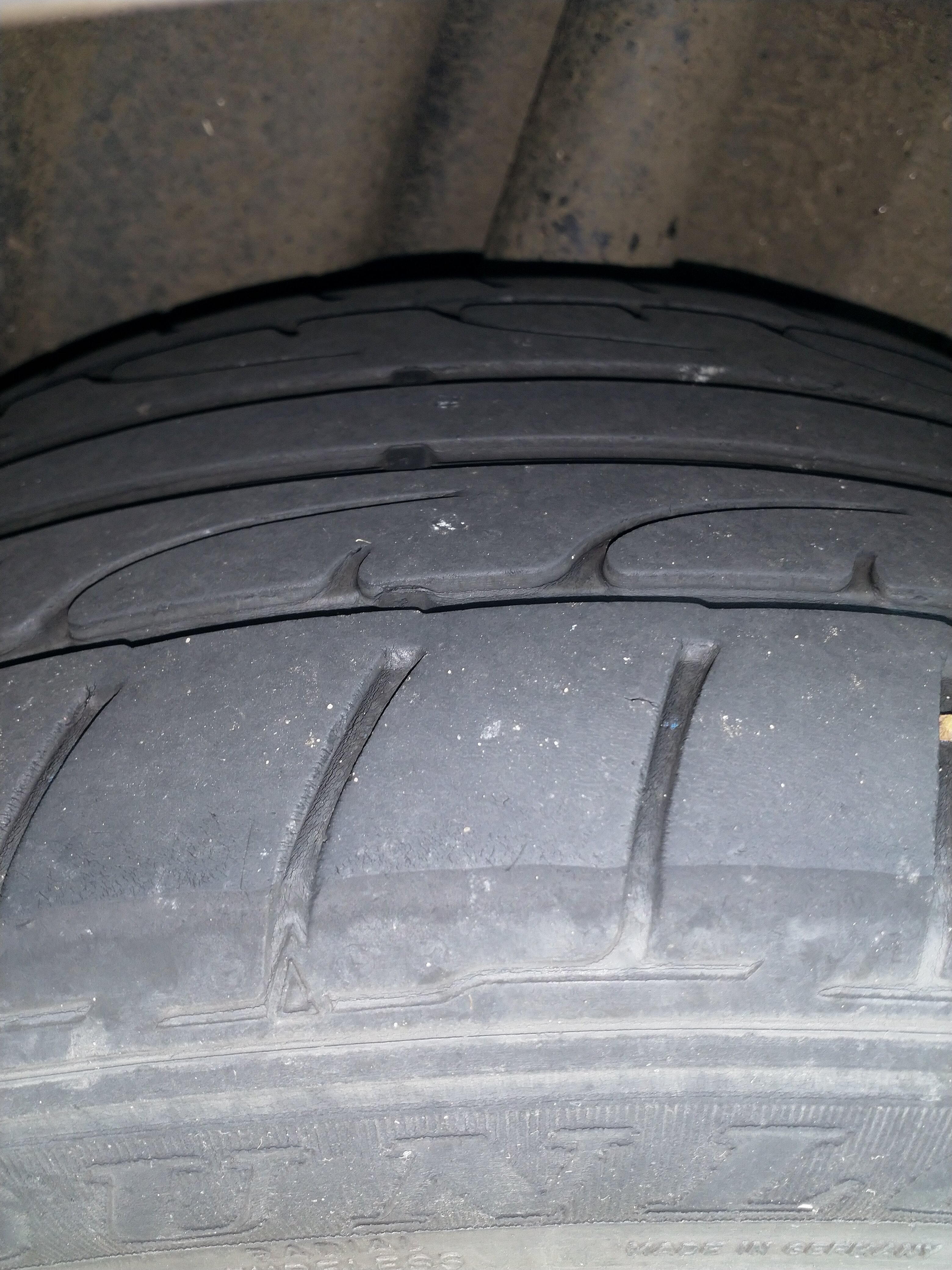

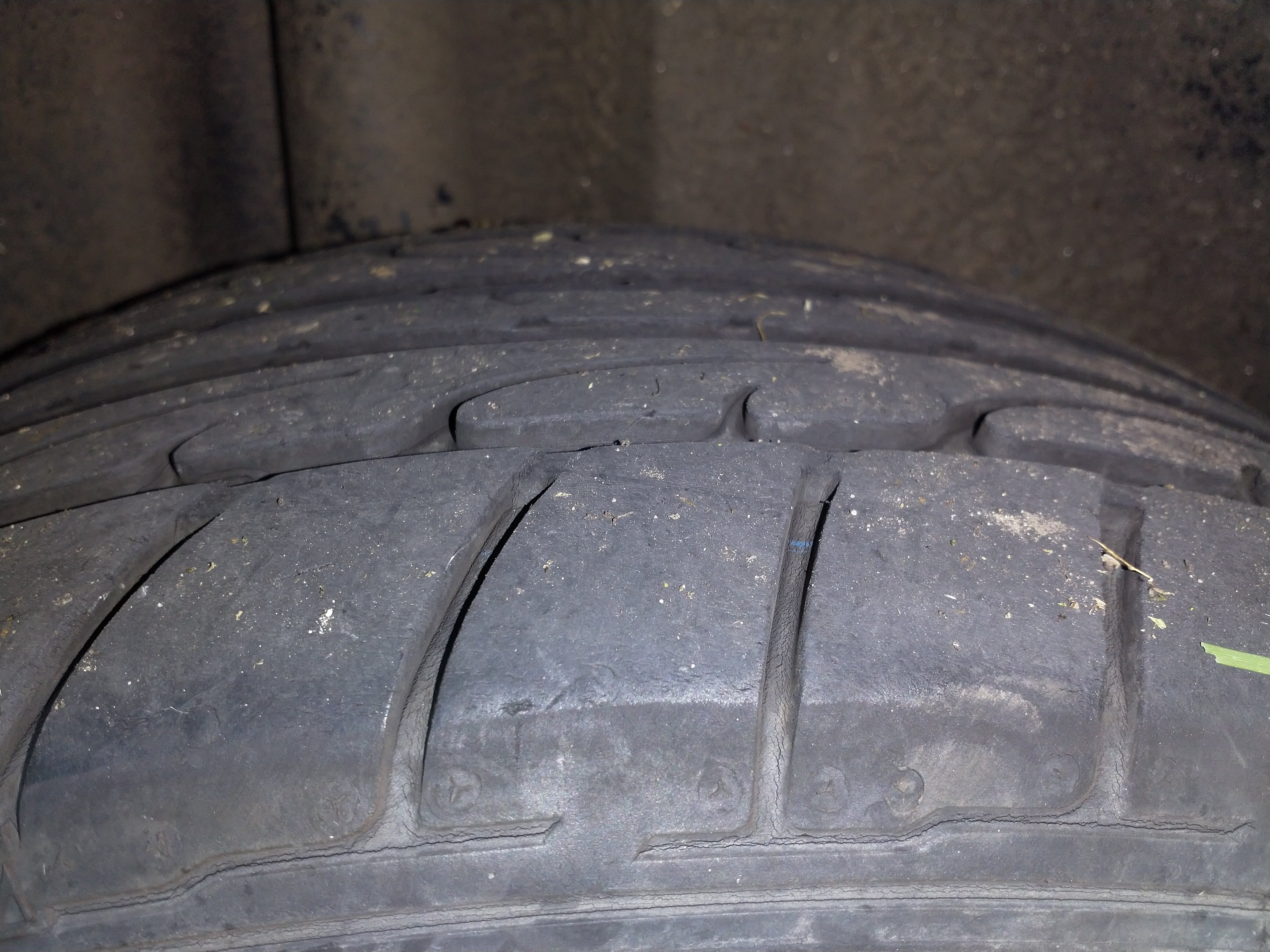

Not sure about sawtooth? Can you tell from this pic?
From the pic, can’t tell regarding sawtooth as the change of colour (the tread and sidewall) appears to be following a continuous curve rather than uneven, but is only a small part you have photographed.
But you have pictured the wear indicators (the small triangle marks these) and it appears they are very close to the surface (the bumps in the longitudinal grooves in line with the marker triangle).  As these mark the absolute minimum legal tread depth tyres are close to needing replacement anyway.
Very sensible to put all seasons on, rather than summer tyres.

It's hard to tell sawtooth from pictures. If you run your hand both ways round the circumference and feel steps that are more pronounced when your hand is moving in the direction of rotation than against it. that's sawtooth.

Those are the old fronts so they were more worn on one edge. They've switched the original backs back again and it does seem quieter now. Not sure how much longer they'll last but they look ok now?

Would it be all the way round or just in one place? I can feel some bumps but not all the way round.

There's no hard and fast rule either way on that with anti-lock equipped cars (which would be pretty much all of them these days).

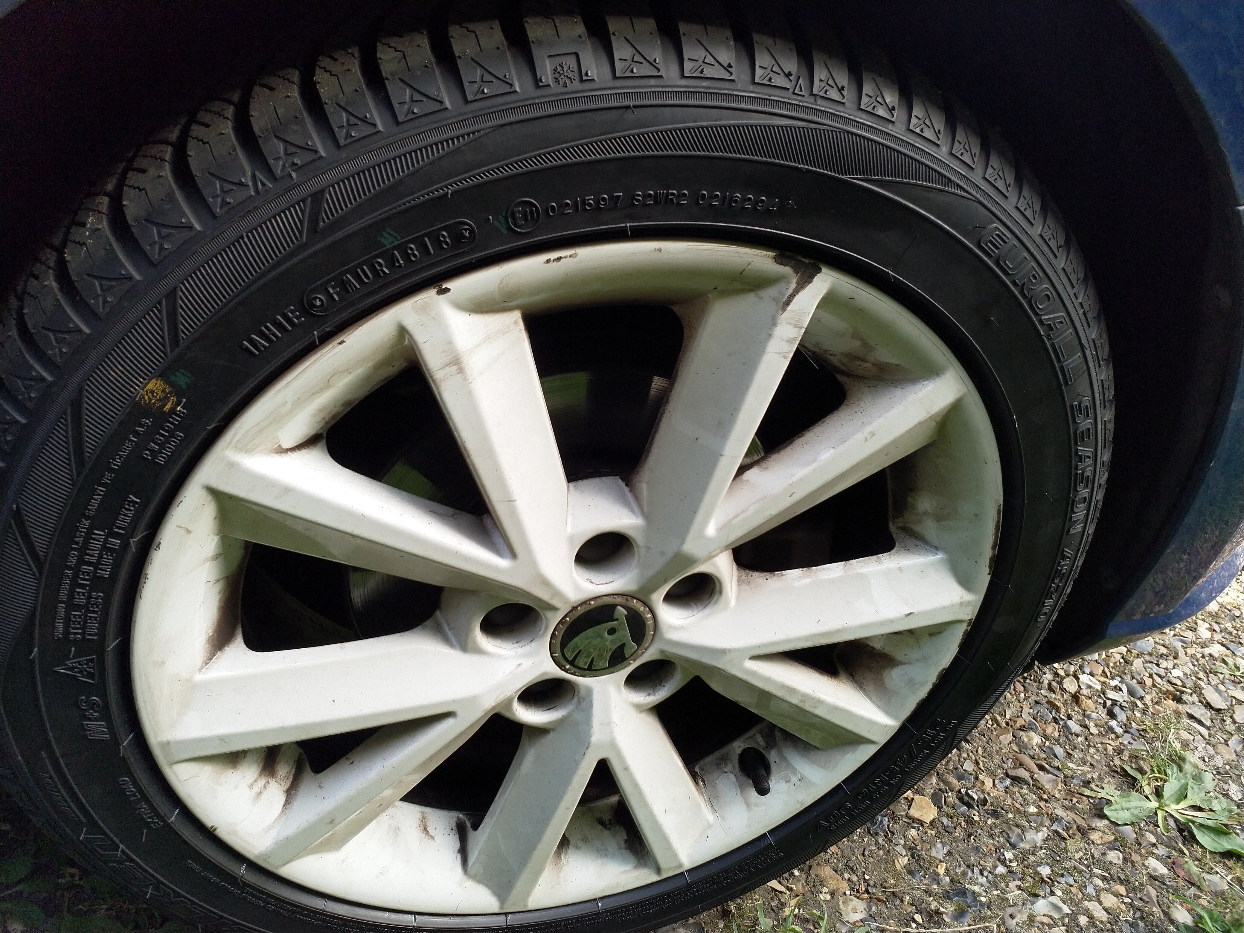

They could get some Falken all season tyres in by tomorrow
Have you now got All Season Falken on the front and Summer Dunlop on the rear?
Thanks AG Falco
Yep. I did ask the garage if that was ok and they said yes.

Well, that looks like the sort of fun that leads to uncommanded  panoramic views of your surroundings in Winter!

Get them to look at this demonstration then ask them again.
The Falken All Season tyres have got the Three Peak Mountain Snowflake Symbol on them.

@Eeeekkk you need to stop asking this tyre place for advice.
You should never mix all-seasons and summer tyres front to back for what I’d have thought would be obvious reasons as @KenONeill has alluded to!
Any professional tyre fitter would never recommend putting new tyres on the front axle whilst keeping the part-worn ones on the back! If you have to swerve suddenly you don’t want the back end swinging out.
Do yourself a favour and do some research on tyres / best practices with them. Tyres are a safety critical part of your car and that tyre reviews website has pretty much all the info you need to swot up - A bonus is their videos are pretty interesting I think.
