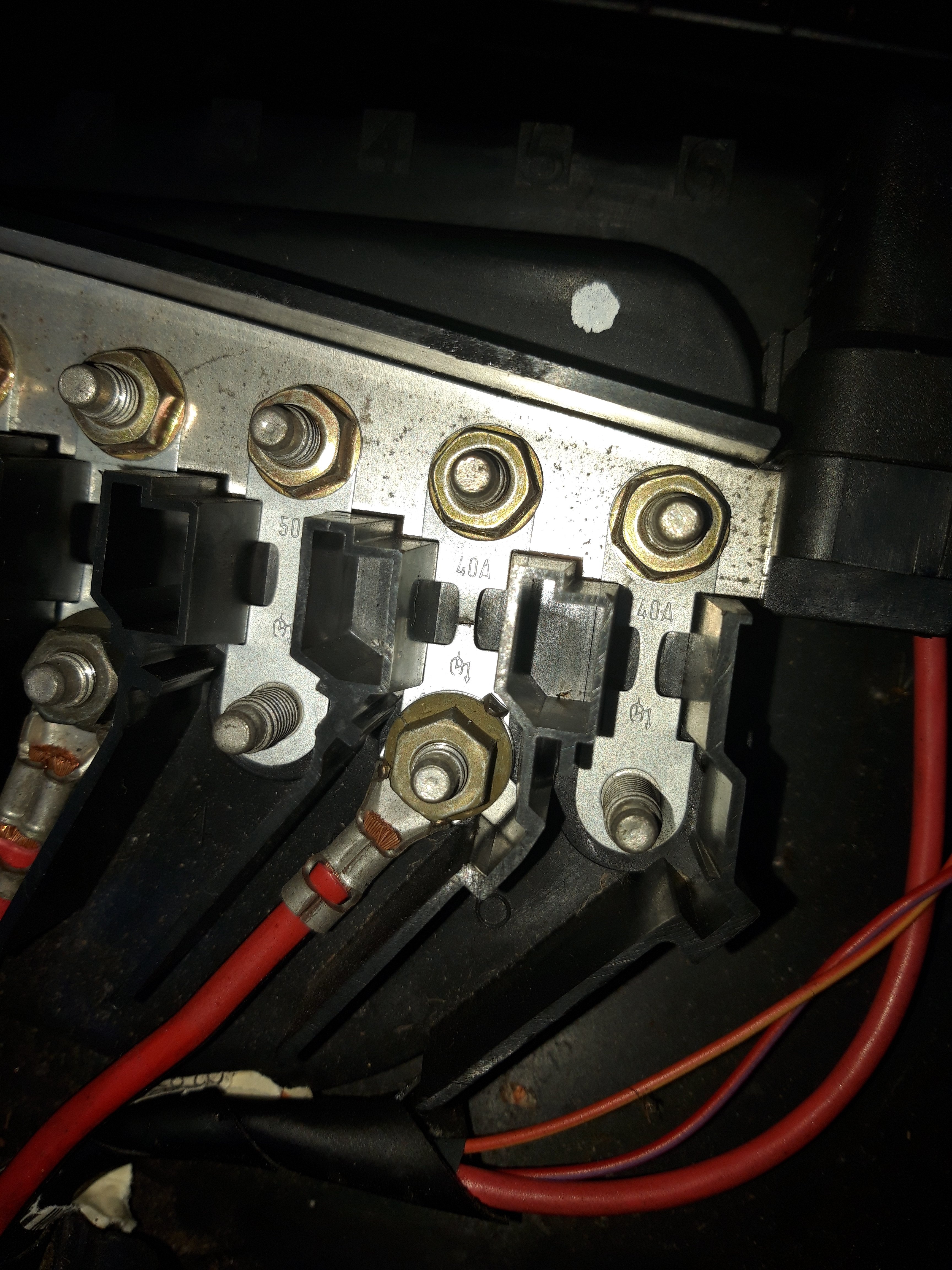

You are indeed correct one of the strips is broken nice one guys how do I fix this please as it looks like a single plate.
It isn't a single plate, undo nuts, remove broken strip and replace. Or just move the wire over to the unused one next to it.

Odd that there's no wire going to your ABS strip-fuse in position 6... The car does have ABS, right?

I dont have a fuse in position 8 Wino only 9,10 and 11 😐

That's weird, I've just double-checked the wiring diagrams, and the low speed fan fuse should be in position 8, can you get a good photo of just those fuses?

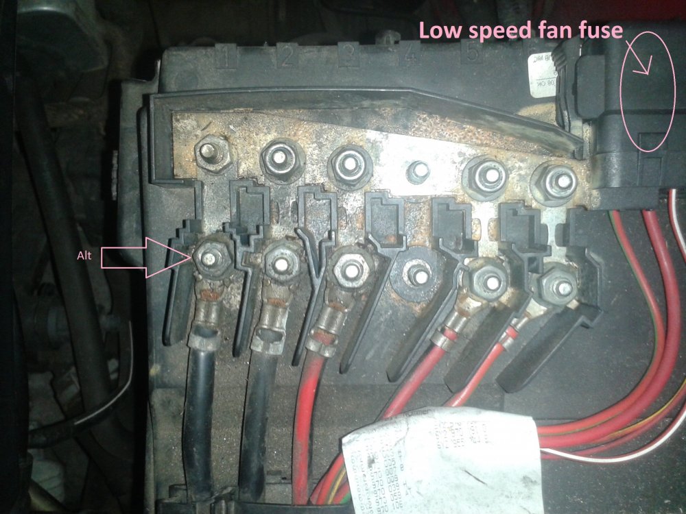

  • Sponsor
Comparing the position of the thick red wire on the right of your picture, with the one on this photo, I'd say yours is in position 8?
