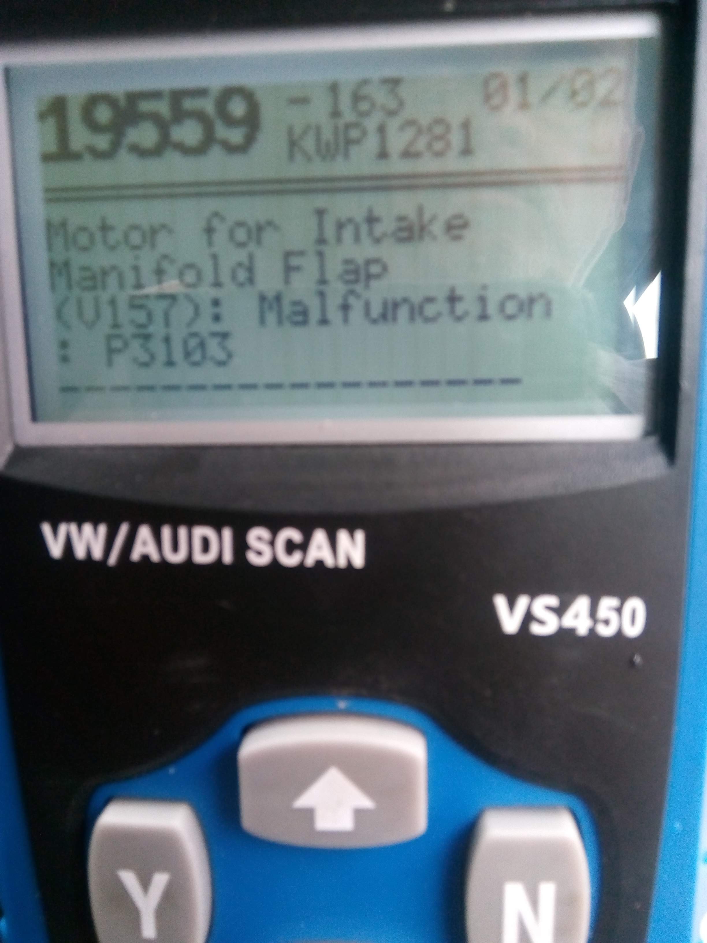

A picture speaks a thousand words
I see your scanner has arrived Paul :thumbup:
Yes Lee worth waiting on. I don't know all it's functions yet but it's a useful little tool
Thanks for all the replies guys replacement valve/throttle is working. I managed to get the self tapper out and the glue picked off the old one. The crescent gear is stripped I might fix it nice to have a good spare one.

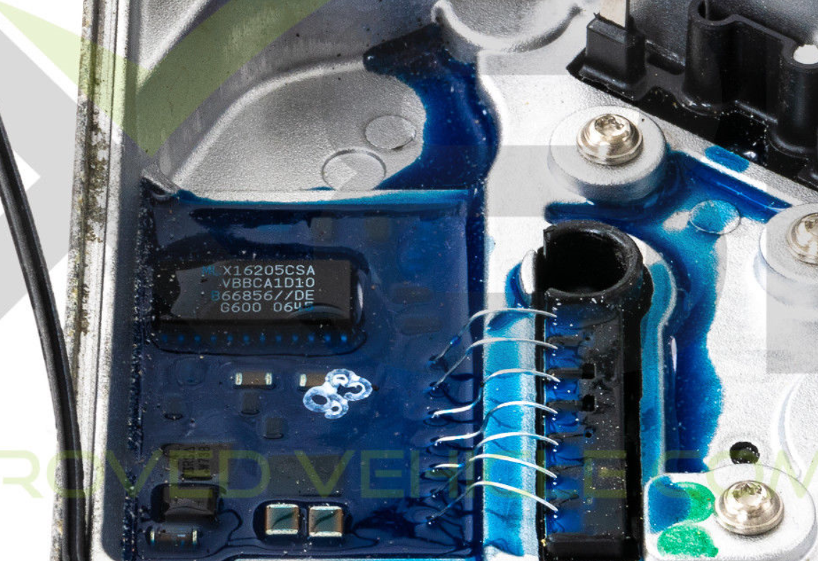

Do you have one in bits you could photograph?
Edited by Wino
  • Sponsor
Hmm, now that I look back at a photo in the ebay listing for the gear repairs, there's a fair bit more to these valves than I would have thought..
Looking like there's some 'intelligence' within.
I have the old one the gears are still on it. I will remove the gears and try it with the plug from the car see if it puts on the light. I had a Renault Megane with an EGR issue. I blocked the EGR but the light kept coming on. I bought a used one, took the electrical gubbins off it and plugged it in and tied it to the bulkhead. Light stayed off. (I apologise for saying Renault) The MAP/MAF sensor suggestion could be on the money
