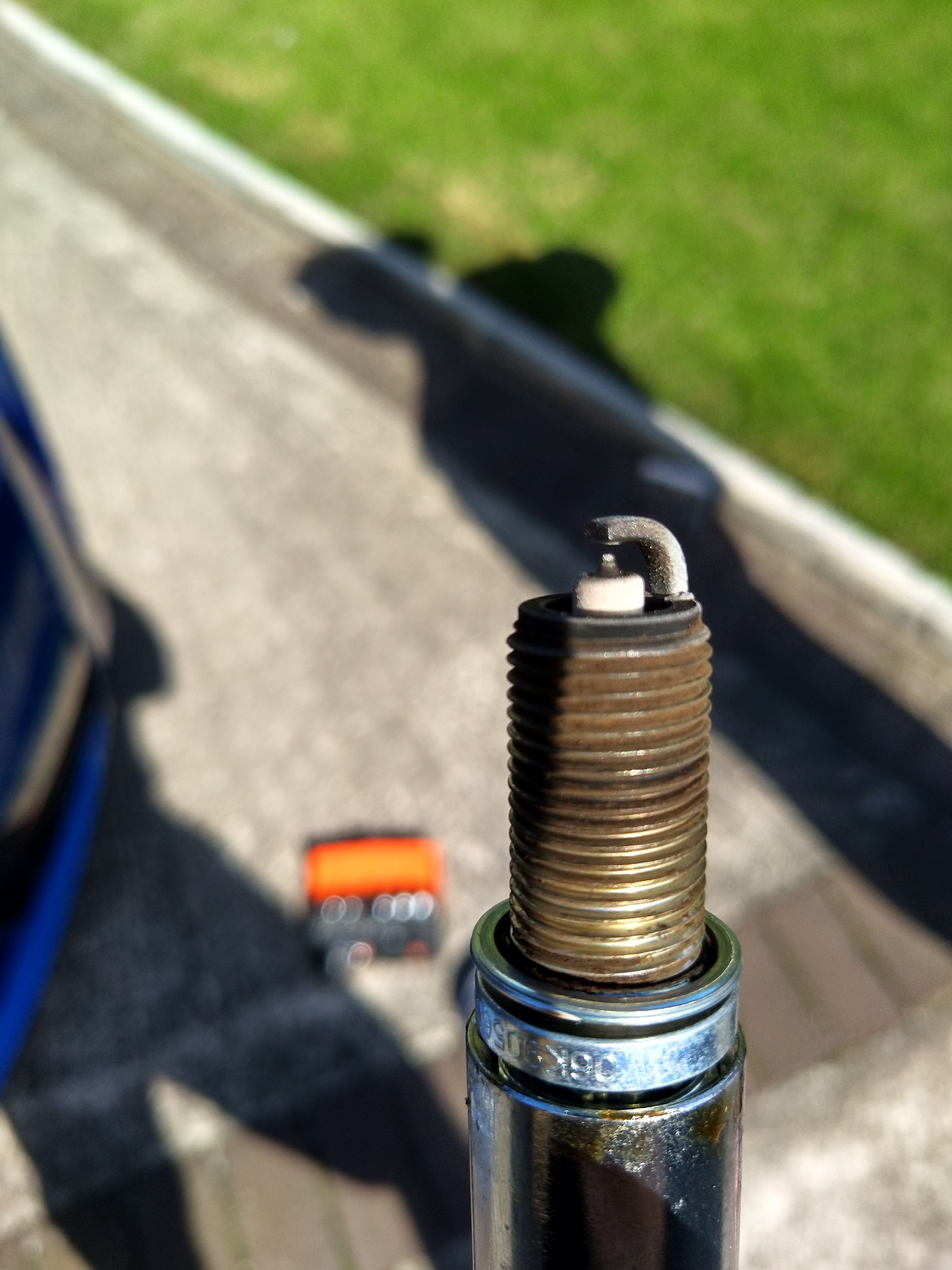

All 4 plugs changed and for belts and braces the coil pack on cylinder 2 was changed at the same time (Warm the engine up first and they just pop right out 😁)

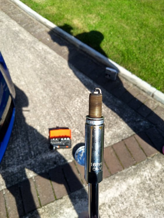

The plug in cylinder 2 really didn't look faulty as you can see here:
658870659_2019-09-1011_28_45.thumb.jpg.95041aa18e1077e8d3b5f07ebb306ddd.jpg956092684_2019-09-1011_28_52.thumb.jpg.6793690d44745bea81583a3581ce8a9f.jpg
I couldn't see any cracks in the ceramic, and the electrode looked worn, but not overly so.

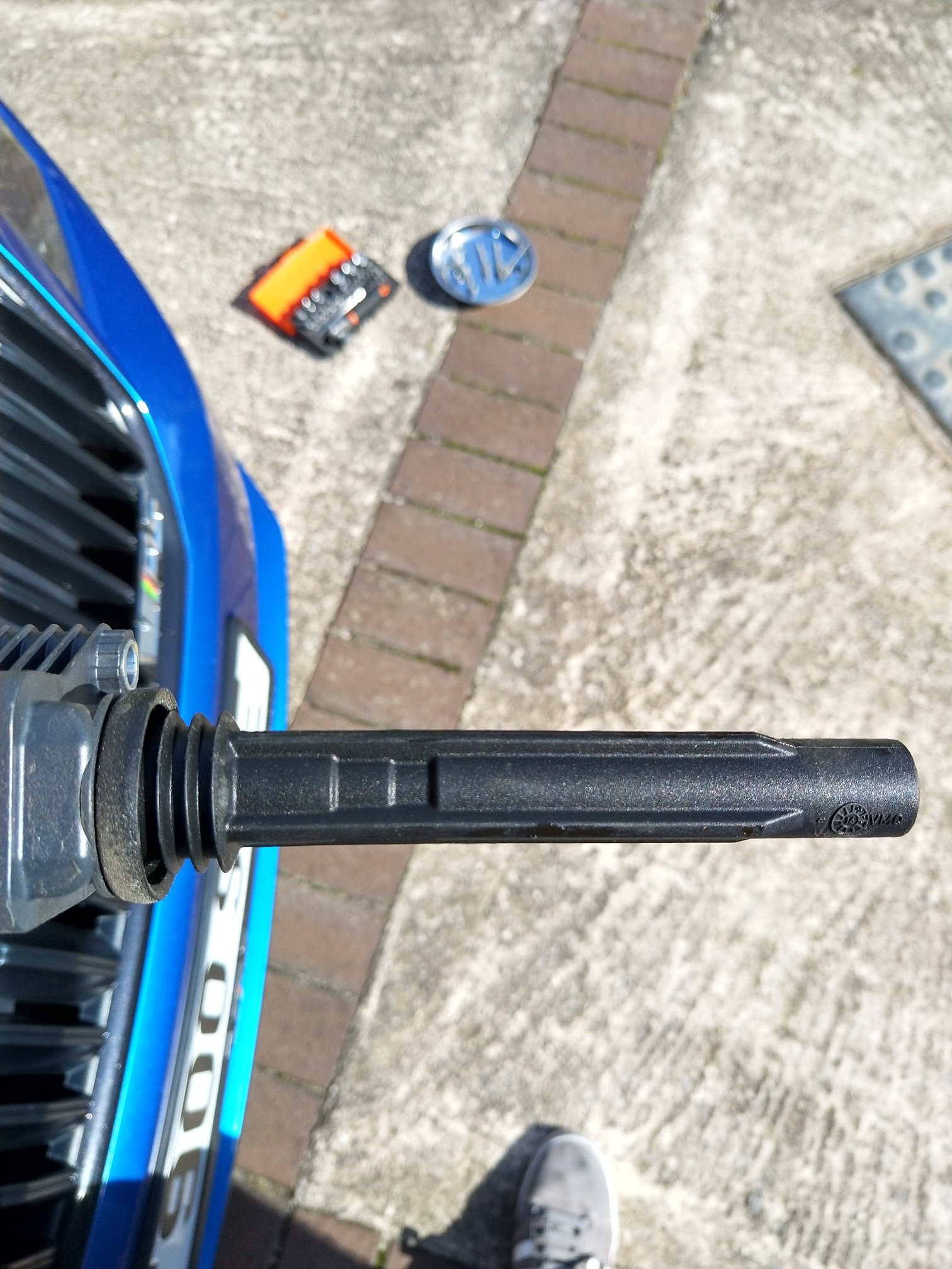

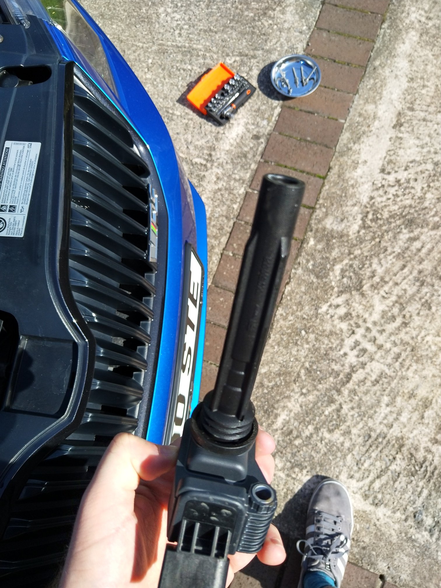

The coil also looked fine with no obvious problems:
71801425_2019-09-1011_52_38.thumb.jpg.6e41d50711fc776ce9572c8997f4a878.jpg604291290_2019-09-1011_52_49.thumb.jpg.b3a84a2378f165bffc6c9ccccbc4e50b.jpg
However after replacement I can confirm the issue does appear to have been solved. We now have a nice smooth and quiet idle. Although it was intermittent before so it's possible it might resurface!

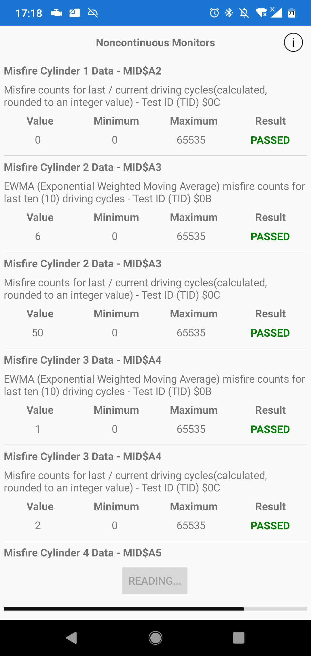

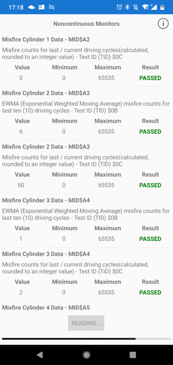

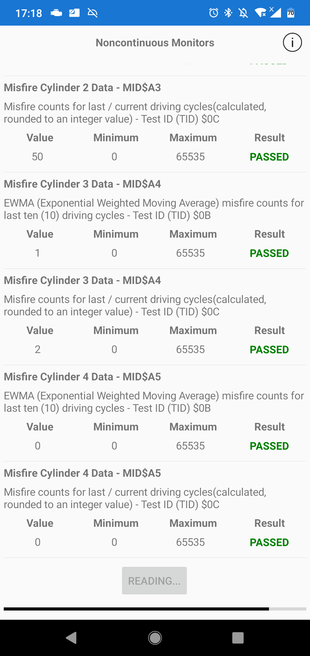

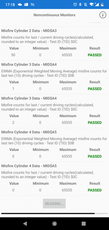

Misfire is back on Cylinder #2. I even managed to capture it in progress this time -
Screenshot_20190920-171806.thumb.png.8046e9fcc252c5ed35e86e53528d51b1.pngScreenshot_20190920-171816.thumb.png.566ee06e0f7a156d681556df1d11232d.png
The moment I touched the throttle (I literally raised the RPM by about 50) the problem went away and the misfire counter stopped climbing. The car was then fine.
I phoned my local Skoda Dealer (Skoda North Wales) and explained what was happening and the mechanic had never come across the problem as described. (fills you with loads of confidence)
This really feels like an error in the software/Engine map, and not a mechanical fault at this stage. Me touching the throttle should not fix the problem until the next time the car is started up.
