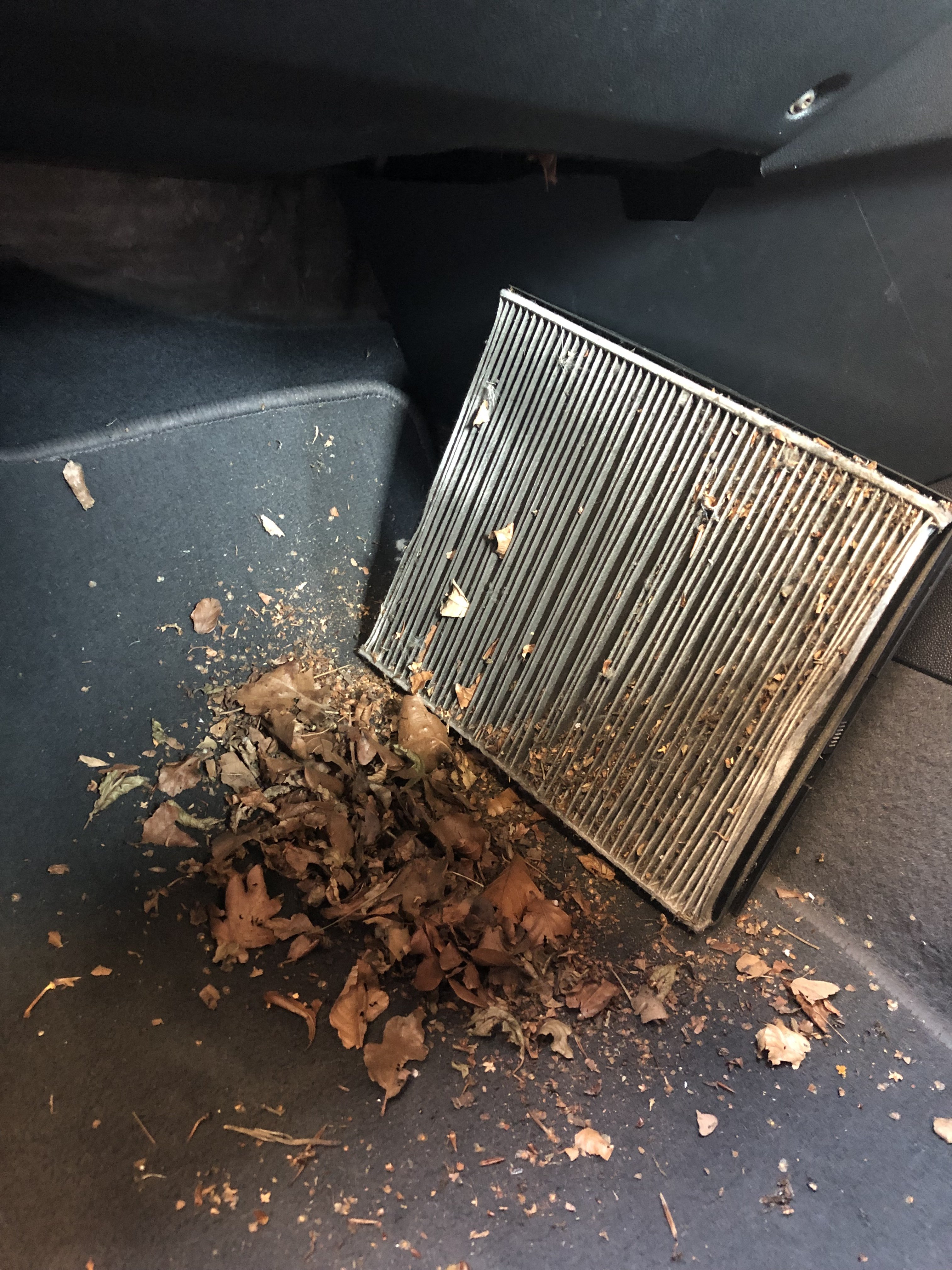

Bugger was the squirrel still in there
just done the cleaning process. the can only lasted about a minute, well it seemed around that. all i did was went back in house then came back out to check and there was nothing coming out of the can. talk about quick or what? anyway, i kept the engine running for few more minutes then opened all the doors and windows to air it out. i did take the pollen filter out when i did the cleaning process.
