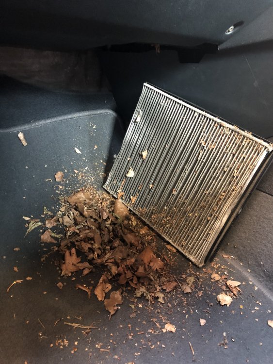

23 hours ago, rum4mo said:
I've fitted the Frecious version of the Mann pollen filter to both our cars, in the case of my car, just because we use that car for longer journeys, and in the case of my wife's 2015 Polo that has auto AC,  her VW dealership workshop replaced the original carbon coated one for a basic one probably as that car was bought with a 3 year service plan, so cheapest options work best for the workshop! Again these filters tend to be bought at a "good" time pricewise from ECP.

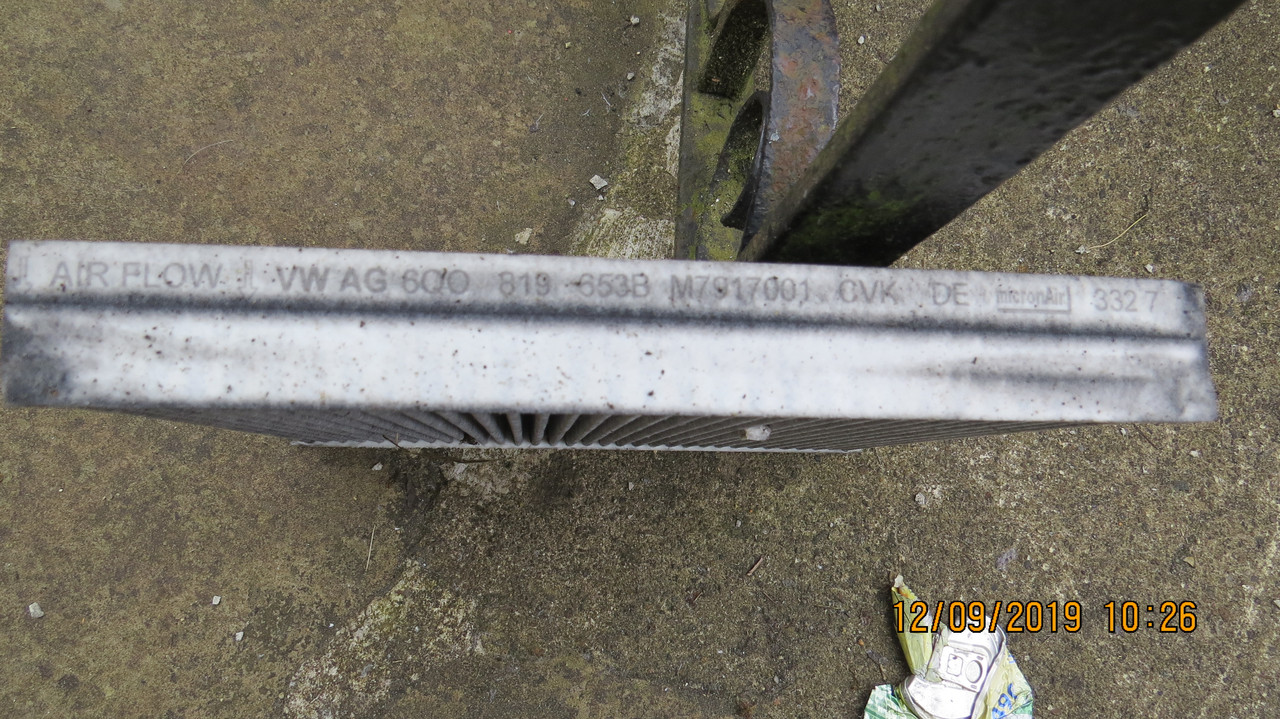

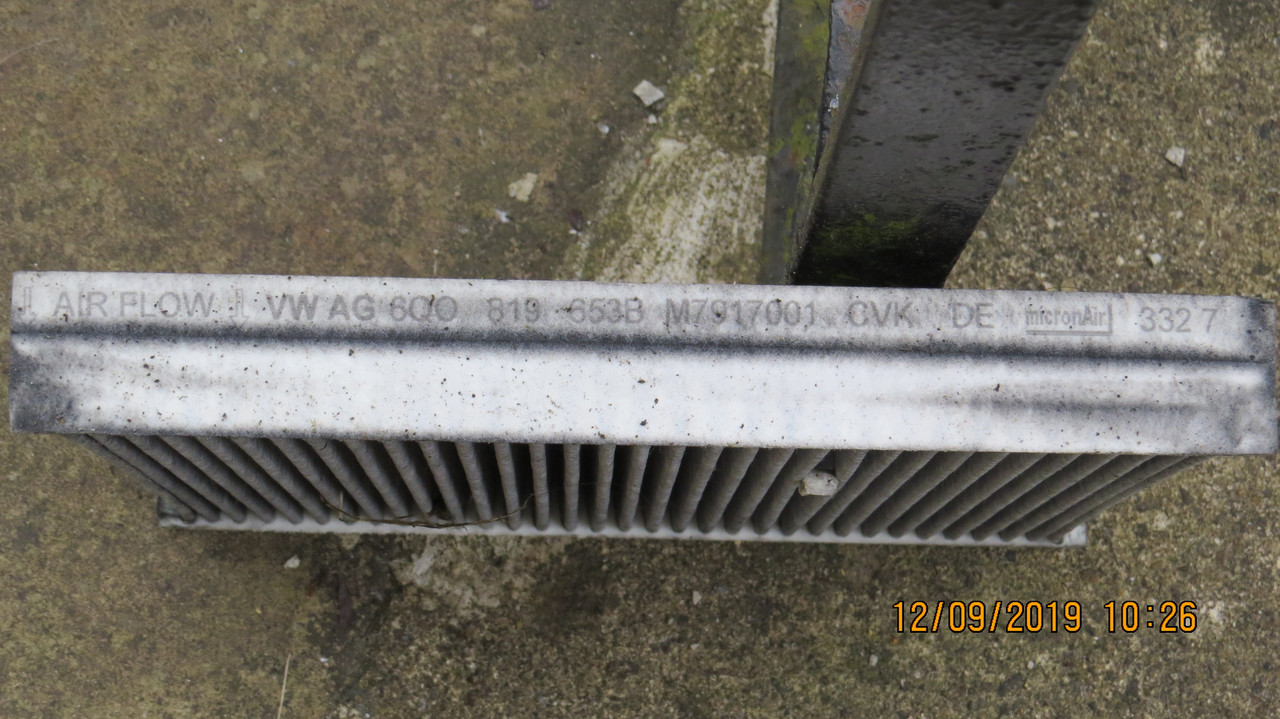

Edit:- maybe something to consider when it comes to next "change time". From the colour of your old one, I'd think that is was carbon coated, the p/n on the end would confirm/disprove that.
this is what it said on my old filter

The non-carbon one has a different part number, namely 6Q0820367B.
so the one you linked is definitely a carbon one?
  • Sponsor
Yes.
Part number alone tells you that.
Plus the description says:
Part Number:
6Q0819653B
Description:
POLLEN FILTER INSERT WITH ODOUR AND HARMFUL SUBSTANCE FILTERING
just like it says here: https://skoda.7zap.com/en/cz/fabia/fab/2008-608/8/820-820010/ (item 25, middle one of the three)
Looks like there's even a third variant, with part number starting JZW. Never knew that.
