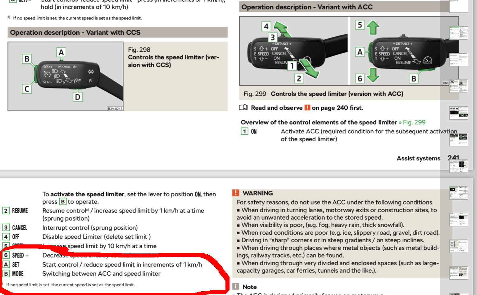

With adaptive cruise, there should be a button on the underside of the cruise control stalk. Pressing that will swap between cruise and speed limiter. I think it defaults to cruise at every restart, but not sure (I rarely use the speed limiter).
As above should have button on underside of stalk
Thanks for the replies.
I thought I was losing the plot so I have just been out to the car and looked again. I definitely do not have that mode button. I don't have my manual to hand, but I am almost certain it's not the same as the image posted either. The stalk looks identical other than the mode button too.

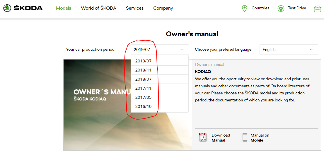

What model year is your Kodiaq? Specifications and features do change from MY to MY.
Download your manual here, be sure to select the right production period...
https://manual.skoda-auto.com/004/en-com/Model/Kodiaq_NS
See what options are listed for toggling between the two functions.
MY19 vehicles don’t have the button on the cruise control stalk. It’s done through the driver assistance menu.
