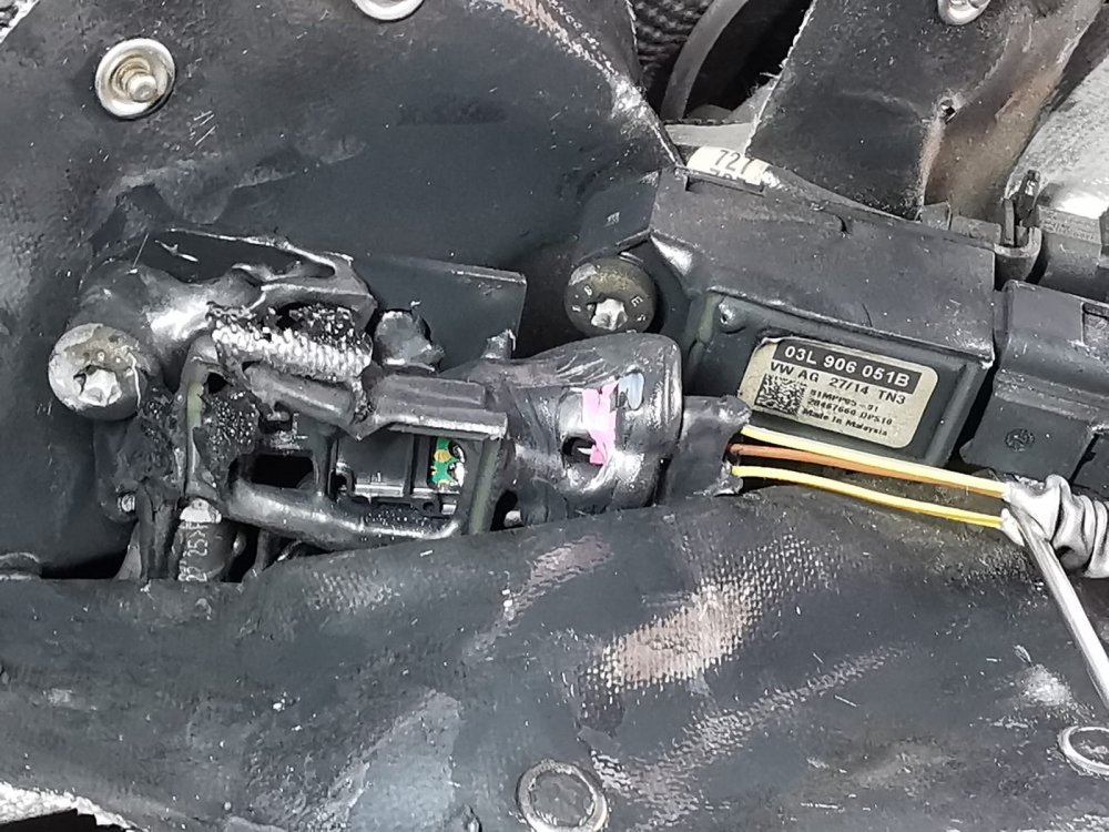

hi guys... i have a Golf 7 2.0 CRLB 150 cp.   213.345 km.
After I changed the belt about 1 week look this happened.... DPF senzor is molten..
Does anyone know if DPF Filetr will have to be replaced ?? or i replaced only DPF Senzor  ???  Please
Hellow again Guys.
I changed sensors in the dealership and everything is ok !   Good thing it wasn't the DPF...

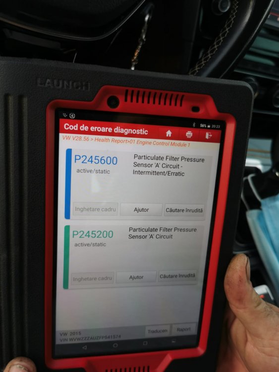

I've just had a cambelt change on my 2016 Superb 2.0 diesel SEL and the engine warning light came on. OBD11 showed P2456 code which led me to this thread, and lucky I did! DPS has just started to melt.
Will replace them both asap.

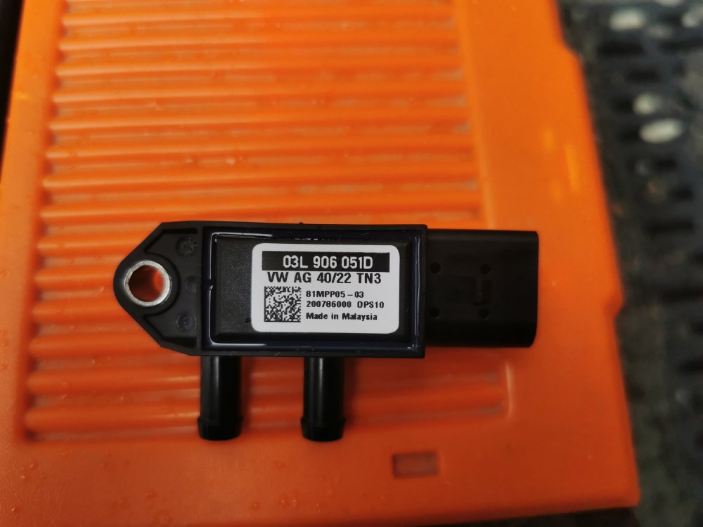

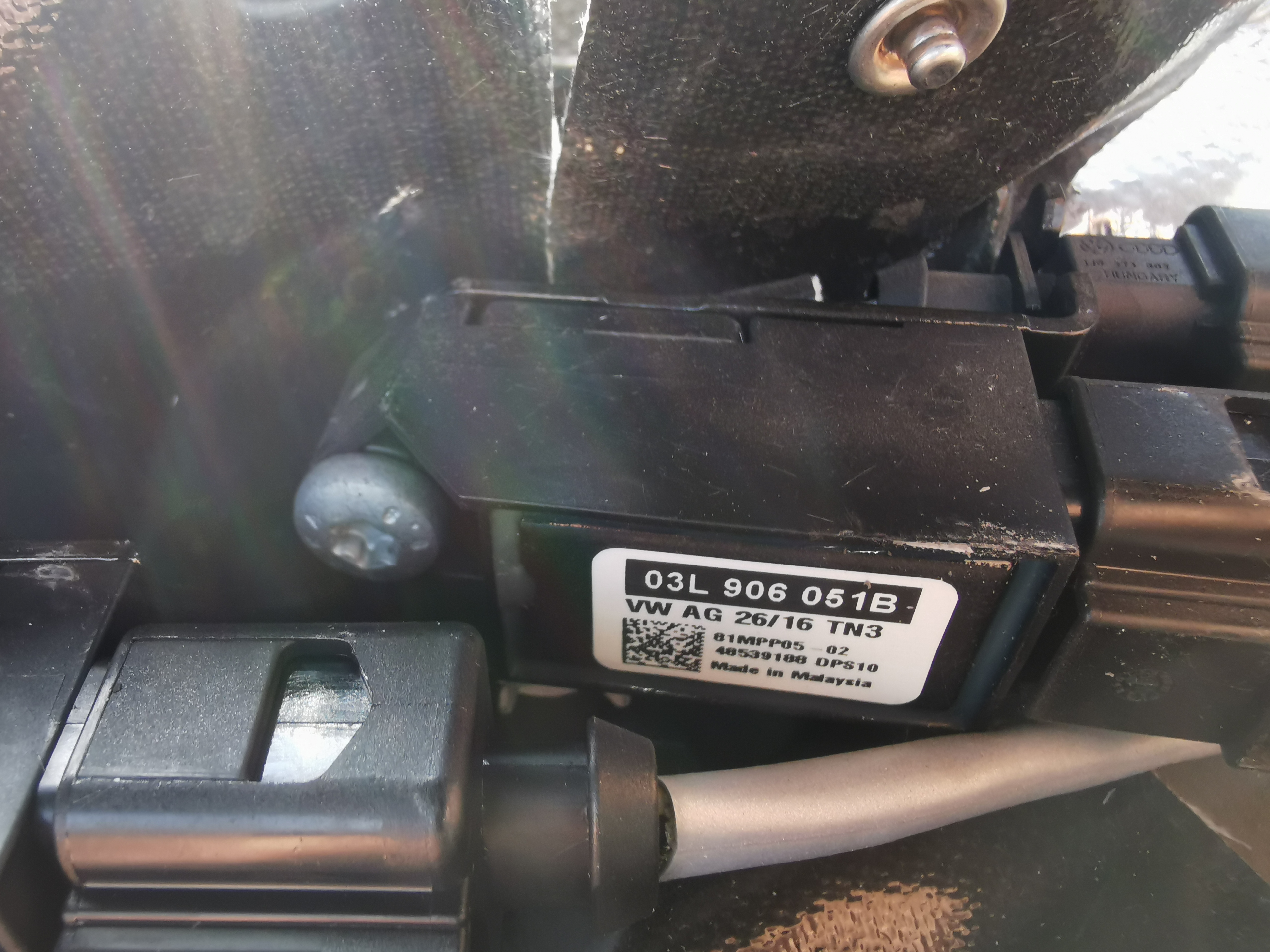

Just wanted to share my experience with Exhaust Pressure Sensor on my Superb MK3. Recently poped out on my dash engine light. Went to local garage and free of charge was diagnosed with fault in 1 of my 2 sensors. As a regular customer (10 years) was offered replacement of both sensors with labour and overal price £300. Pretty shocking price. GSF Bosch £60 ish but today I decided to visit skoda service part shop. Brand new for £82 with discount. Garage said job should last no more 2 hours. So recap - to exchange the sensor took me 4 min!!!! No VCDS no diagnostic. Just took car for 5min driving still with light on my dash. Got cig and coffee for 15 min, returned back and no fault no light on my dash. Saved 220 and couple of hours without the car. Here is my spare part for others. Old one is B series new one D serie.
Just wanted to share my experience. Cheers

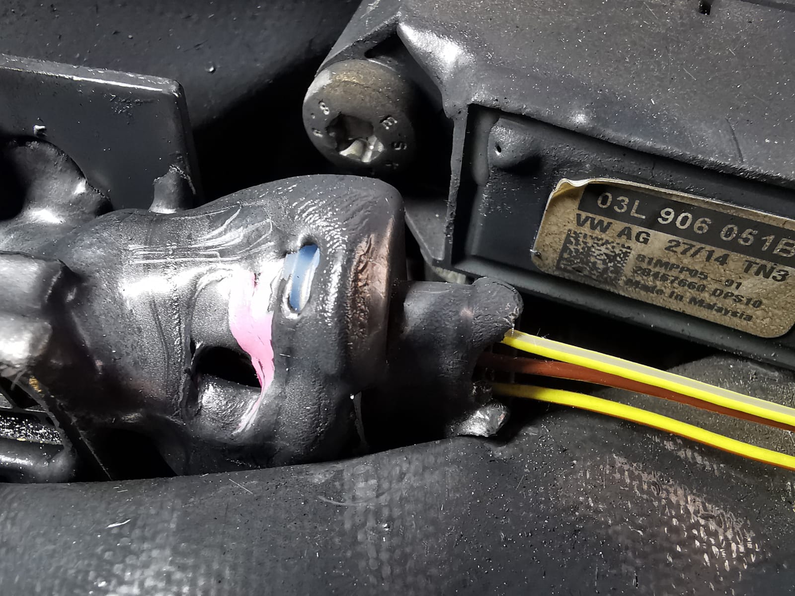

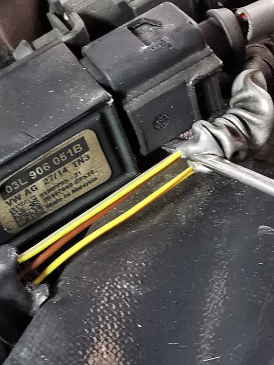

Abit late to the party but it seems when a Campbeltown is changed they rmeovee the metal pipes and iv had gloss of power etc last few days and low and behold one of the dpf garages starlight away asked what I had done and the pipe was snapped off the sensorlucky i didn't burn my car most people dont check the sensor after a Campbelt replacement
On 19/09/2019 at 22:01, micro said:
Does it have to be removed as part of the job, and maybe the hose clamps are not tight enough after re-use, allowing hot exhaust gas to bypass the sensor?
They get moved when taking the housing off for timing belt
