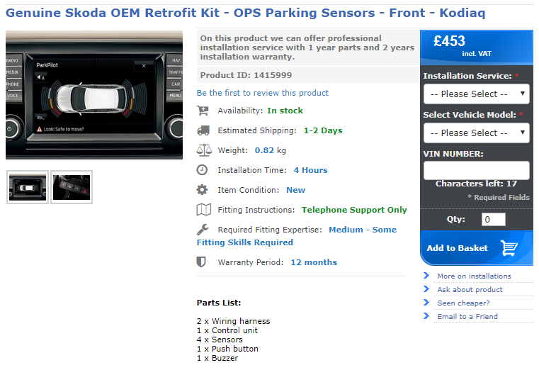

Skoda do supply a front parking sensor kit for the Kodiaq that isn't the same as factory fitted. Sounds like this is what you have had fitted.
How much were you charged? This the complete front system kit, with a rough idea on a fitted cost...

Serious I was looking at the system you have highlighted above. I think I may get Skoda to rip the one I have out and put that one in, I don't think they are keen but I let you know how I get on.
Out of curiosity, since they insist the kit they fitted is a genuine Skoda item, please ask them for the Skoda part number.
ok so they are refunding me the money for the front sensors, now I have to try and get the ones above and someone to fit them.
