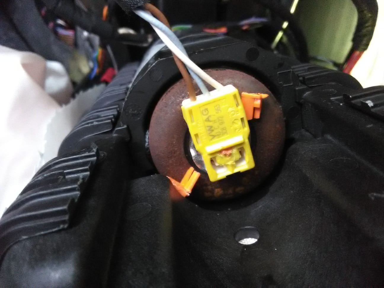

Connectors on seat belt ignitors are easily removed by lifting the orange locking latch with a small flat blade screwdriver.

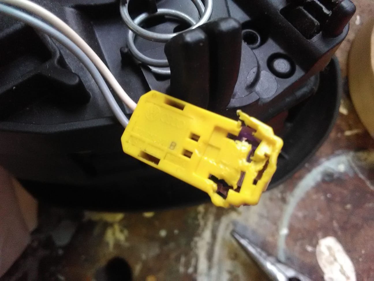

Connectors on the drivers, passengers and drivers knee airbags are all tamperproof and cannot be removed without destroying them, at the very best you might get one apart with the terminals intact but it will simply fall off a new airbag.

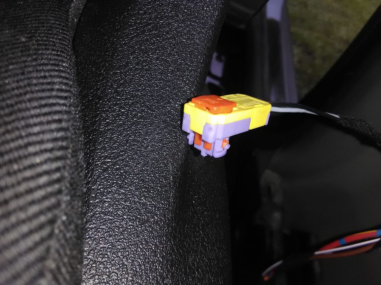

Some photos on behalf of Mr. Magoo :)
1) Destroyed airbag connector

2) Destroyed airbag connector with orange bits removed

3) Removable seatbelt connector

He thought they might have been fused by the heat of the detonation but the ones that released had small pockets for a screwdriver or pick tool to lever them up, the ones on the front airbags had nothing, it was a tamperproof locking mechanism that would break off if you tried to release it and still remain locked.
