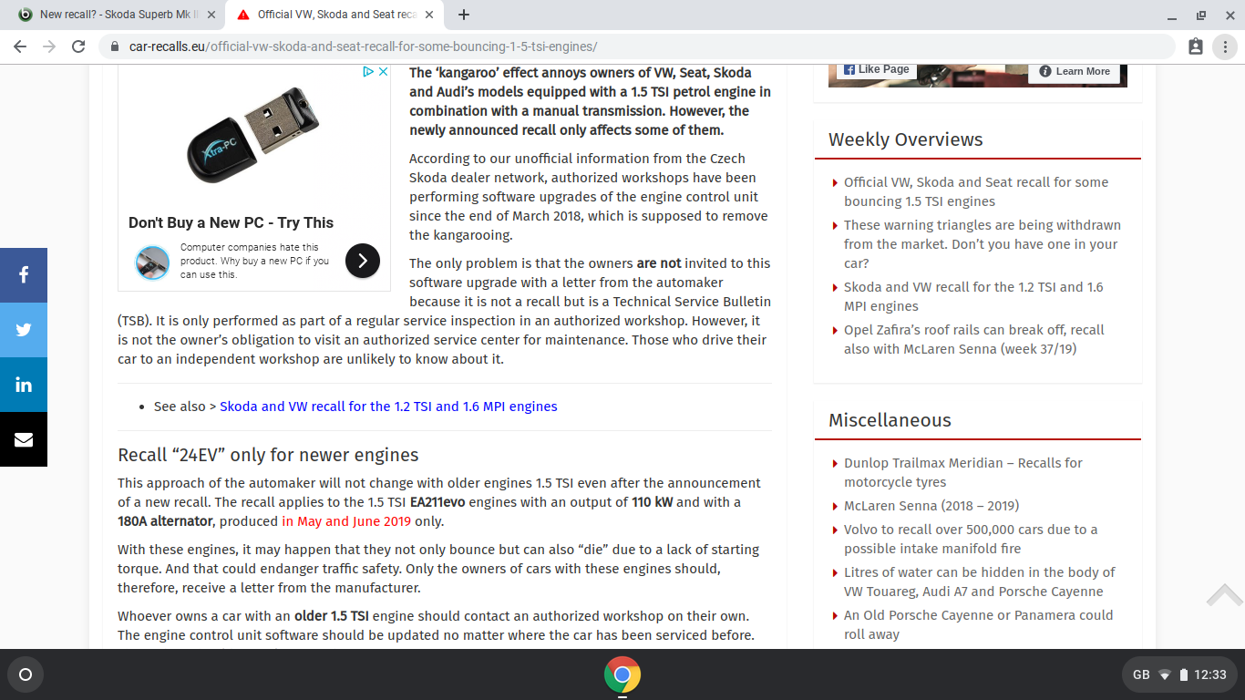

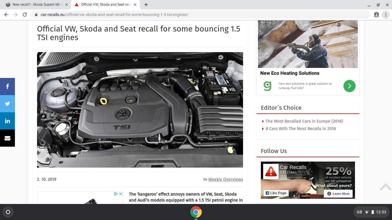

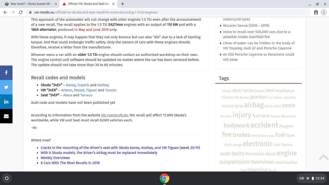

Is it a Recall or a Recall Action /Service Campaign, are you getting a letter recalling the car?
Interesting to read about the recall notification, my car is slightly older than that, first registered in March this year. However, after being in at the dealers last week for the so called "fix" it did indeed completely die yesterday evening, just after pulling away from a car park. It took me by surprise as the engine was running, car was in third or fourth gear and then suddenly it wasn't running, I managed to glide it into a lay-by , where the engine promptly restarted when I put my foot on the clutch and brake pedals to stop the car completely. I didn't stall the car, the engine just quietly snuffed itself out, not much of a fix methinks, the only issues pre-fix were with pulling away, when the car could be a bit jerky and on a few occasions the engine did conk out but only at very low speeds, immediately after pulling away. Garage couldn't find anything when they checked the car over, think it needs a return trip back there pretty soon!
