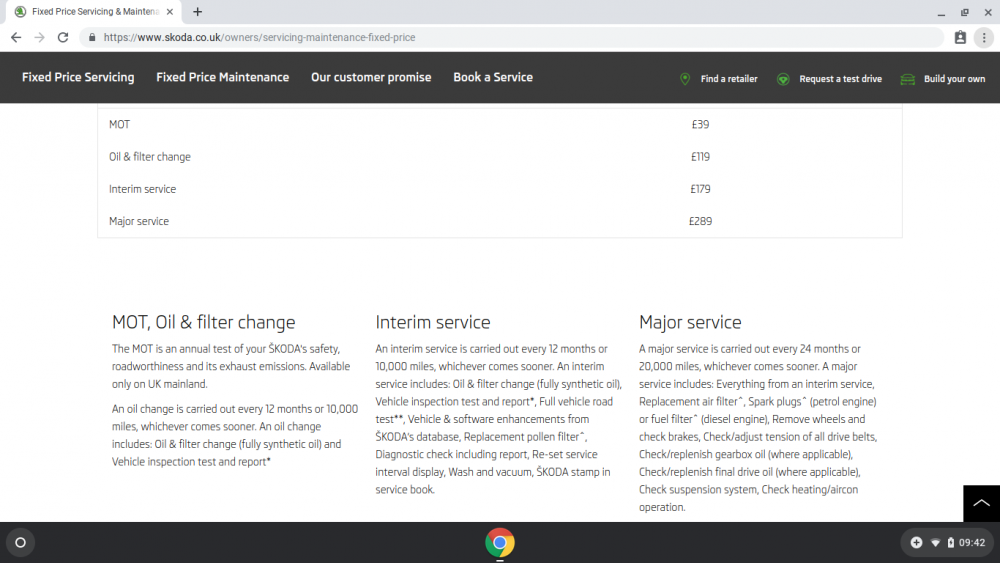

There is the Fixed Price Offer from Participating Dealership on cars 3-10 year old on Fixed Services.
To have the Service Indicator reset to Fixed Serving it is enough to have a Oil & Filter change and Health Check which is a visual inspection,
 and reset Indicator. Correctly reset, from Variable to Fixed.
Paying for a Major Service is riduculous there are no parts supplied other than the Oil / Filter and Sump Plug and maybe a pollen filter.
No Air Filter , Spark Plugs or Fuel filter suppied.
The Wheels are not being taken off.
*If the wheels have never been off since fitted at the factory i would check before winter that they will actually easily come off if there was a puncture.*
**Brake fluid change due at 3 years and then each 2 years, i would want this on a low annual mileage car, or at least the brake fluid H20 content tested.
Brake Fluid change offer is £60 while a service is being done.**
The only servicing that should be paid for is what the car needs, Preventitive Servicing.
Body Inspection as well for the Paint Corrosion Warranty.
