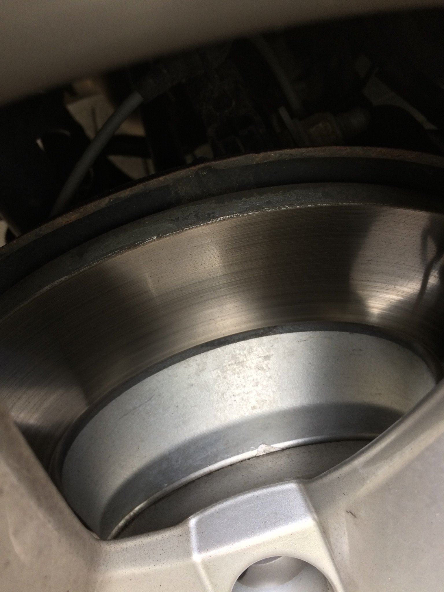

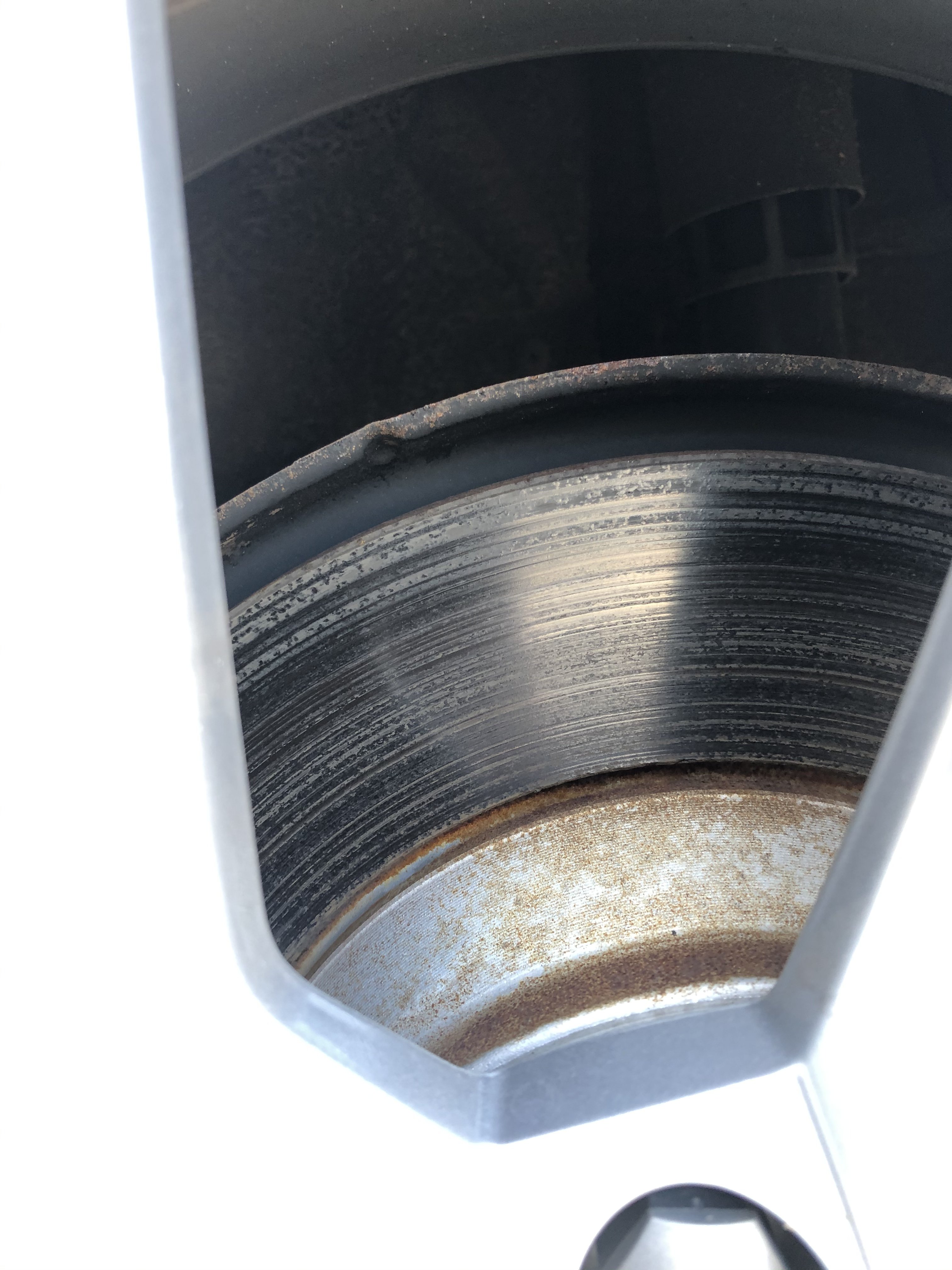

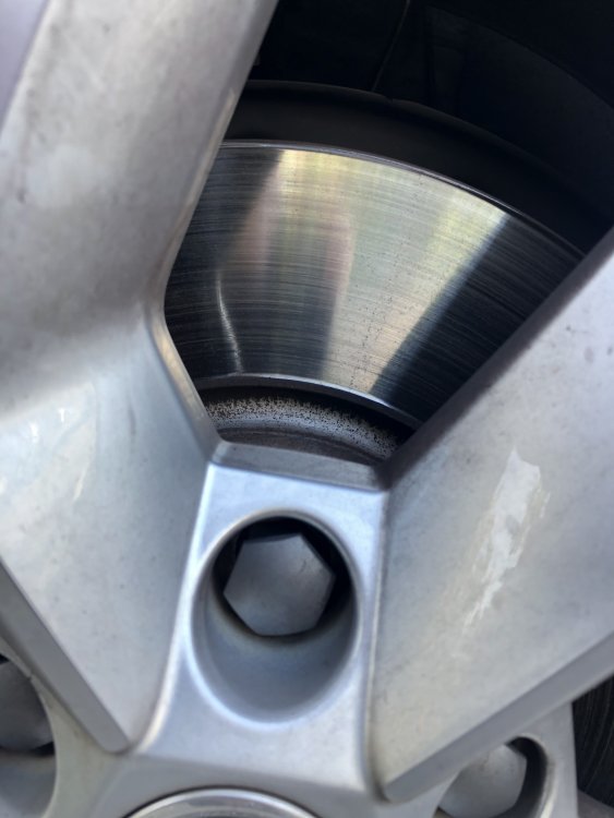

This is back and front Simon, it’s a bit difficult to tell off this, but as you can see there is a difference between back & front Discs

Your discs look fine (not perfect by any means but acceptable none the less).
If you are really bothered about it a decent machine shop would skim them for you, by the look of them they wouldn't need much taken off to clean them up.
Many garages try that gouging trick to get some extra money out of you. AC do it on every service "sorry to tell you Sir but can you please bend over so we can fleece you for some new brakes" (or tyres is another good one that they try often) to replace your old ones that there's nothing much wrong with.
Maybe use your brakes abit more frequently/harder, helps keep them clean. A good way to do this is instead of gradually easing down from 60/70mph to town limits is to smartly bring the cars speed down by using the brakes. As has already been said, modern disc brakes need to be used often.
