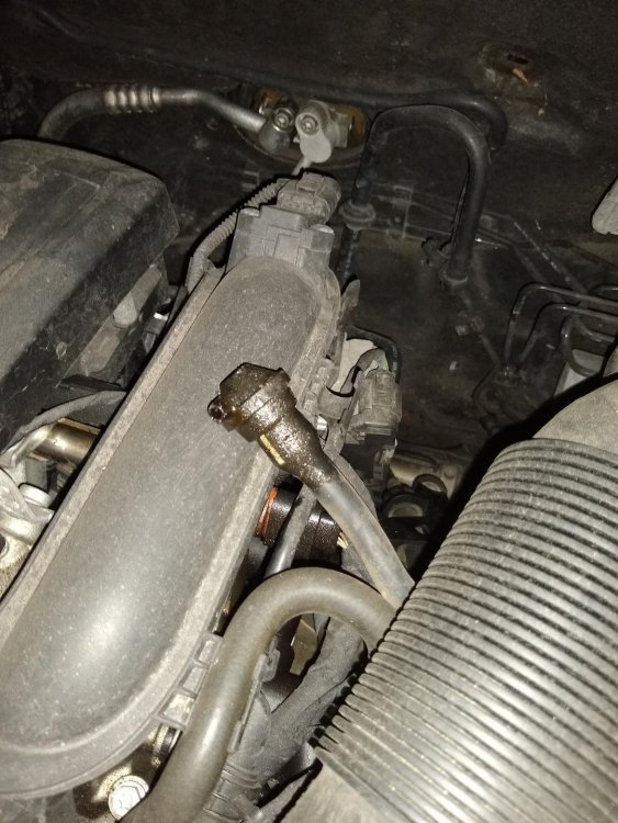

We have a 1.2 2014 Roomster. For a week or so we've had a petrol smell coming into the cabin when the car isn't moving. I've just had a look and this pipe is loose.
I think I can see the hole where the bit coming out of the side is supposed to go. Does it just push back in or has something snapped off?
We're supposed to be driving the boy from Bristol to Bournemouth tomorrow. It's not caused a problem yet but do we need it fixed first before we drive it?

A bit has broken off, and you don't want to push that bit into the engine by trying to reattach that photographed bit.

This is the PCV valve and brakes easily. It senses the pressure on the cylinder head (if i remember well). It is quiet cheap and easy job. This is the part number
PCV valve (Ventil) : 030103175B
Please take a look in my case as it is the same. A few moths ago I had to replace it again.
I serviced my car this weekend, and was not surprised to find a broken off PCV valve. I stripped a welding rod of it's coating and bent it to a 2-3mm 90 degree hook in the end, which made it possible to remove the left over piece of the valve from the valve cover.
