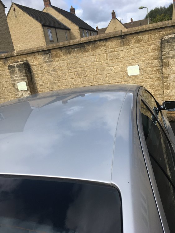

Hi all .... I’m needing to use my car for work and carry a ladder.... basically I need a roof rack but....... I have no roof rails or anywhere to fit one......
   advice I need
A ..... can a roof rack be fitted
B ......if so what do people recommend?
Many thx

But there is nothing at all on my roof for fitting anything to, non of the plastic strips that hide where roof rails are fitted ??? Just a bare metal roof ... are rails generally screwed into the roof?
   Many thx
   Many thx
No. see links and video posted by others.
There is a thule footpack which has a stepped rubber insert to fit on top of the roof profile. You also get some foils (clear plastic transfers) to stick under the foot.
If it is like the mk5 golf there is also a threaded hole to allow a pin to locate on the underside of the door aperture but it was only on the front two mounts on the mk5. The arrangement really works on clamping pressure.  Downside as far as the racks and foot packs go was a bit more wind noise and they can let the odd drip of water in around the door seal where fitted.

7 minutes ago, StickyMicky said:
Take a look at the video below; this is for Thule feet but the same principle applied to most direct-fit roof bars.
Ahhhhh I see ..... many many thx for that .... I was clicking the links on a previous post but the pdf would load to see how they fitted ..... very simple ..... thankyou again
