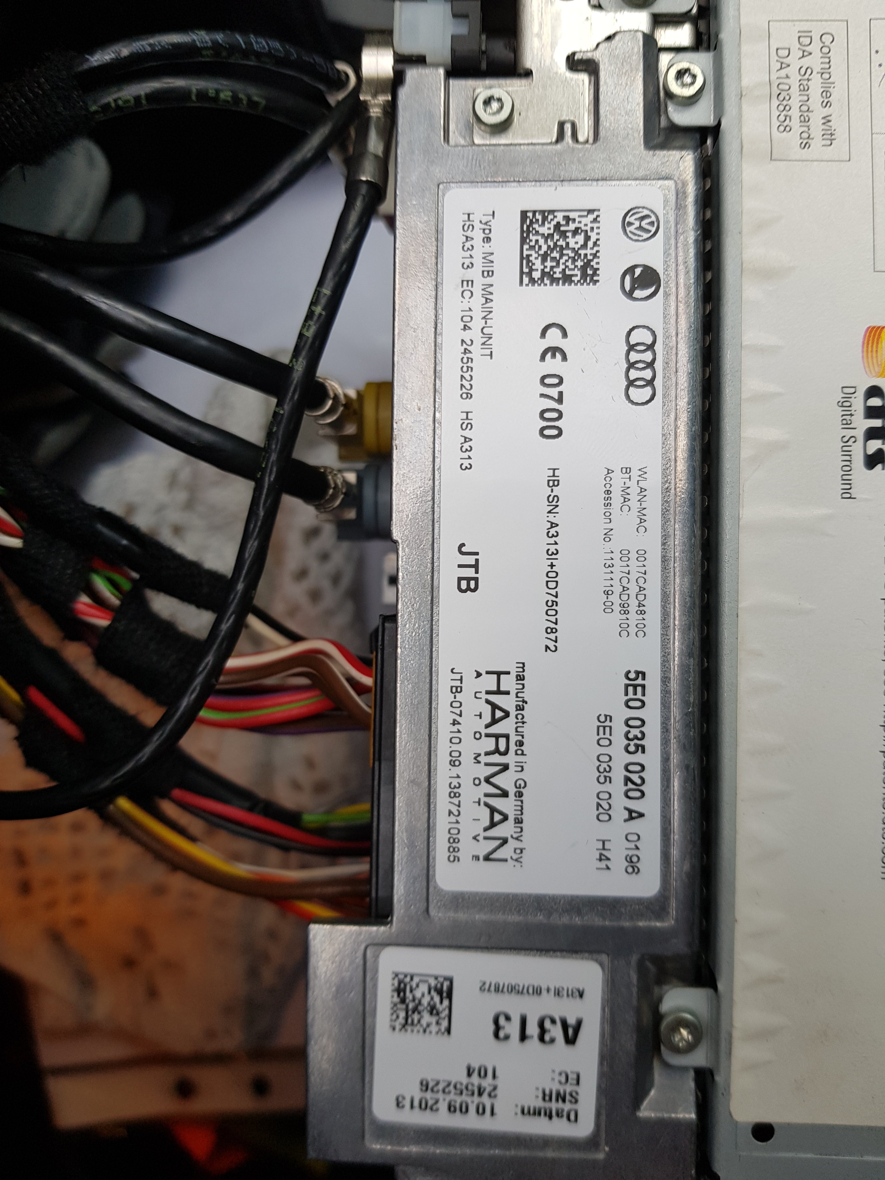

That’s a MIB1 Columbus. Have a chat with Pawel Pab567 on here as he his the MIB whisperer but you may be looking at a replacement unit anyway but much cheaper than the dealer.

That’s an Amundsen, the OP has a Columbus which does not have cross compatible parts
Could ask @Rustynuts as he is a wiz on these units

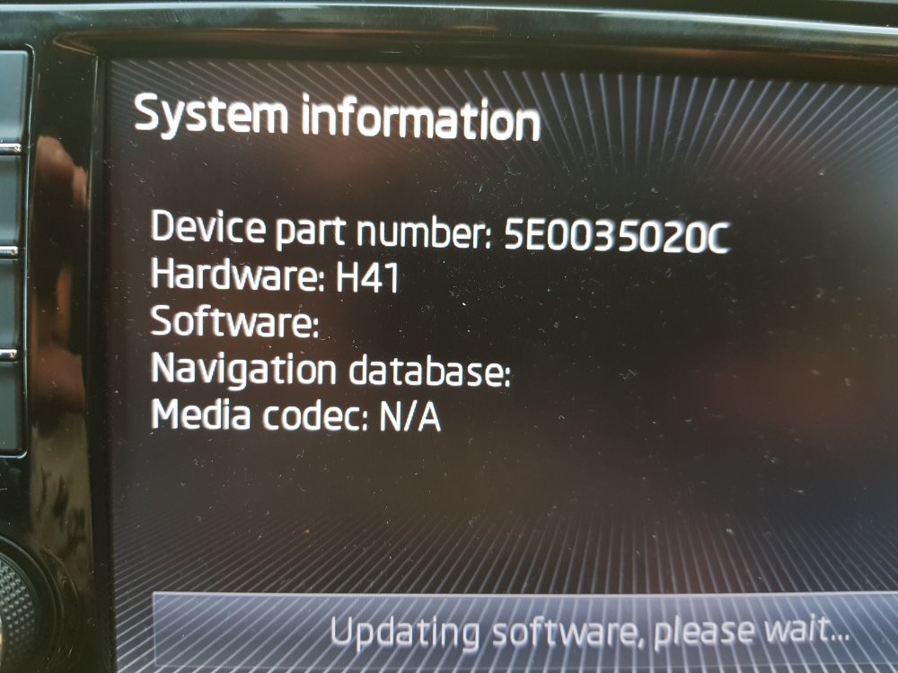

Update : i got it back from the repair shop. Still no sound. It is in mute state( dosent allow to turn up the volume at all, sat nav is dissableb. Everything sound related dosent work. So heres the question. Do i pay x amount of money and try to get it coded and try to update firmware and hope the fix worked. Or do i order the replacment from ebay and get the new unit coded.

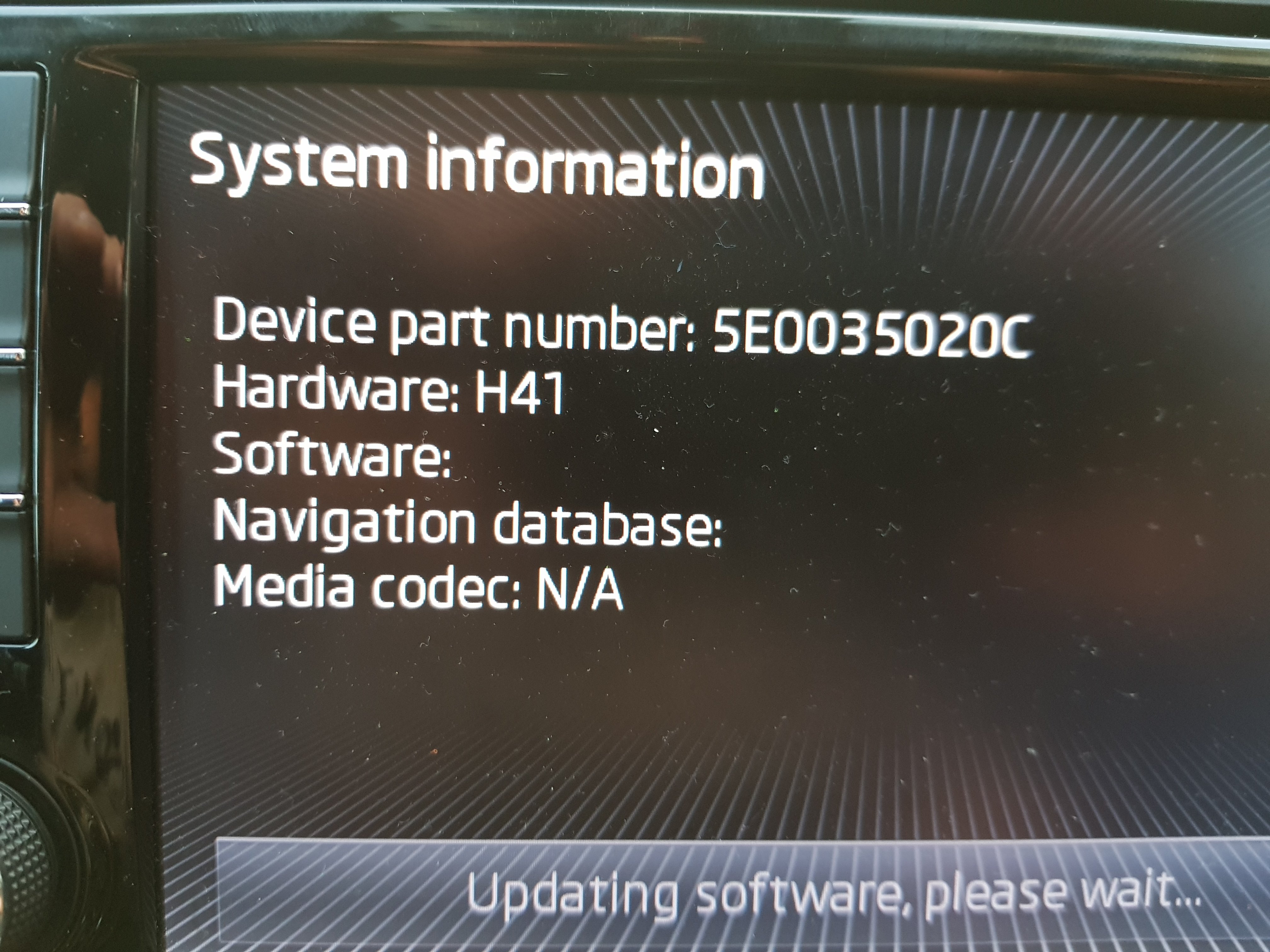

Sound problems are typical issues in MIB1. First action is to upgrade frimware (pls post a picture showing current SW version), if it doesn't help then next step is to resolder power amplifier chips and if still no change then replacement of power amplifier chips.

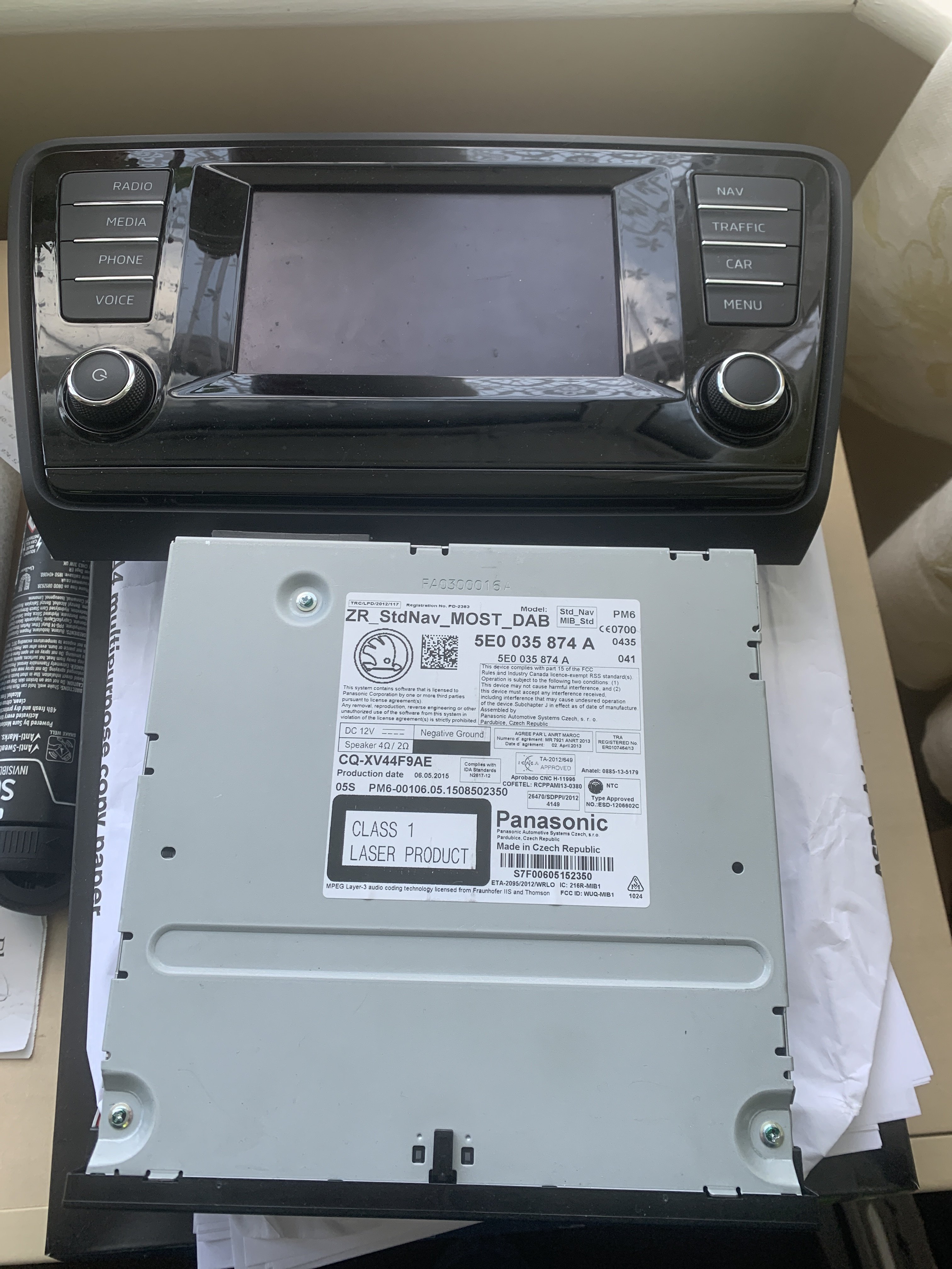

well the unit isnt connected to the  car at the moment, i have a ghetto setup instead (regular 1 din radio). Software picture is second one in the 2 pictures i have here. if i remember correctly the skoda dealer somehow messed it up and it didnt show any number(firmare number) at all. i got it the unit back from the repair shop. now im just waiting to get it updated. if you have a software link that i can dowload and try it myself then we will find out if the soldering worked or not.
