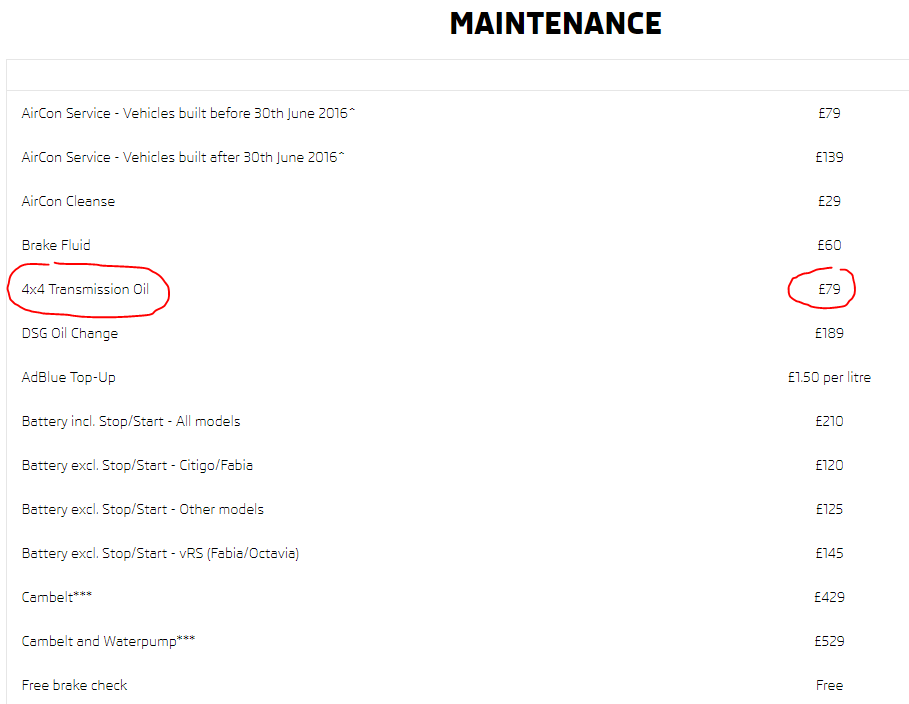

Not sure if it's really worth shopping around?
https://www.skoda.co.uk/owners/servicing-maintenance-fixed-price
Heh, Arnold Clark Skoda in Inverness just quoted me £213.61 to do this job. That included 1.5 hours labour at £95 + VAT per hour.
My local independent garage said it would take them 30 minutes to an hour and they charge £55 + VAT per hour.
Parts is another £35 + VAT on top or thereabouts.
I'd not come across Skoda's Fixed Price Maintenance before but if Arnold Clark are obliged to do the job for a fixed price of £79 including VAT, which is what the web page implies, then they're living up to their nickname of Arnold Shark ...
Skoda's T&C's specifically state for cars 3 years old or older, but my local dealer will honour these prices on newer cars.
The other caveat is "only at participating dealers", which I guess means dealers are free to choose whether they offer these prices or not. Bit of a cop out really, but it is at least a sure fire acid test to weed out the crappy dealers i.e. those that don't adhere to the fixed pricing.
I've just checked with Skoda and they are participating dealers. My car is about 10 days under three years old, so perhaps they're relying on that but I'll be phoning them up to shout at them.
I've never had the pleasure of using Arnold Clark, but I have read a lot of worrying feedback around their shenanigans over the years.
Good luck!
