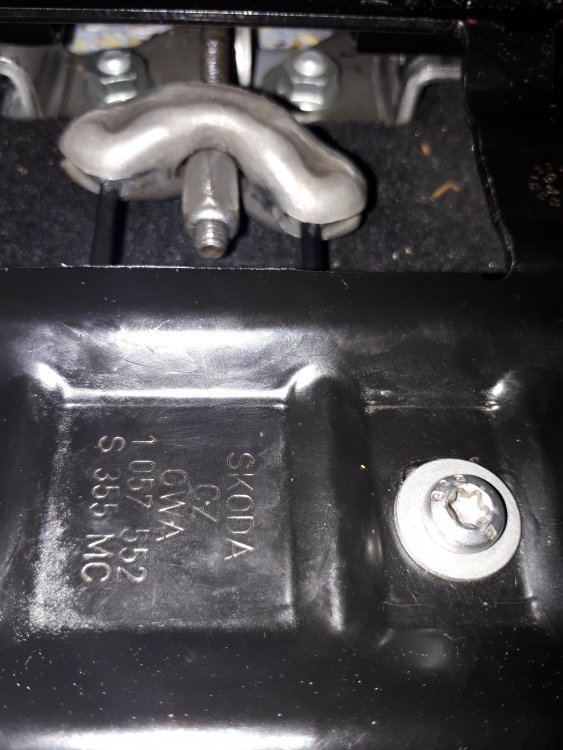

Ave noticed the equaliser on the hand brake is pulling more on the right side here's a picture to show more of what a mean.20191013_204351.thumb.jpg.0cf4ac8e4ab184f2738f782080cc3256.jpg

A squinty equaliser is evidence that the cables aren't equal length and that's all.

You can see clearly in the picture that the drivers side is now fully releasing (pulling the cable back).

Sorry a forgot to say the photo is the hand brake pulled on
Well so far so good fitted 2 new handbrake cables the equaliser is pulling even now nice and straight both brakes are releasing equal.
