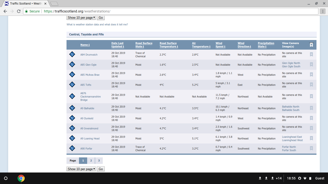

Forecast is another De-icer morning tomorrow, but then again maybe not, temp might rise after it falls..
Edited by Roottootemoot
18 minutes ago, Roottootemoot said:
Sound advice from North Dorset.
Yes, I have a weather station on the roof to help me with my local weather predictions.
Thanks AG Falco
Good up there for Santa's sleigh but not much good for getting the ground or air temp.
I live in a low rise Indian House so not that high.
No Stevensons screen up there though.
The back garden is well sheltered from the wind.
Looking at the weather station history helps as well.
Thanks AG Falco

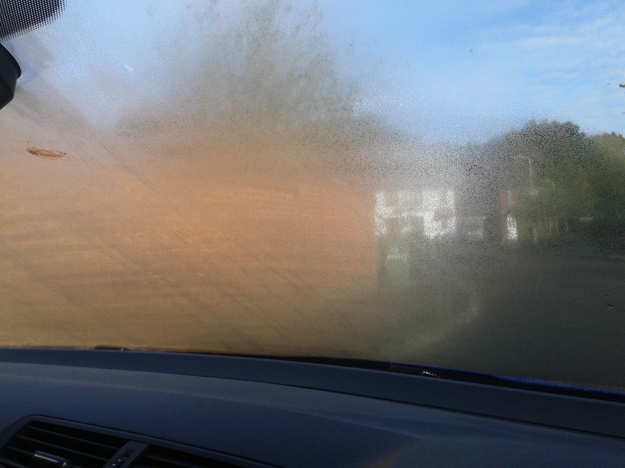

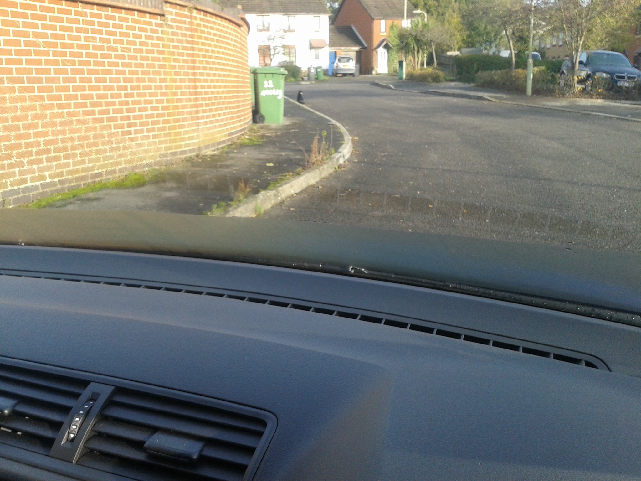

Left for 3 days (wiped out with a ****ty cold....)
Car was good when i left it Saturday, didn't feel damp in the air. I drove it to get food supplies, didn't fog up at any point. Heater / aircon on all the way.
It seems when it rains it makes the problem a lot worse, like water is settling in the air vents somewhere? We had a bit of rain over the last few days.
Anyway the Karcher window vac clears it up, just can't get to the bottom bit with the attached squeegee.
Pain in the arse, I'm sure the mk2 wasn't this bad.
They've messed up really with the roof shape with these, well water drainage anyway. Water just pours off the roof straight into the cabin, usually on the edge of the seat.
Will have to get into the habit of clearing the roof off on the drivers side before opening the door...
Left the windows cracked open a bit today as its sunny at the moment, hopefully the cabin will warm up a bit and the humid air will escape.
