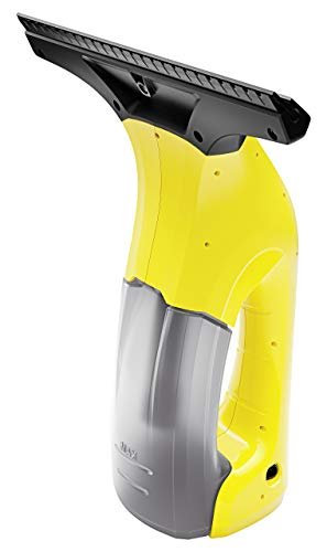

Unbelievable amount of condensation this morning on the front window... I had to go back into the house and grab the window VAC to clear it up. Still left me with a strip across the bottom where the squeegee wouldn't get at.

The Window Vac saved the day this morning, it was that bad...
