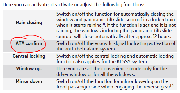

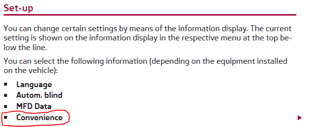

Nowhere do I get the option to control any of the settings in your image, which is on page 20 of my manual too thanks. 😊
At a guess, you should read the previous page of the manual.
I believe you need to press and hold the buttons on the end of the wiper stick to get back to the main menu. From there, you should be able to get to settings etc.
Page 19. Press the A button for more than 1 sec, nothing happens 😬

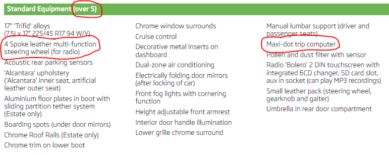

Maxidot is standard from the SE up, so you're right, no Maxidot on the 'S' trim.
No buttons on the steering wheel = no Maxidot...
Edited by silver1011
Thank you! Yes I have no buttons on the steering wheel 🙃
