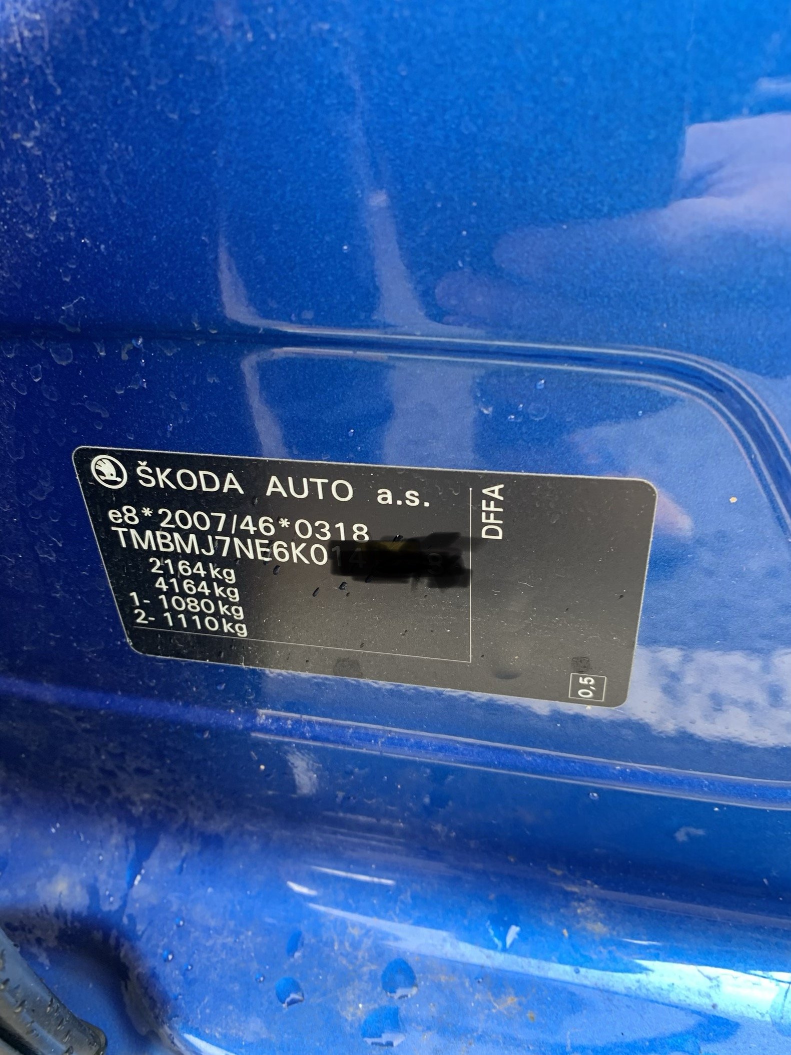

it is bizarre though, as if I would have purchased this vehicle second hand how would I ever have known? If it is the case that it would be illegal to fit one, why is there a train weight of the manufacturers plate?
Just have a look at the weight plate on the car.
If it does not have a GTW (Gross Train Weight) then it is not homologated for towing.
The second weight is GTW
Edited by logiclee
This is mine.
1 minute ago, Al47999 said:
This is mine.
Then it must be homologated for towing, if it was not it would not be able to display a GTW.
Very occasionally manufacturers will change a bumper or exhaust which will mean their type approved towbar cannot fit which is another issue.
