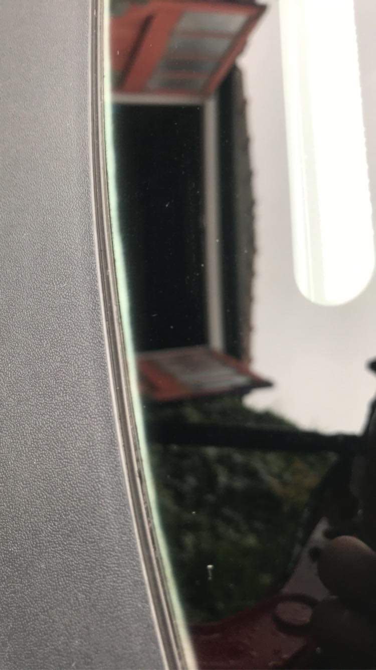

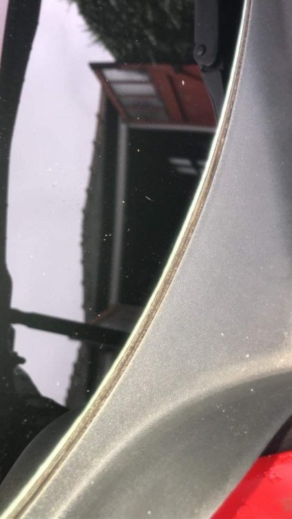

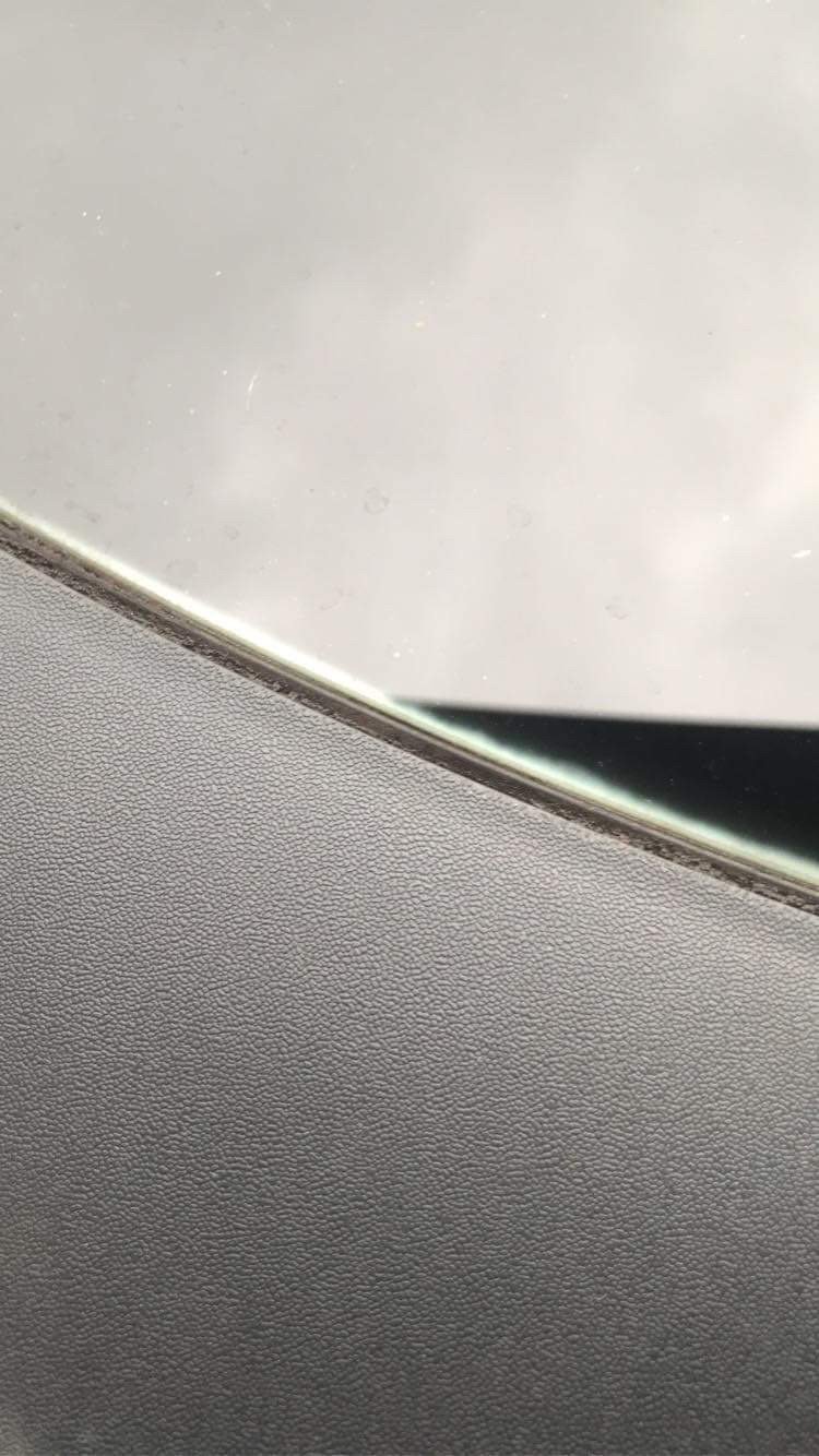

Just giving the old girl a clean and noticed what looks like the milky beginnings of a delaminating windscreen....
Anyone else had a prob ?
Is it the original windscreen, fitted at the factory?
I had something similar on my 2008 MkII Octavia (original windscreen), it got similar to yours then didn't change / get worse during the 8 years we had the car.

Interesting … Cars still under warranty until October next year ( 5 years old ). So what to do.... I may end up keeping this car for another 5 years so if it's going to stay like it is now I can live with that.... But will it ? Then we have the associated problems with a replacement windscreen... < sigh >

I'd wait until the next service, ask them to check it out, and if they say there isn't anything they can do, ask them to make a log of it on the cars service records.
Then, if it does get worse, but only after the warranty has expired, you at least have some evidence to try and get some goodwill out of the dealer and/or Skoda UK.

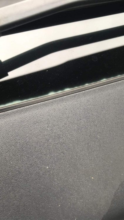

Interesting article on the subject here
But it sounds like you need a lot of delamination before it becomes a risk/replaceable:
"‘Edge delamination of laminated glass with polyvinyl butyral (pvb) interlayers is known to occur in situations where there has been poor quality control during manufacture, specification and installation. It has also been demonstrated through actual blast-tests that edge delamination has a detrimental effect on the blastresistance of bonded laminated glass. Delamination of the laminated glass appreciably reduces the blast resistance of the glass if it extends more than 8mm from the edge, and if it extends along more than 25% of the total perimeter."
i'll have a read. Yeah I had one going on a TVR years ago. That was pretty bad but seemed to stop after a certain point. That car was gararged all the time. I wonder if it makes a difference if the car is on the drive exposed to varying temps ? It's not bothering me but my logic is I would rather have it replaced free under warranty than 5 years down the line where I would have to pay and there maybe more associated costs because of fancy sensors etc.
