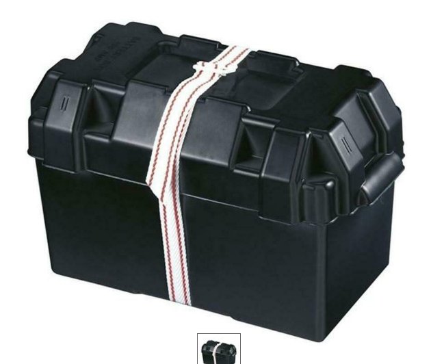

So was the first battery gubbed, or do you have it still and does it hold a charge?
Often over the years i have just had a spare battery in the boot / back of van in a box with a rope to carry it, and jump leads.
(Old wooden box my dad had when i was a boy and he used for the caravan leisure battery.)
It starts cars, stays charged, can get charged occasionally. and saves me opening my bonnet and jumping others cars from mine.

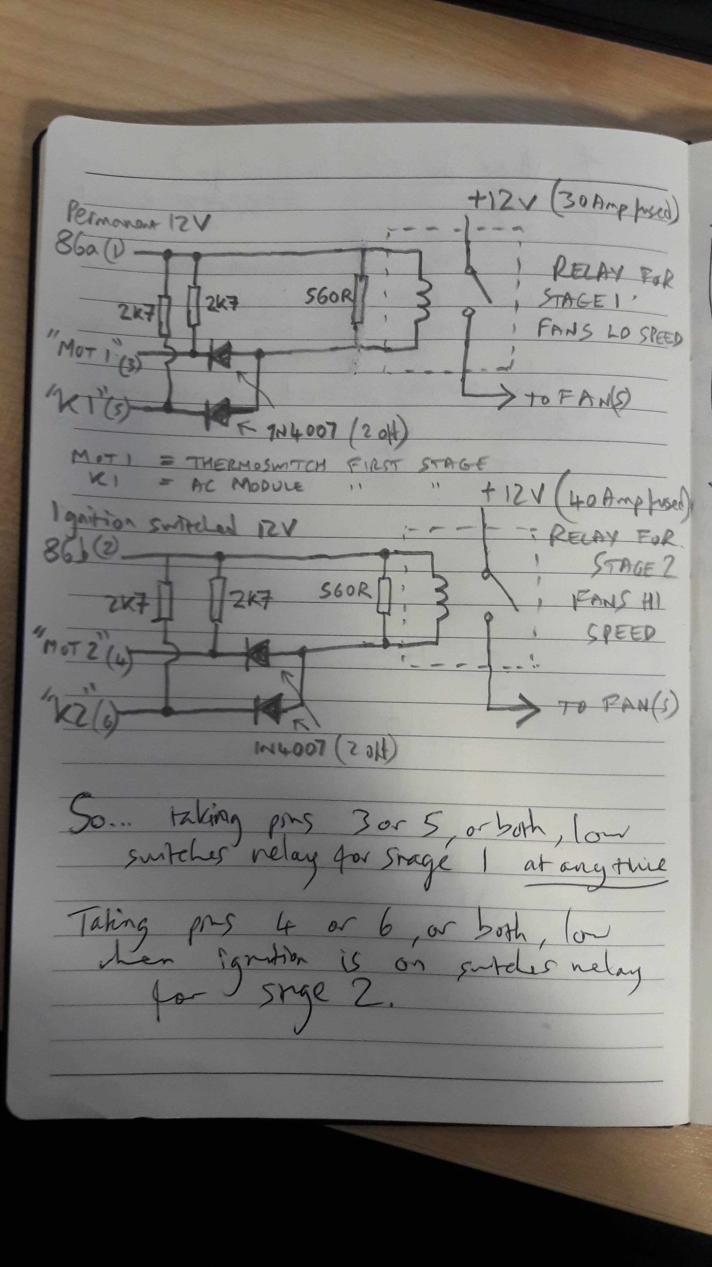

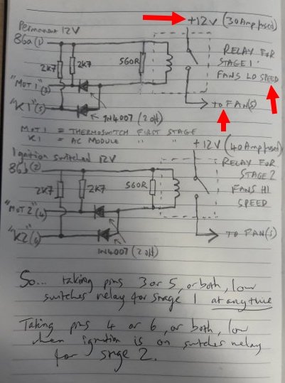

Are you 100% sure that the fan was running at high speed?
It's much more difficult for that to happen if the key isn't in the ignition because the coil of the 'high speed' relay that switches the permanent 12V supply to the fan is fed from an ignition 12V source. This means that with ignition off, no possible combination of high refrigerant pressure or high coolant temperature nor any wiring fault on those inputs should be able to trigger the relay.
Having dissected one of the fan control modules that I believe to be identical to yours, the internal circuitry is as sketched (badly) here. The lower relay is the one that does high speed fan action.  The upper one, with coil fed from a permanent 12V source, is much more easily imagined to be involved in unexpected fan action (but low speed), if for example the 'MOT1' or 'K1' wire had an intermittent short to chassis.

"no possible combination of high refrigerant pressure or high coolant temperature nor any wiring fault on those inputs should be able to trigger the relay."
i can confirm the key was not in the ignition...i never leave it in as the garage and house keys are on the car key fob
could this mean or the low fan relay sticking??
this common occurrence which may be relevant is if the fan is running on and i lift the bonnet to look and then let it drop  with a bang....the fan stops!!...this has been for 3 or 4 times....but over 2 1/2 years....? perhaps this impact on is unsticking the low fan relay..if it is that
but usually then i disconnect the battery negative since i take it as a warning that the fan may start up again...when i am in bed and then a battery charge is needed.

I think more likely the low speed relay getting dodgy inputs via a wiring issue.
If the relay contacts were sticking it couldn't really explain that on/off/on/off event you described, I don't think.
T'is  a strange one.
