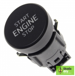

Anyway, it's an easy swap (if you're not under warranty).  Pop off the steering column lower trim (one screw), unplug the button, gently release the clips and the button slips right out the front.  No coding required.
Paid approx $110 AUD (that's about 20 pence in real money) at a dealer for the part.  The dealer's parts guy confirmed that he'd been replacing a lot of the older revision buttons under warranty.
The part number was  3T0905217C but you'd wanna make doubly sure that also fits the Kodiaq before you procure it.  It should be written on the button somewhere.

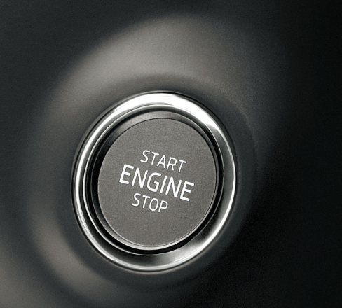

I'm guessing you're referring to this one...

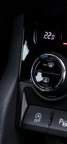

...and not this one...
If so, then as suggested above it is a common issue across a number of  Skoda models, including the Kodiaq.
Your dealer should be well versed at what to do, which is essentially swap it out for a revised version...
Thanks Silver1011, yes it is the former. I assume it will be covered by warranty? I have booked the car in with my Skoda dealer for Monday. Hopefully they will know what to do and just swap it out. It does ‘feel’ to me like it would be a bad/faulty micro switch which I assume is part of the component you have shown above. Thanks again, Andrew
Yes, I'm pretty sure Skoda issued a TPI (Technical Product Information), which is essentially a communication from Skoda UK to their dealer network detailing rectification work needed for common faults. These aren't the same as recalls (safety related), and only come into action if your car is processed via a dealer i.e. routine servicing and they run a check for outstanding actions (TPI's).
Given how common the issue is I'll be amazed if your dealer doesn't bat an eyelid when you drop it off, they'll have replaced plenty already.
