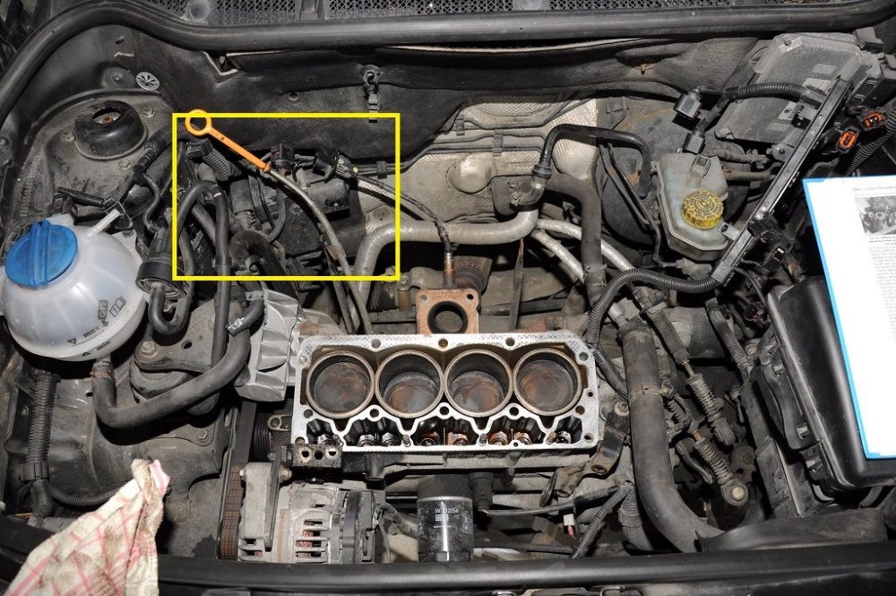

1 hour ago, sepulchrave said:
The ABS block is always on the left side, hence right rear first I guess.
It's on the opposite side on a left hand drive vehicle.

^ Ah, there goes that theory...😆
