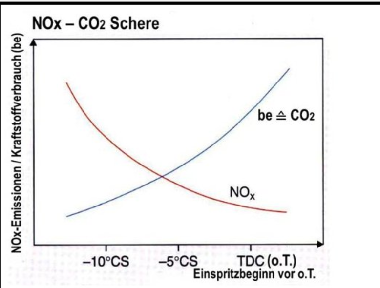

He also showed me this graph, which he considered kind of proof that it works, because soot and nox is opposite dependant on eachother. And the egr valve in function is to reduce nox, and therefore creates more soot - and when you then make egr off you will raise the nox, but lower the soot. Im really relly confused. If my dpf behaves like normal with 400 miles between regen, i will do the egr off, but if it gets the dpf to act up, i will not do it.

The graph in the OP's post shows the relationship between injection timing and formation of CO2 and NOx (relative to fuel consumption). Earlier injection means more complete combustion of the fuel, lowering CO2 production per litre of fuel used. The more extreme temperatures and pressures reached during this complete combustion increases NOx. It has nothing to do with EGR or DPF functionality.
