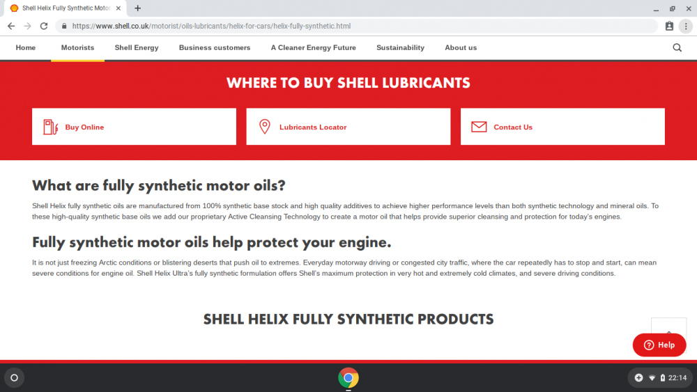

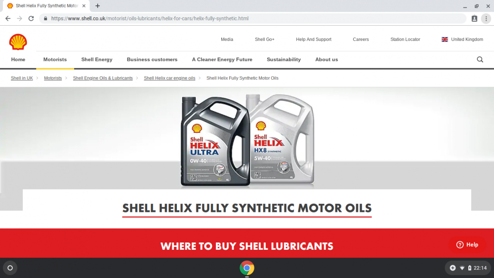

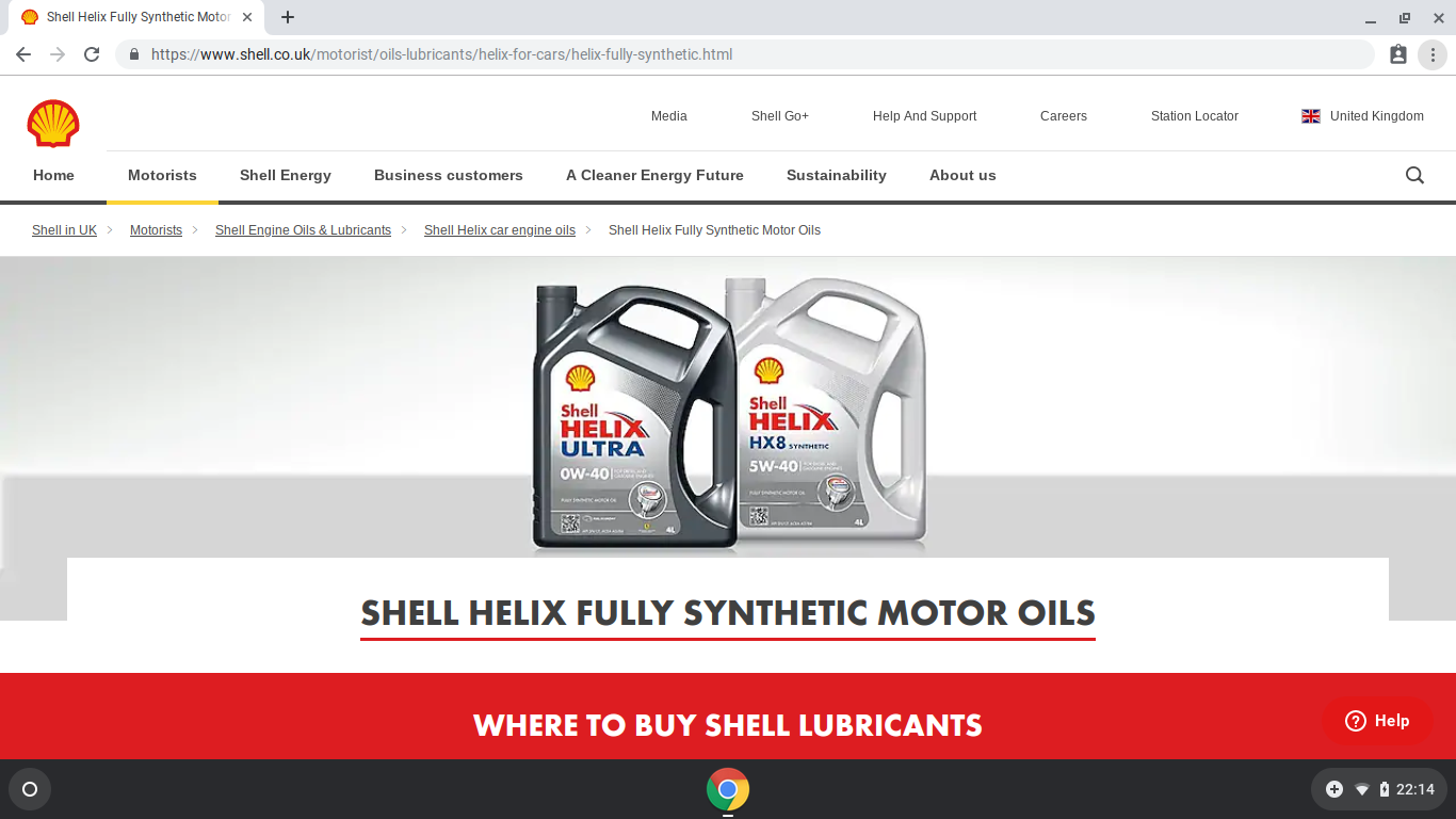

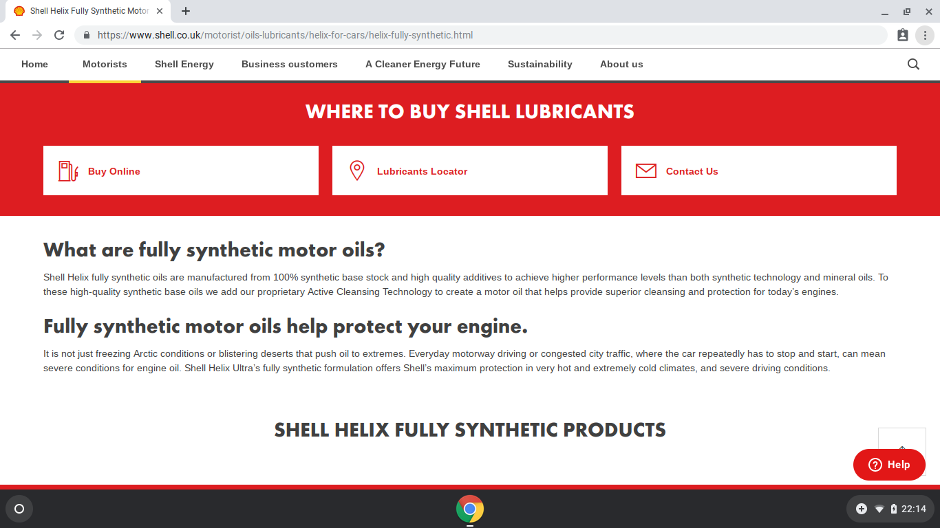

Exactly...  i want the best for the job.   But which 502?  lol
The Shell website doesn't explain the difference 😕

They are not going to explain why one might be better than the other because they want both to sell and soe will just assume the more expensive is better.
