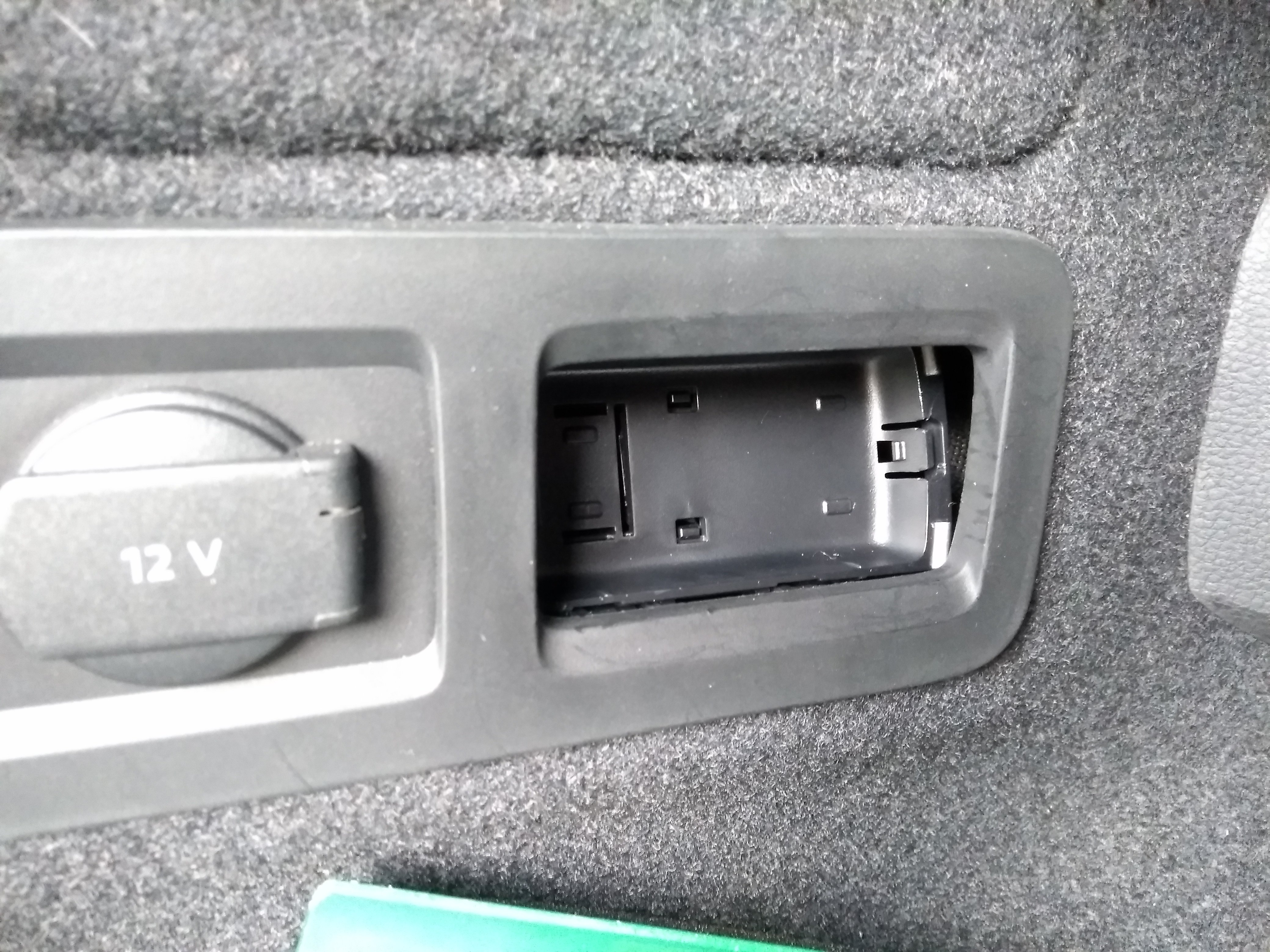

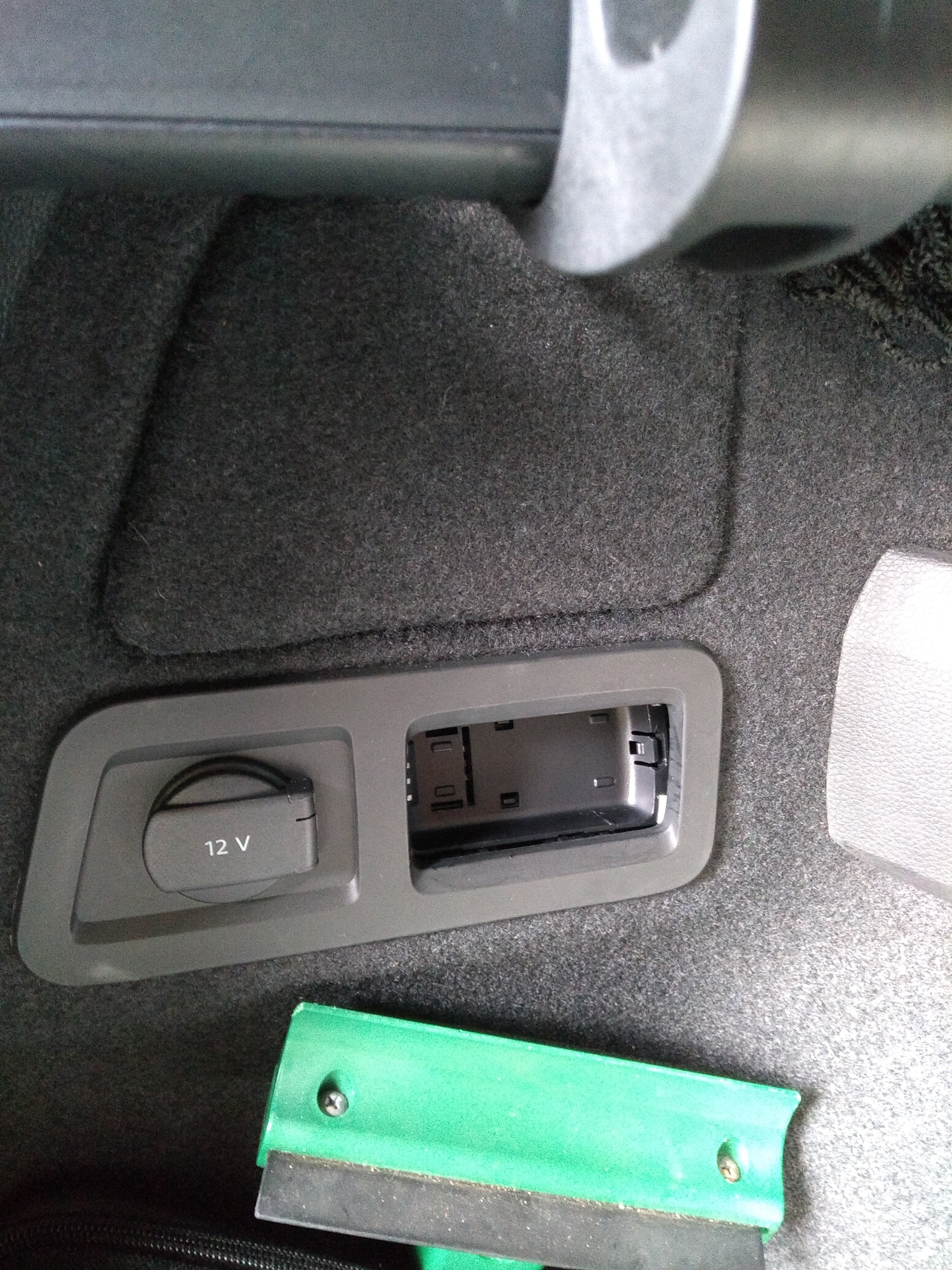

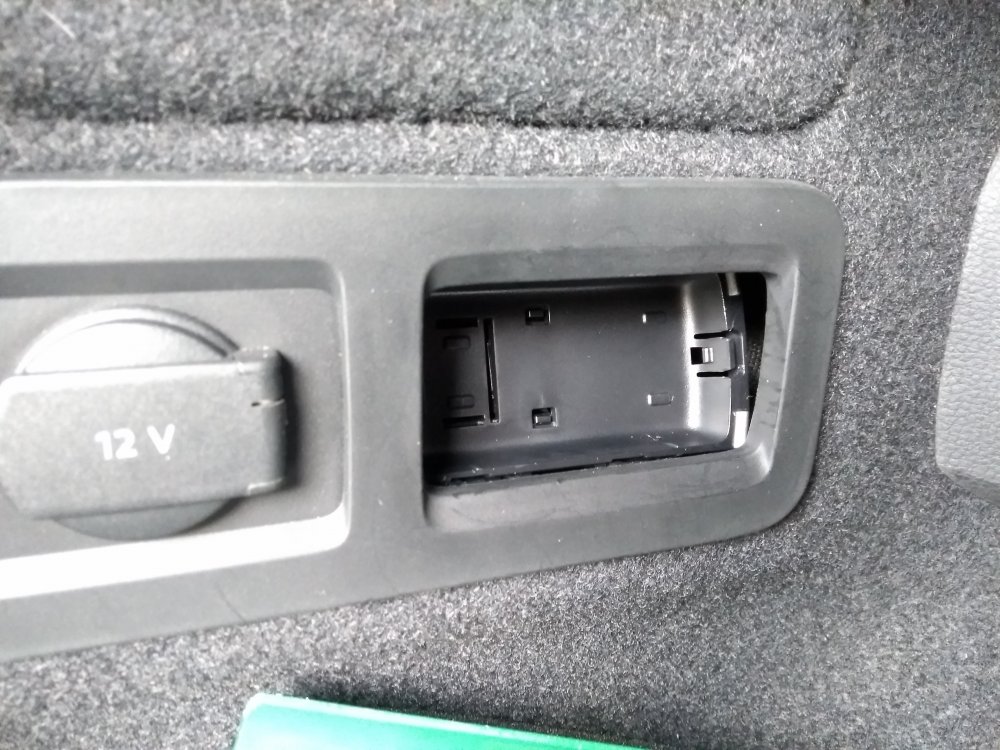

Last night I needed my torch out and when I put it back it seems to have broken or pushed the top bit of plastic insert away and in towards the car.
I have just had to prize the torch out with a small screwdriver.
There seems to be a hatch cover above but I am not sure how to open it?
As I don't want to do more damage anyone know how to open it so I can see if I can push plastic fitting back into place. All seems a tad flimsy...
Attached photos for help explaining my dilemma...

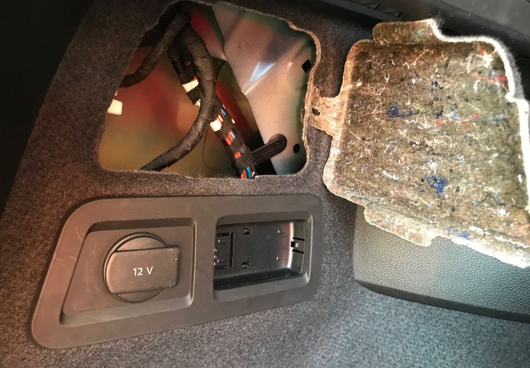

You can push your fingers into the fabric hatch thingy and it can be pulled out or it might be hinged, it's quite flexi and I doubt you could damage it and then push the torch holder back into place......

Hmmm had a crack at getting it sorted but top plastic fitting does not want to hold it properly. The little door opened easily enough so that meant I could get fingers in to push it back. So thanks for that photo.
So better than it was but not properly fixed and I think it was like that from start. I will see if I can get dealer to sort it under warranty.
