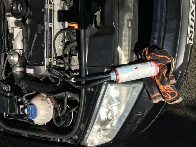

I did my brake job over the weekend and also ran a can of liqui moly diesel purge through the engine. After a few gentle miles getting the new pads n discs bedded in and the engine warmed up I opened the throttle a bit on a fast ‘A’ road.
What issue prompted use of this product? Just read the literature with product. It is designed to kill off.microbe growth in any water at bottom of fuel tank.

I’ve given the car a full service oil and all filters.  Plus the brake refresh. The liqui moly was aimed at ensuring the injectors were cleaned.
The engine was starting and running sweet prior to the liqui moly and continues to start and run sweetly following the treatment.
This juddering and boost issue is new...Although manifesting itself after the treatment....

It’s was preventative... I fed the liqui moly direct from the can into the engine not via the fuel filter. Which is new with less than 500k of running time...
Fuel injection pressure on a PD is so high that injector clogging isn't normally possible, however bypassing the fuel filter is extremely unwise since there may be particles in the snake oil which would otherwise be trapped in the filter which have now actually clogged the injectors.
I think you may have made a serious mistake, injector cleaning on PD and CR engines is simply not necessary because the fuel itself already contains cleaning additives and injection pressures of thousands of bar flush the pintle clean with every injection cycle.
