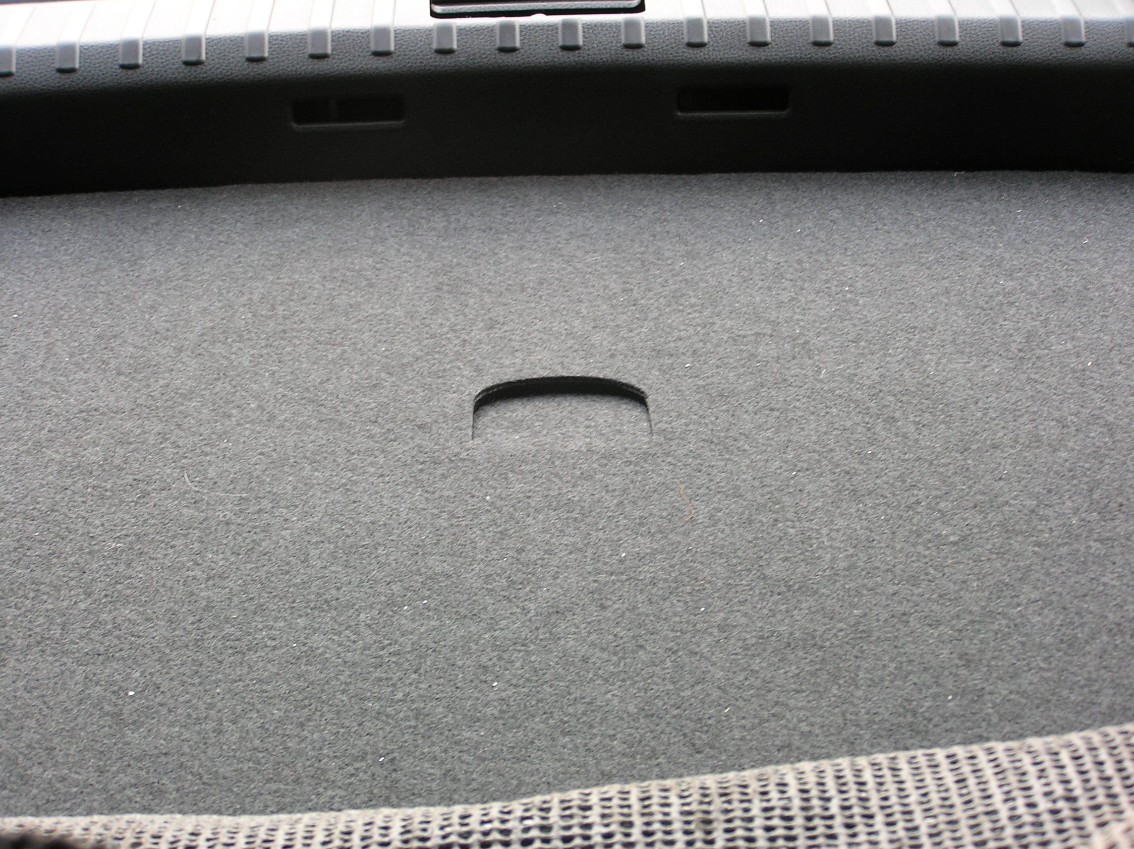

I'm waiting on my completely standard Karoq to be built but i'm wondering now if I should have ordered it with a spare wheel.
I would like to know how a standard Karoq looks under the boot floor. Does it have all the support/ storage for a wheel & jack? Can I just buy them off ebay or similar and add it later on? According to my order it comes with 'Storage on wheel cover' whatever that means.

All Karoq's get a spare wheel well, but depending on their configuration depends on what it's filled with.
Without the spare wheel option your wheel well will be set up for storage, an empty polystyrene bowl.

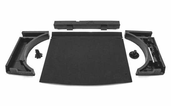

Too fit a spare wheel securely you'll need the plastic threaded bar and securing nut ( the recepticle for the threaded bar is still there even on models that left the factory without a spare wheel), plus the reshaped polystyrene parts to surround the spare wheel and to house the jack, wheel brace, locking wheel nut key, wheel bolt cap removal tweezers etc.
As mentioned above all this is available in the UK from any franchised Skoda retailer.
Here is an image...
The part number to order is here...
https://eshop.skoda-auto.com/cz/en/b2c/set-for-spare-wheel-karoq-57a093860ax

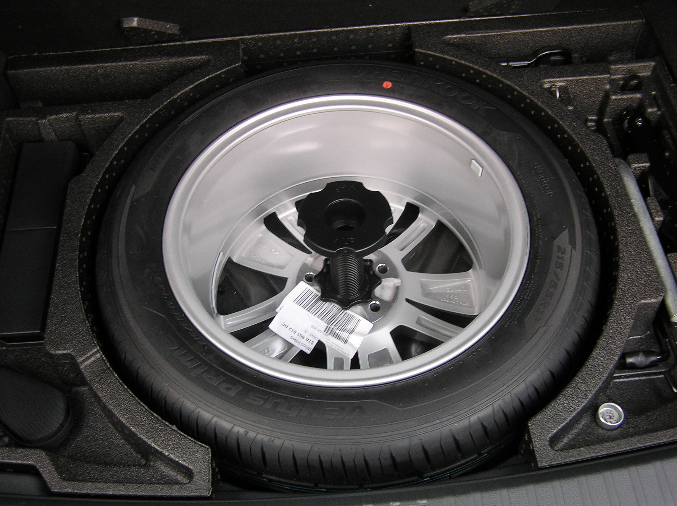

just picked our  my20 up and dealer quote for the lot  is £260.00
For my Karoq SE the full size 17" alloy spare + tools etc was factory fitted for £250 in December 2018, it raises the floor level to give a drop of a couple of inches.
