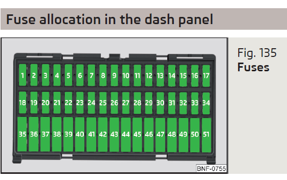

I've searched the internet far and wide for the correct fuse and there is nothing. The only thing I can find is fuses for the model before my car which says fuse 4 and 22. These won't be for mine as the lay out is different and fuse 4 is for the airbag. There is nothing in the manual that specifically days drl.
The handbook says numerous fuses for vehicle lighting so I can only think of replacing them all?
I have rang skoda customer services who just told me to take it in to a local retailer. I rang my local retailer who want £85 to put it on a diagnostic machine first. Needless to say I dont have that kind of cash!
This is what my manual says
  1.  Air Conditioning, diagnostic connector
  2.  Headlight range control, park assist, electric exterior mirror adjustment
  3.  Automatic transmission, engine control unit, power steering, control lever under the steering wheel, instrument cluster
  4.  Airbag
  5.  Reversing light
  6.  Rear wiper, windscreen washer system
  7.  Main beam headlamp - left side
  8.  Main beam headlamp - right side
  9.  Not assigned
  10.  Electric exterior mirror heater
  11.  Not assigned
  12.  Vehicle lighting
  13.  Vehicle lighting
  14.  Vehicle lighting
  15.  Vehicle with START-STOPsystem: Radio  -  Vehicle without START-STOPsystem: Central Control Unit, heating, automatic transmission, light switch, license plate light
  16.  Vehicle lighting
  17.  Rear window wiper
  18.  Panoramic sunroof
  19.  Central locking system
  20.  Rear window heater
  21.  Reversing light
  22.  Horn
  23.  Voltage transformer
  24.  Headlamp flasher
  25.  Windscreen wipers
  26.  Radio
  27.  Turn signal lights, brake lights
  28.  Selector lever for the automatic transmission
  29.  Fuel pump
  30.  Engine control unit, instrument cluster, central control unit, rain sensor, control lever under the steering wheel, diagnostic connector
  31.  Vehicle lighting
  32.  Central control unit
  33.  Vehicle lighting
  34.  Indoor lighting
  35.  Vehicle lighting
  36.  Vehicle lighting
  37.  ESC
  38.  Key bar
  39.  Lever under the steering wheel, windscreen washer system
  40.  Engine components
  41.  Brake pedal switch, cooling fan
  42.  Engine control unit
  43.  Fuel pump
  44.  Engine components
  45.  Engine components
  46.  12-volt power socket
  47.  Air blower for air conditioning/heating
  48.  Seat heaters
  49.  Electric power windows
  50.  Vehicle lighting
  51.  Electric power windows
If car fuses are blown, they are almost always clearly visibly blown if you look at them - they are mostly made of transparent colour-coded plastic, although some smaller sized ones may not be. Point is pulling fuses and checking does not normally need an ohmmeter. I would say fuses are blamed a bit too often for electrical problems. I'm not sure from your post whether you are saying your bulbs just keep blowing or not.
I suspect the problem is not a fuse, but may be a corroded build socket or a bad earth connection (maybe an earth strap from battery to chassis or a corroded connection). I admit this would not be common on a newish car though. It was however a common issue with the last type of vehicle I owned, and with many cars with towing electrics fitted (won't have this on a Citigo though!)
