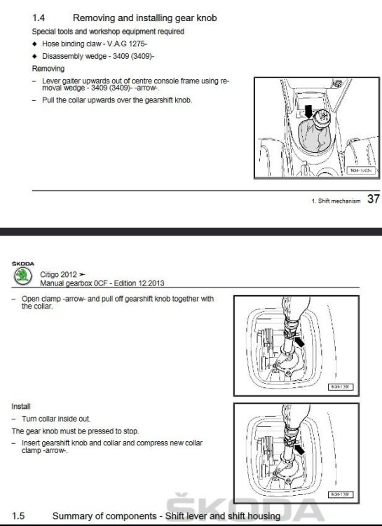

I am assuming it is one of the two cables, but unsure even how to remove the gear knob and surround on my Citigo to have a look at that end.  Not sure if there are oiling/greese points for the cable?

Get someone to waggle the gear lever, while you try to look at where the cables terminate on top of the gearbox. It could be an obstruction or a problem with one of the cables. If nothing obvious, you'll have to pop the cables off the yoke (I will post a pic of this if you want to take it on).
Then take a look at the shift mechanism:
Thanks for the feedback on the problem, I will get the Mrs to move the stick and have a check, I will also try and follow the guide to remove the gear cover and check all appears OK, no loose pins etc.

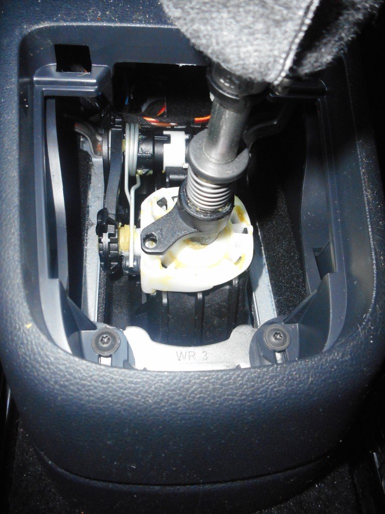

Any grease at hand is fine for the parts in the pic....
