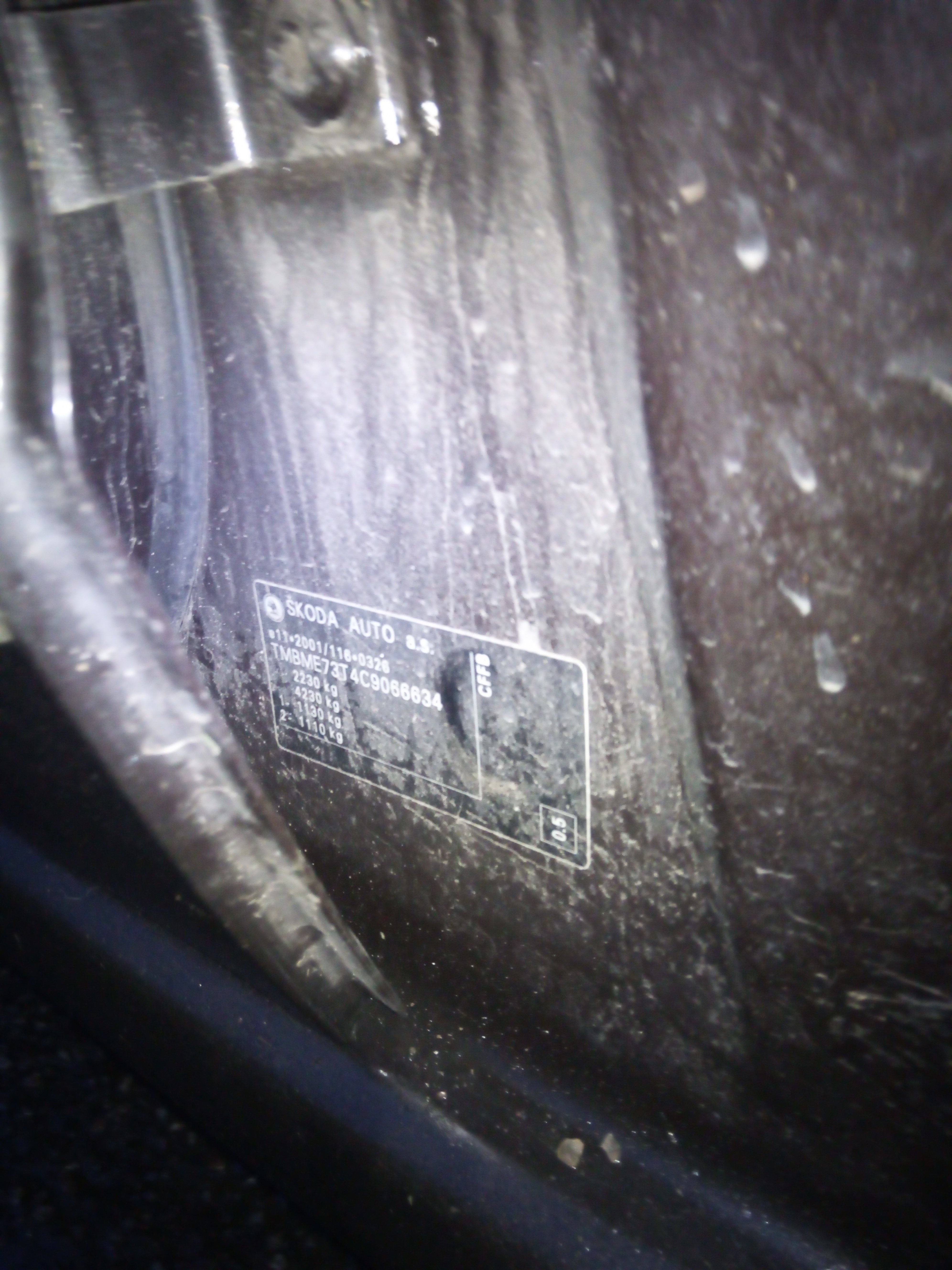

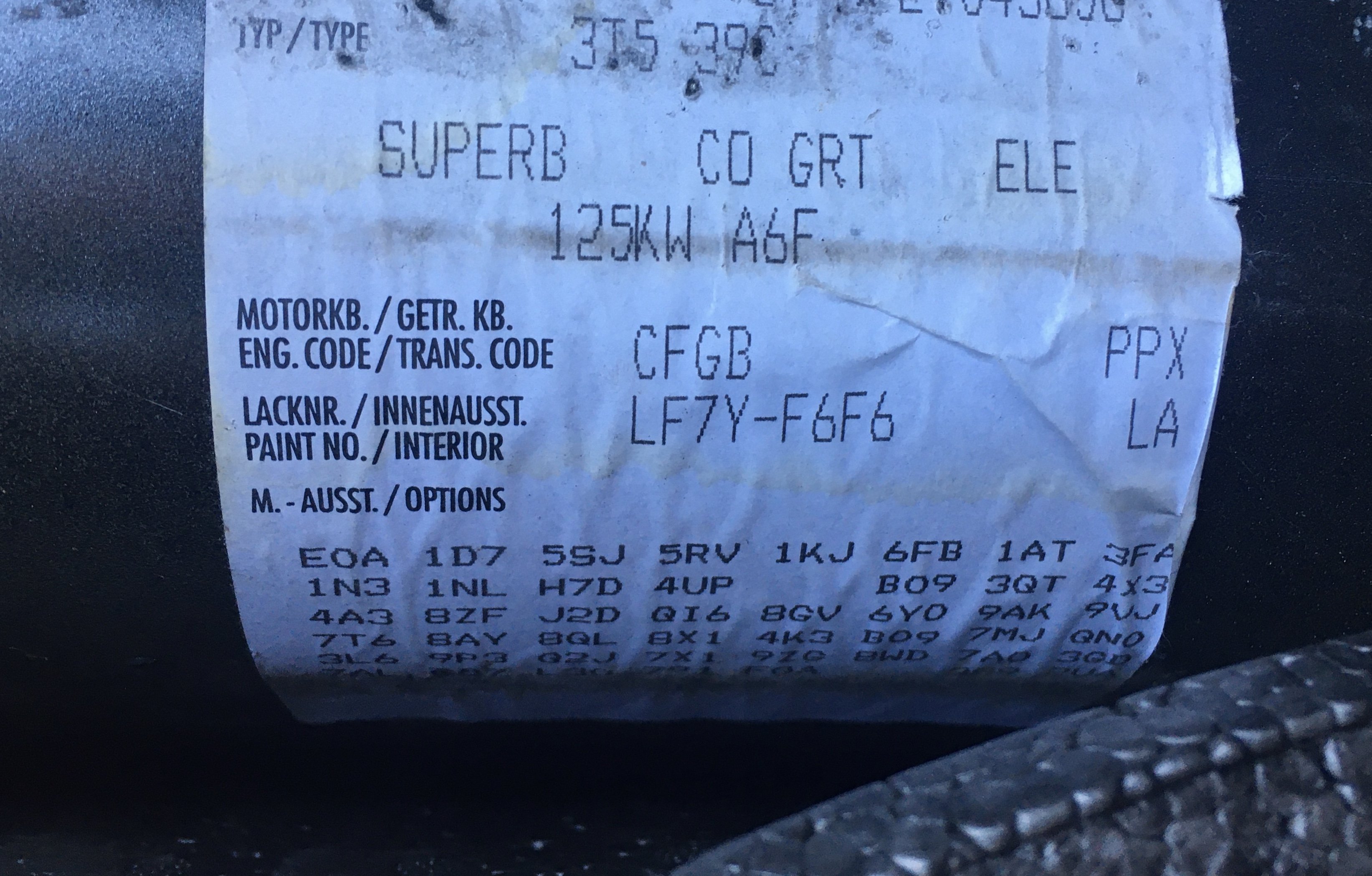

Engine code is always very useful when trying to identify parts suited to that engine. This is a three or four-letter alphabetic code that will be on your build data sticker in the boot, usually under carpet near spare wheel well.  Also sometimes there's a copy of the sticker in the service book.
Its also on the driverside door pillar on a sticker
Will post a pic whereabouts tomorrow

I’m guessing it’s CFGB
  • Sponsor
Yep, that's it. Engine thermostat is item 21 here: https://skoda.7zap.com/en/cz/superb/sup/2014-768/1/121-121007/   03L 121 111AE by the looks of it.

Also for engine number its at the bottom of the B pillar tucked away behind the front of the rear door
the engine number is written on the right handside of sticker sideways
