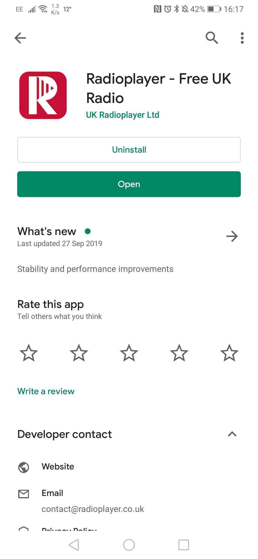

There's an android app called "Radio Player" has lots of different channels and I use it to listen to Magic :D
Screenshot_20191102_161758_com.android.vending.thumb.jpg.f5edcc3cac73df95803da08e943dc1a5.jpg
*What's good with this app, is if you favourite your stations, you can use the buttons on the cars own radio to switch between your favourite stations
*This only works as far as I know with the Bluetooth (PID unit)
