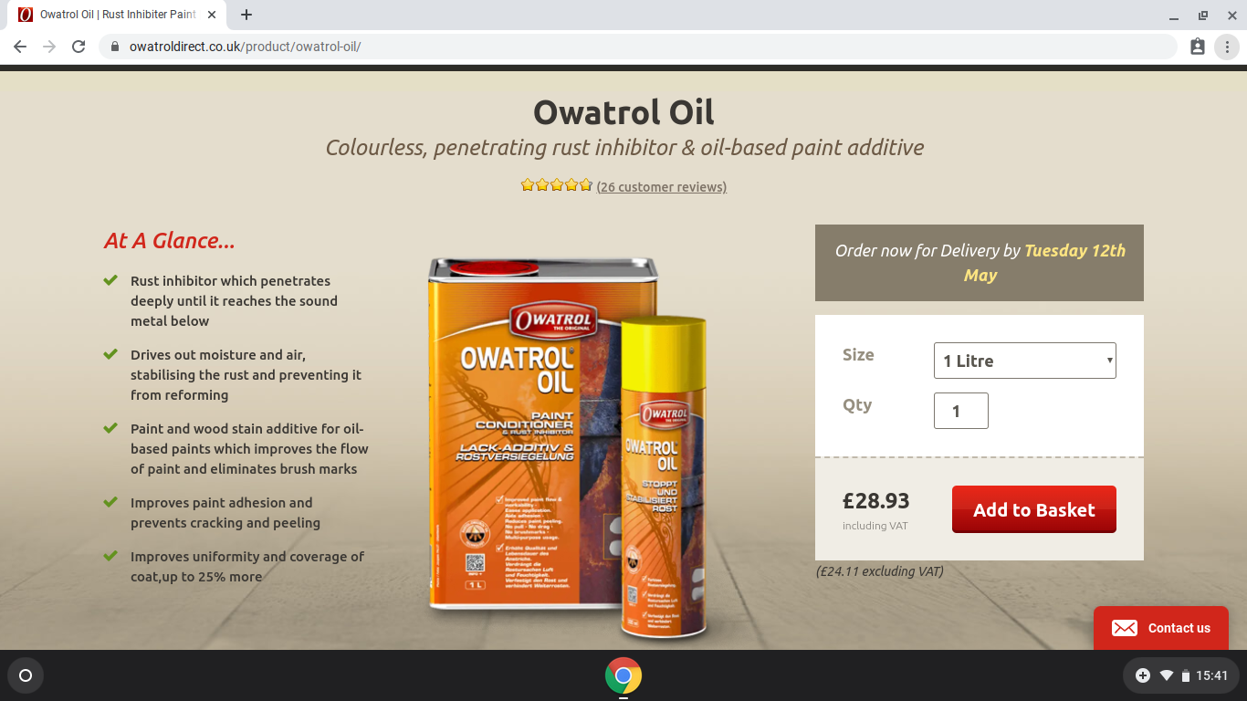

I used to restore cars and until a couple of years ago I'd never heard of Owatrol oil. I've found waxoyl etc was fine to a point but always seems to eventually wash off suspension/ axle parts (if I was restoring this is not what I would have used anyway). A Landrover nut friend introduced me to this stuff (it's fab on rear axles etc) and it's been fabulous - Obviously you need to get rid of dust/dirt but then it's easy to apply (spray or brush) and it seems to survive the elements being thrown at it really well. As with anything always worth keeping an eye on.
As an example I applied to the sump of my my wife's Panda that was rusting badly - two years on it still seems good. It set's clearish so you can see if there are still problems - in a way that you couldn't with underseal etc until it was too late. For stuff like suspension parts exposed to the elements this stuff is great - don't use underseal!
It's not cheap but worth trying a smaller size to give it a go and see what you think.

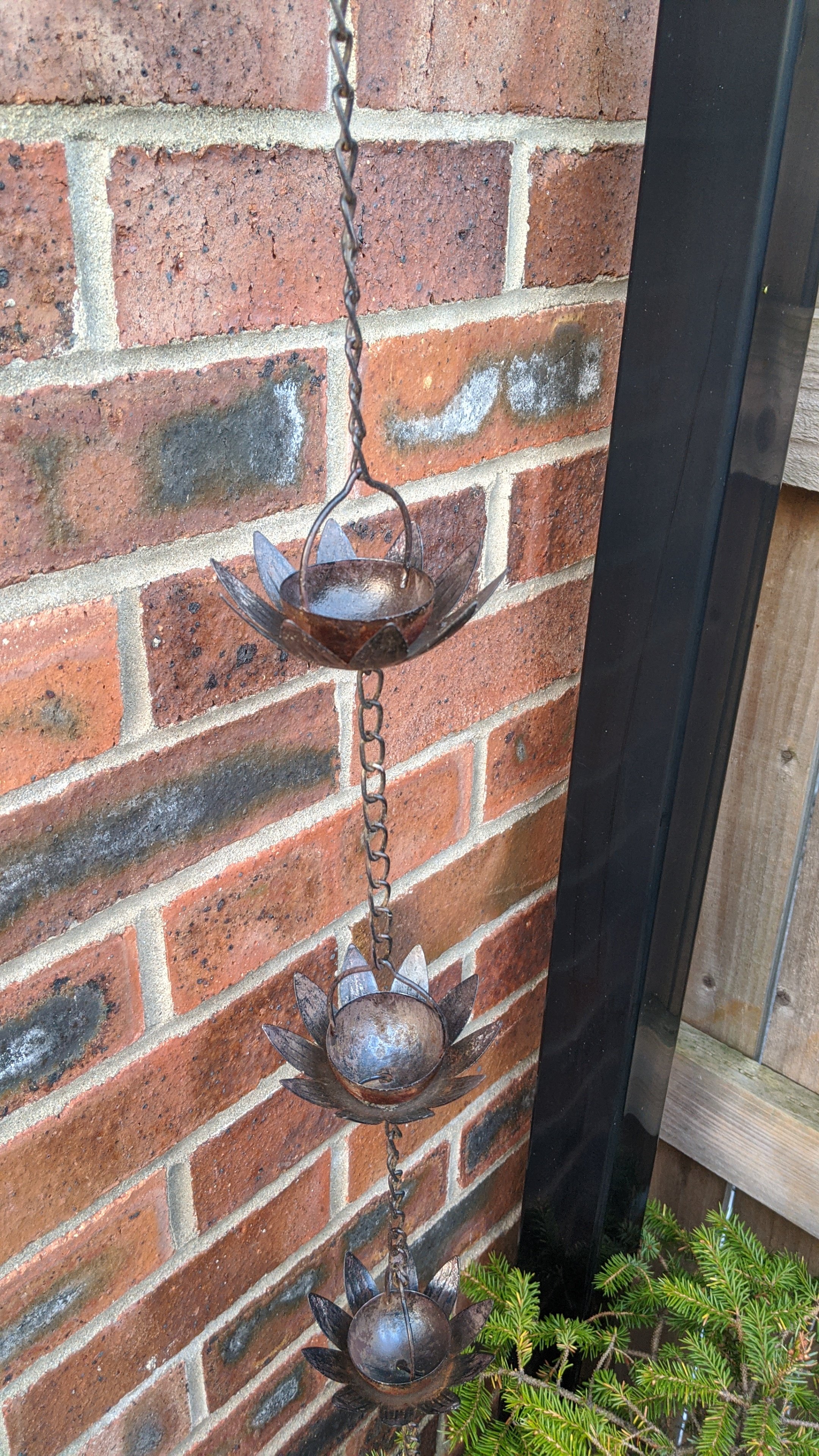

PS I also used on an outside garden "thing" that my wife got as a present which started rusting from day one and looked awful very quickly. A wipe over with this stuff and many years later still looking OK. This was just a wipe over with the stuff using kitchen roll - If you look at the top one this gives you an idea of how it sets, it paints on looking like oil an kind of sets to a kind of satin varnish finish  - and stays that way.  I also now use with outside lights on my house that seem to be susceptible to rust.
