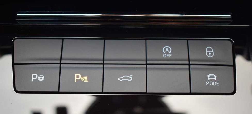

Are you sure? The current specification of the SE Technology suggests it is equipped with ESC (Electronic Stability Control) which includes traction control (ASR)...
On current UK car the traction control switch is no longer by the gearstick

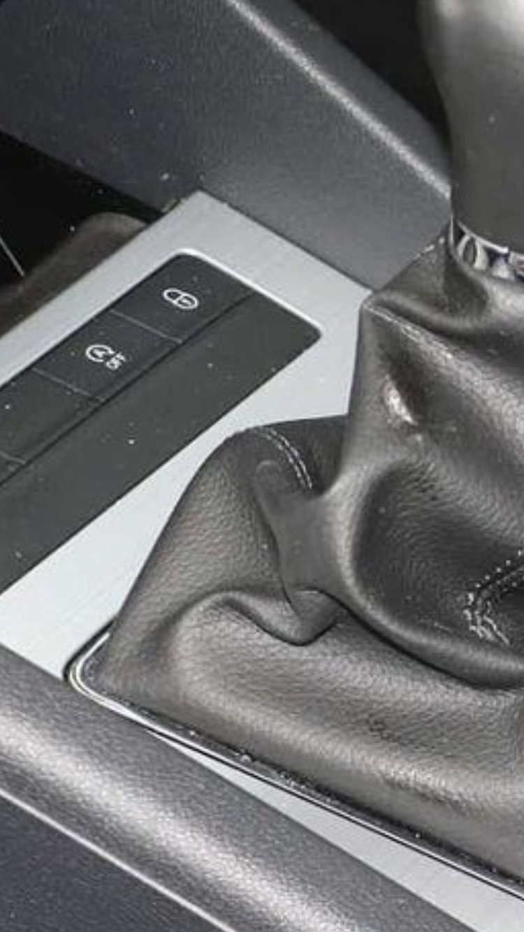

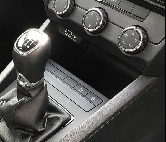

Photos of the inside of the car we're looking at would be the same as this. I've had a look through to see if there's a traction one as per the other icons and couldn't see anything.
There is some confusion here guys.
The OP is buying an SE, my response on the location of the ESC / ASR was to a more recent question on the SE Technology.
Two different models, and two different specifications.

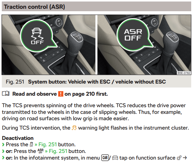

However, all the literature from Skoda suggests that all their UK variants of the MkIII Octavia are equipped with ESC, but as confirmed the button on the S and SE is absent...
This might simply suggest that it can't be turned off and on, it is default 'ON' at all times.
Even the higher spec SE L is missing the button and presumably means Skoda now don't allow the driver to adjust the effectiveness of the ESC...

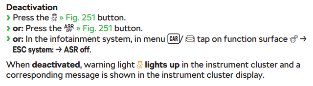

The exert from the manual in my previous post above mentioning the button was from the latest manual too (07/2019).

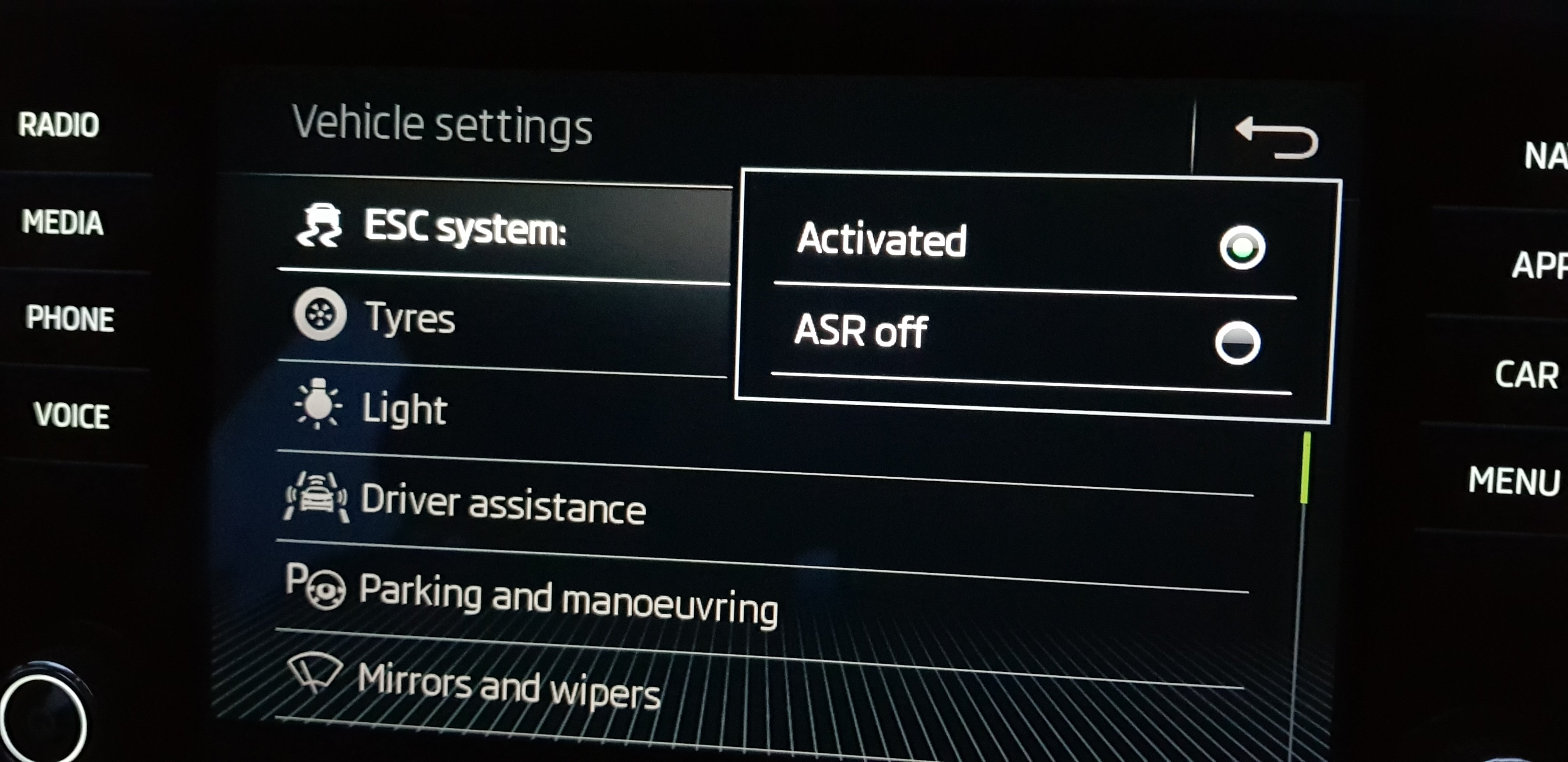

Perhaps someone could check to see if the option is available via the infotainment system instead, maybe Skoda simply omitted the button given that it is adjustable via the central screen and menu's instead...
Edited by silver1011
My 2015 Elegance doesn't have the ASR button, but the option to change the ESC setting (between ESC ON and ASR OFF) does appear in the infotainment system.
However, by changing the coding of byte 29 of the ABS from 02 to 09 I now have the same ESC options as the vRS (ESC ON, ASR OFF, ESC Sport) in the infotainment system.
